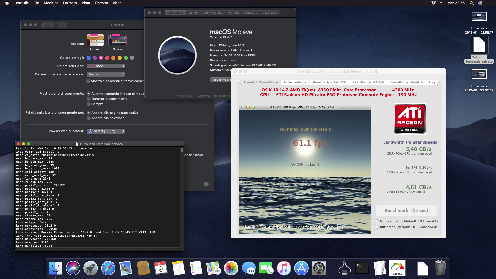

carlo_67 Posted January 9, 2019 Share Posted January 9, 2019 for me it's great, place my clover CLOVER.zip 2 Link to comment https://www.insanelymac.com/forum/topic/335877-amd-mojave-kernel-development-and-testing/page/8/#findComment-2658183 Share on other sites More sharing options...

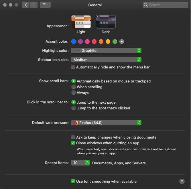

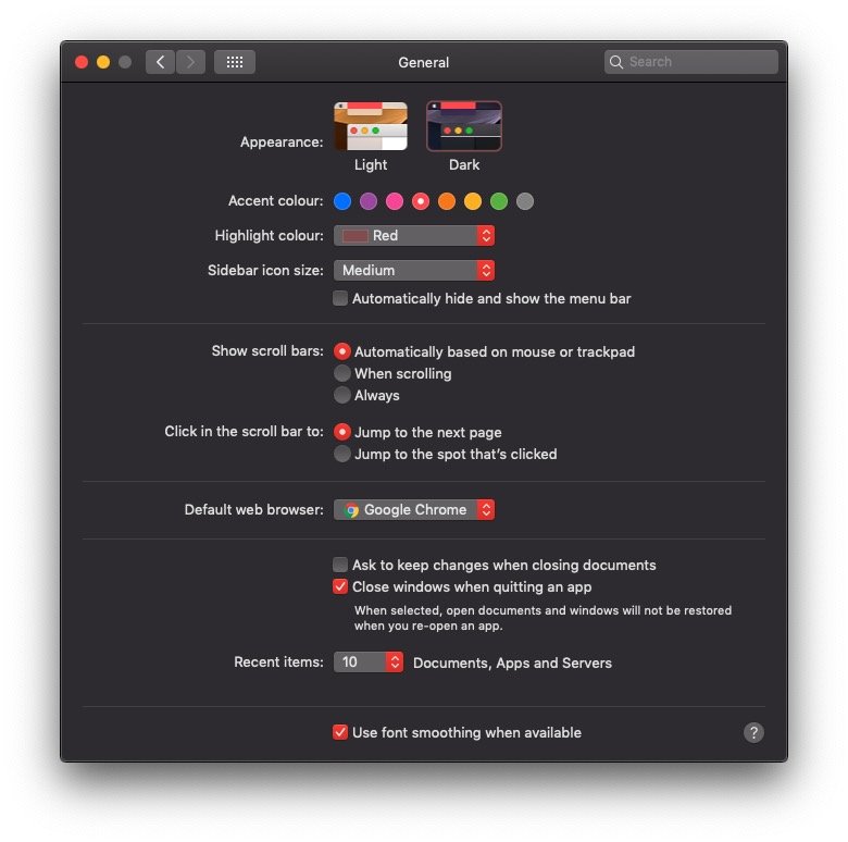

XLNC Posted January 9, 2019 Share Posted January 9, 2019 38 minutes ago, carlo_67 said: for me it's great, place my clover CLOVER.zip Your accent color for the window also didnt change to pink . So i guess its a FX issue : / Link to comment https://www.insanelymac.com/forum/topic/335877-amd-mojave-kernel-development-and-testing/page/8/#findComment-2658187 Share on other sites More sharing options...
jsl2000 Posted January 9, 2019 Share Posted January 9, 2019 1 hour ago, XLNC said: @jsl2000 can you change your accent color ( System Preferences -> General ) on your FX system . because on my FX system selecting a different accent color doesnt change the window color . same as this user : Reveal hidden contents I think it's the bug of Mojave O.S. or memory. I have tested with two different kernels/prelinkedkernels got the same result: 1. Basically it can correctly change the colors if selected from the left blue to the right grey by order. 2. But repeated or randomly changes it may resume previous color instead of current selection. Link to comment https://www.insanelymac.com/forum/topic/335877-amd-mojave-kernel-development-and-testing/page/8/#findComment-2658189 Share on other sites More sharing options...
XLNC Posted January 9, 2019 Share Posted January 9, 2019 (edited) 9 minutes ago, jsl2000 said: I think it's the bug of Mojave O.S. or memory. I have tested with two different kernels/prelinkedkernels got the same result: 1. Basically it can correctly change the colors if selected from the left blue to the right grey by order. 2. But repeated or randomly changes it may resume previous color instead of current selection. Yes but the window color should change like this : But it doesnt . Only the highlight color gets changed but not the background window color on FX. Edited January 9, 2019 by XLNC Link to comment https://www.insanelymac.com/forum/topic/335877-amd-mojave-kernel-development-and-testing/page/8/#findComment-2658191 Share on other sites More sharing options...

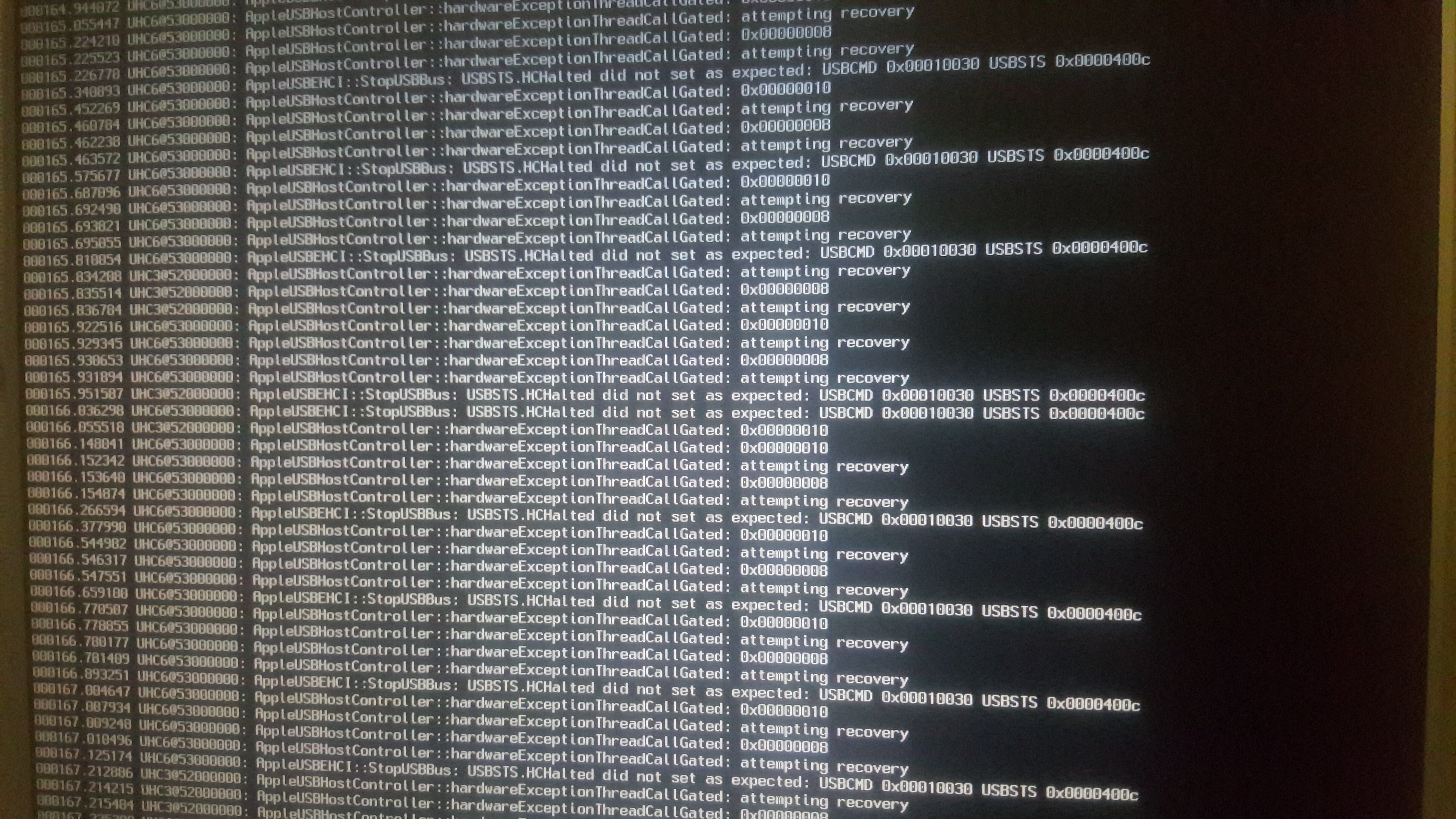

vintr Posted January 9, 2019 Share Posted January 9, 2019 3 hours ago, XLNC said: try this one .https://www.dropbox.com/s/usrhnr4apbagxpj/XLNC_prelinkedkernel.fx4.zip?dl=0 Nothing but KP Right before the KP it always drops something I believe to be related with the USB host controller. Tried to google it, but no luck. Dunno how to overcome this. Link to comment https://www.insanelymac.com/forum/topic/335877-amd-mojave-kernel-development-and-testing/page/8/#findComment-2658195 Share on other sites More sharing options...

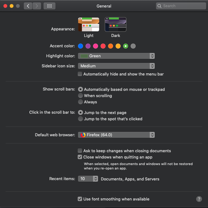

jsl2000 Posted January 9, 2019 Share Posted January 9, 2019 49 minutes ago, XLNC said: Yes but the window color should change like this : But it doesnt . Only the highlight color gets changed but not the background window color on FX. What I got when it's wrong was attached here: Link to comment https://www.insanelymac.com/forum/topic/335877-amd-mojave-kernel-development-and-testing/page/8/#findComment-2658198 Share on other sites More sharing options...

XLNC Posted January 10, 2019 Share Posted January 10, 2019 6 hours ago, vintr said: Nothing but KP Right before the KP it always drops something I believe to be related with the USB host controller. Tried to google it, but no luck. Dunno how to overcome this. Whats your system specs ? and the pk has usb kexts in so you should not get usb error spam. did you boot with kcsuffix=fx4 ? 4 hours ago, Datdude717 said: I just have a few questions since I've wiped my drive and prepped it for installation. After the reboot from pre-installing Mojave, besides replacing the PK and editing the plist, what other steps are needed to be done before rebooting to finish the installation? The step(s) that specifies to rebuild PK, kexts, etc. via installer doesn't work for me, as I am not sure when that step should be done (whether before attempting to boot to the desktop or after)? I've downloaded XLNC_v3, used the prelinkedkernel from that folder the replace the exisiting PK in the macOS Install Data folder of the drive. Should I do anything with the kernel and System.kext files BEFORE rebooting to complete the installation? I've attached my CLOVER folder to display the drivers/kext I currently have. Now, whether I'm missing anything or something is in the wrong place, I'm not 100% sure. My USB uses the same CLOVER files (kexts,drivers) as High Sierra, which installed successfully. Here's my specs: MSI B350M GAMING PRO Ryzen 5-1600 @ 3.7GHz 16GB DDR4 2666MHz GIGABYTE Radeon RX 560 4GB CLOVER.zip After initial install replace pk and edit the plist then proceed for second stage installation from clover menu and when its done reboot to usb again open terminal copy the kernel and kext to installed mojave then fix permissions and rebuild caches finally boot to that macos volume from clover menu of your usb . Link to comment https://www.insanelymac.com/forum/topic/335877-amd-mojave-kernel-development-and-testing/page/8/#findComment-2658218 Share on other sites More sharing options...
vintr Posted January 10, 2019 Share Posted January 10, 2019 (edited) 14 minutes ago, XLNC said: Whats your system specs ? and the pk has usb kexts in so you should not get usb error spam. did you boot with kcsuffix=fx4 ? My system specs are in my signature, should I add more info about RAM, HDDs, etc? Actually, I did boot with -v npci=0x3000 debug=0x100 keepsyms=1 kcsuffix=fx4. For some reason even with this kernel I still get USB error. UPD: apparently, my signature doesn't show up, I'll deal with that a little later. My specs are: ASUS M5A78L-M LX3 FX 4300, 8 GB DDR3 GTX 760 2 GB macOS High Sierra 10.13.1 // Windows 10 Edited January 10, 2019 by vintr Link to comment https://www.insanelymac.com/forum/topic/335877-amd-mojave-kernel-development-and-testing/page/8/#findComment-2658219 Share on other sites More sharing options...
jsl2000 Posted January 10, 2019 Share Posted January 10, 2019 (edited) On 1/10/2019 at 2:36 PM, vintr said: My system specs are in my signature, should I add more info about RAM, HDDs, etc? Actually, I did boot with -v npci=0x3000 debug=0x100 keepsyms=1 kcsuffix=fx4. For some reason even with this kernel I still get USB error. UPD: apparently, my signature doesn't show up, I'll deal with that a little later. My specs are: ASUS M5A78L-M LX3 FX 4300, 8 GB DDR3 GTX 760 2 GB macOS High Sierra 10.13.1 // Windows 10 According to my experience up to now Shaneee's prelinkedkernel.test & XLNC's prelinkedkernel.v3, prelinkedkernel.xlnc, prelinkedkernel.fx4 can login desktop at 10.14.1 in my FX-6300 hackintosh. You may try other kernels/prelinkedkernels, but I guess all will get KP before login to desktop. [Edit] 1. Install LZVN decompressor tool at /usr/local/bin/lzvn I can extract kernel and kexts from different prelinkedkernels. 2. Repeated testing again found that after rebuild prelinkedkernel with kernel.v3 or kernel.xlnc will work in FX-6300 hackintosh too ! Edited January 11, 2019 by jsl2000 Link to comment https://www.insanelymac.com/forum/topic/335877-amd-mojave-kernel-development-and-testing/page/8/#findComment-2658224 Share on other sites More sharing options...
vintr Posted January 10, 2019 Share Posted January 10, 2019 (edited) 16 minutes ago, jsl2000 said: You may try other kernels/prelinkedkernels, but I guess all will get KP before login to desktop. You're right, I've tried all PKs, but no matter which one of them I'm using, I always get KP. Edited January 10, 2019 by vintr Link to comment https://www.insanelymac.com/forum/topic/335877-amd-mojave-kernel-development-and-testing/page/8/#findComment-2658228 Share on other sites More sharing options...
