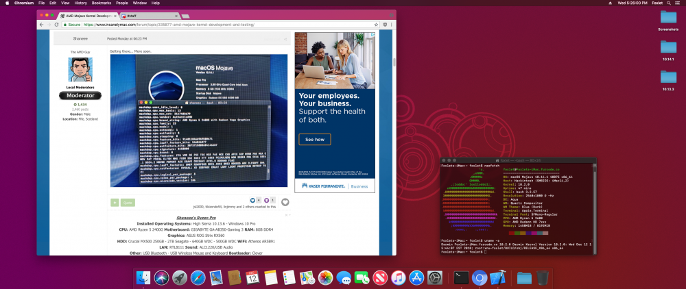

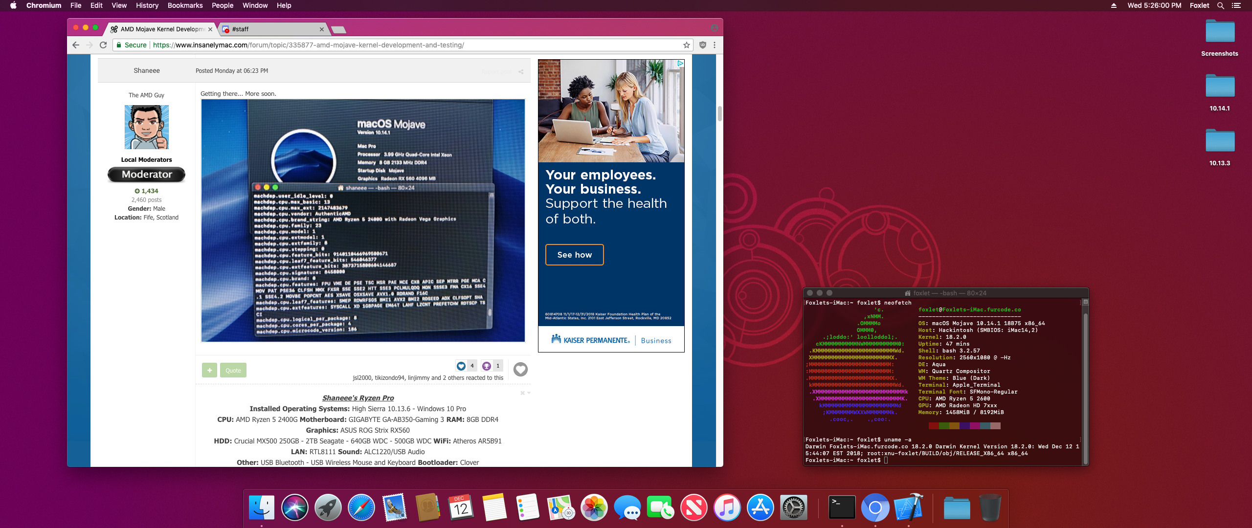

Gigamaxx Posted December 12, 2018 Share Posted December 12, 2018 1 hour ago, Shaneee said: So Apple Services aren't working.. Hmmm Are they working for you? My test is with a clone of an Intel System drive. Link to comment https://www.insanelymac.com/forum/topic/335877-amd-mojave-kernel-development-and-testing/page/2/#findComment-2653448 Share on other sites More sharing options...
Shaneee Posted December 12, 2018 Author Share Posted December 12, 2018 2 hours ago, Gigamaxx said: Are they working for you? My test is with a clone of an Intel System drive. No, anything Apple that requires internet doesn't work. Chrome is working though for web browsing. 1 Link to comment https://www.insanelymac.com/forum/topic/335877-amd-mojave-kernel-development-and-testing/page/2/#findComment-2653477 Share on other sites More sharing options...
Gigamaxx Posted December 12, 2018 Share Posted December 12, 2018 1 hour ago, Shaneee said: No, anything Apple that requires internet doesn't work. Chrome is working though for web browsing. So it’s not just me. What about the System kext, I know the others had certain Kexts eliminated? Link to comment https://www.insanelymac.com/forum/topic/335877-amd-mojave-kernel-development-and-testing/page/2/#findComment-2653491 Share on other sites More sharing options...

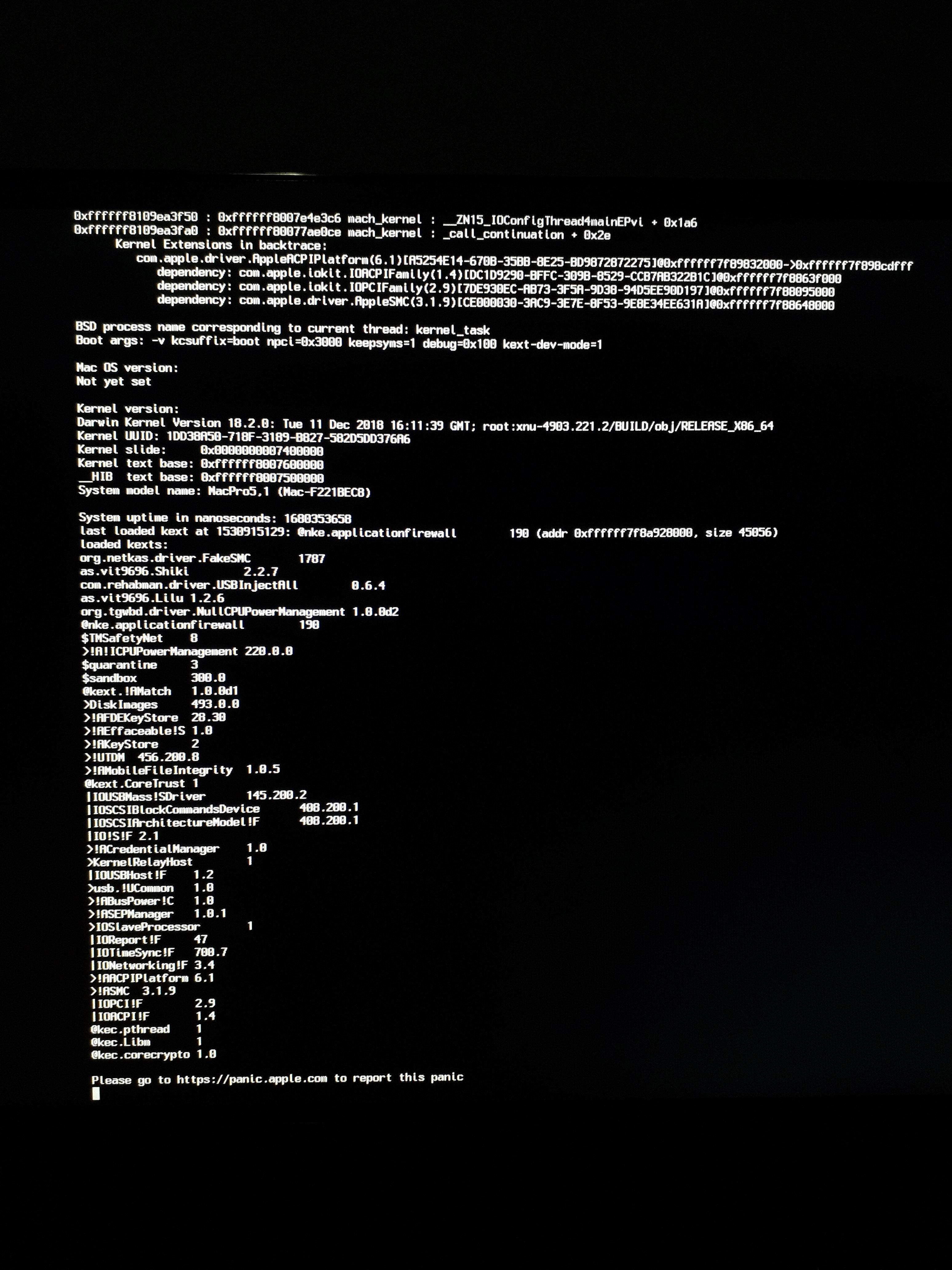

gudelgado_ Posted December 12, 2018 Share Posted December 12, 2018 (edited) Well, I tried to up the system with penboot with Shanee's PrelinkedKernel, but I got those results, it looks like error a Power Management (ACPI), what do you think @Shaneee ? Replace IONetworkingFamily.kext by foxlet and I used Mojave AMD Beta kernel by Shanee. My Setup. Installed Operating Systems: High Sierra 10.13.3 - Windows 10 Pro - Yosemite 10.10CPU: AMD FX-6300 4Ghz Motherboard: M5A78L-M LX/BR RAM: 8GB DDR3 Graphics: XFX HD 7770 1GBHDD: 1TB Seagate - 2x 500GB Seagate - 80GB LAN: RTL8111 Sound: ALC888BOther: USB Wireless Mouse and Keyboard Bootloader: Clover - Legacy Edited December 12, 2018 by gudelgado_ Link to comment https://www.insanelymac.com/forum/topic/335877-amd-mojave-kernel-development-and-testing/page/2/#findComment-2653500 Share on other sites More sharing options...

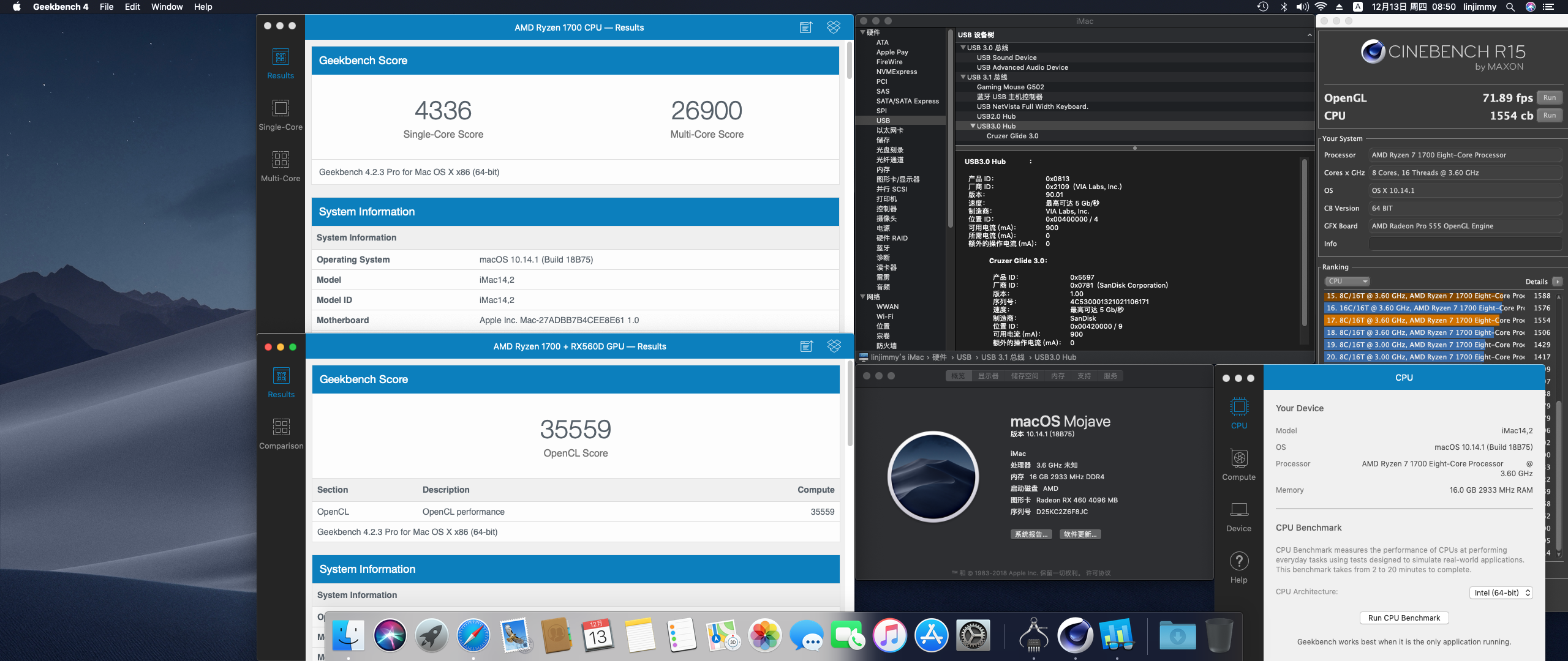

linjimmy Posted December 13, 2018 Share Posted December 13, 2018 Thank you Shaneee's kernel The installation was successful 10.14.1 Mojave AMD Ryzen 1700 AMD RX 560D Link to comment https://www.insanelymac.com/forum/topic/335877-amd-mojave-kernel-development-and-testing/page/2/#findComment-2653520 Share on other sites More sharing options...
Gigamaxx Posted December 13, 2018 Share Posted December 13, 2018 7 hours ago, gudelgado_ said: Well, I tried to up the system with penboot with Shanee's PrelinkedKernel, but I got those results, it looks like error a Power Management (ACPI), what do you think @Shaneee ? Replace IONetworkingFamily.kext by foxlet and I used Mojave AMD Beta kernel by Shanee. My Setup. Installed Operating Systems: High Sierra 10.13.3 - Windows 10 Pro - Yosemite 10.10CPU: AMD FX-6300 4Ghz Motherboard: M5A78L-M LX/BR RAM: 8GB DDR3 Graphics: XFX HD 7770 1GBHDD: 1TB Seagate - 2x 500GB Seagate - 80GB LAN: RTL8111 Sound: ALC888BOther: USB Wireless Mouse and Keyboard Bootloader: Clover - Legacy A couple of possible issues. XFX video cards of that vintage may have incompatible vbios. Have you used that card on a different Hackintosh? Do you have a different video card to test with? Or did you reflash the bios to another brand? Another issue may be Legacy clover build can be hard to get working in Mojave, UEFI boot is much easier. Unless you have had it working in the past with intel it may be better to go with Clover UEFI. Mojave now requires APFS mode which favors UEFI. 1 Link to comment https://www.insanelymac.com/forum/topic/335877-amd-mojave-kernel-development-and-testing/page/2/#findComment-2653529 Share on other sites More sharing options...

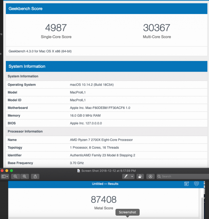

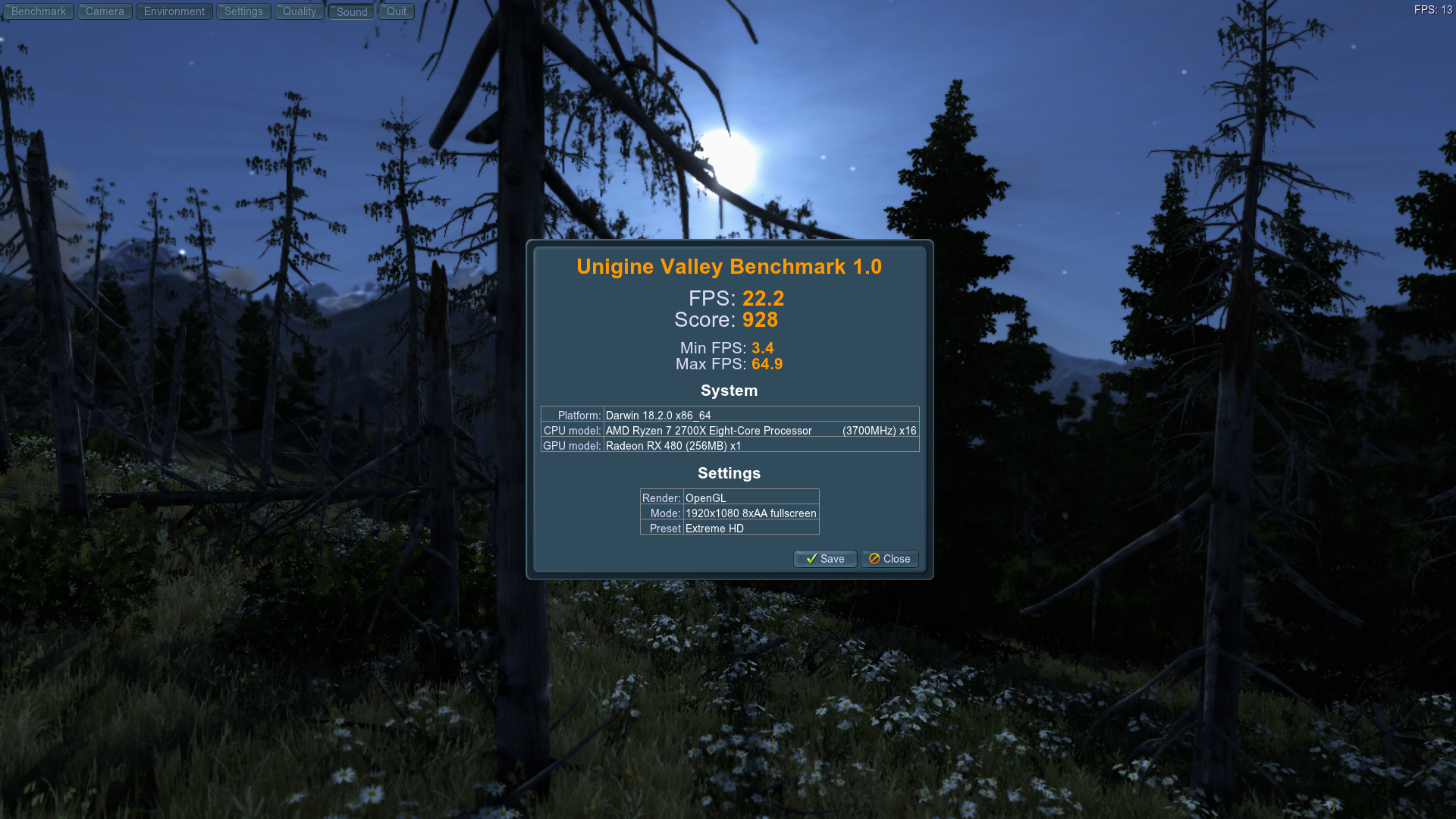

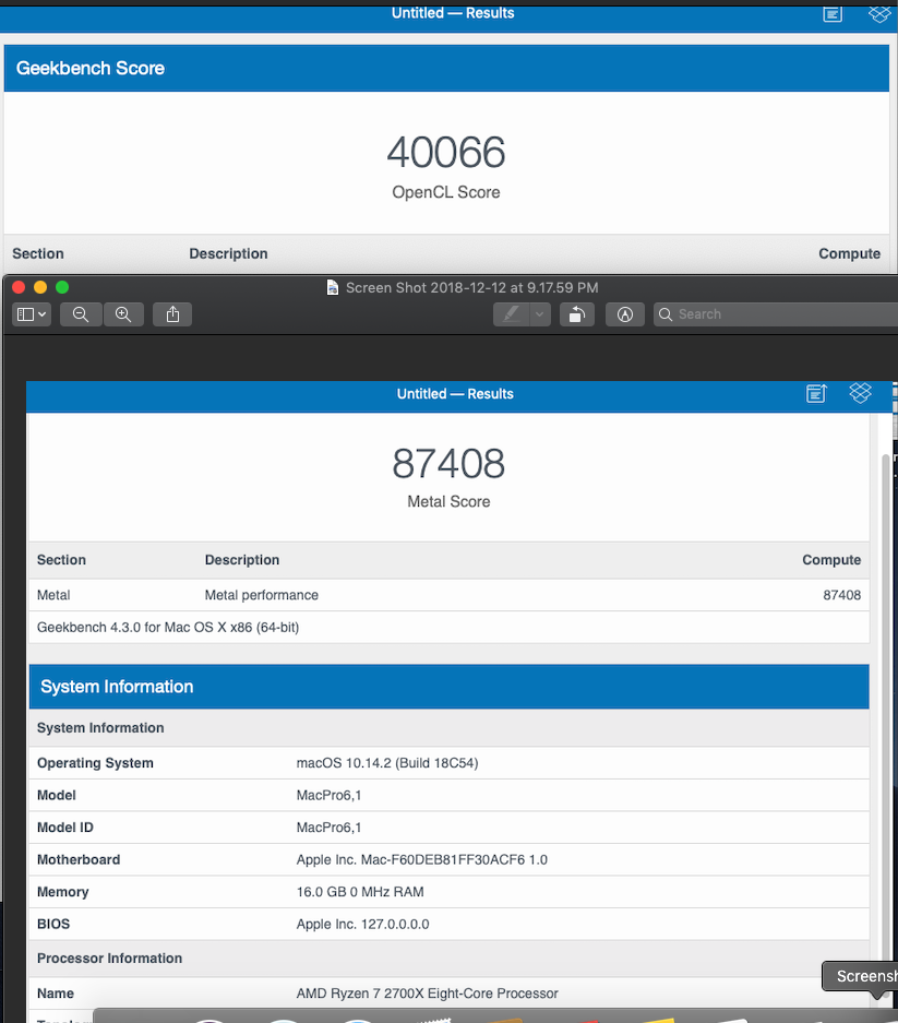

Gigamaxx Posted December 13, 2018 Share Posted December 13, 2018 Tested with Ryzen 7 2700X Geekbench CPU score is good. @Shaneee Terminal output attached. Graphics notes: Open CL is about half of what it should be and Open GL as well. Check out the Geekbench OpenCl vs Metal score for the sapphire R7 265. Open Gl score with RX 480 in Uningine Valley is half of what it should be. Terminal Saved Output Ryzen 7 2700X 1 Link to comment https://www.insanelymac.com/forum/topic/335877-amd-mojave-kernel-development-and-testing/page/2/#findComment-2653660 Share on other sites More sharing options...

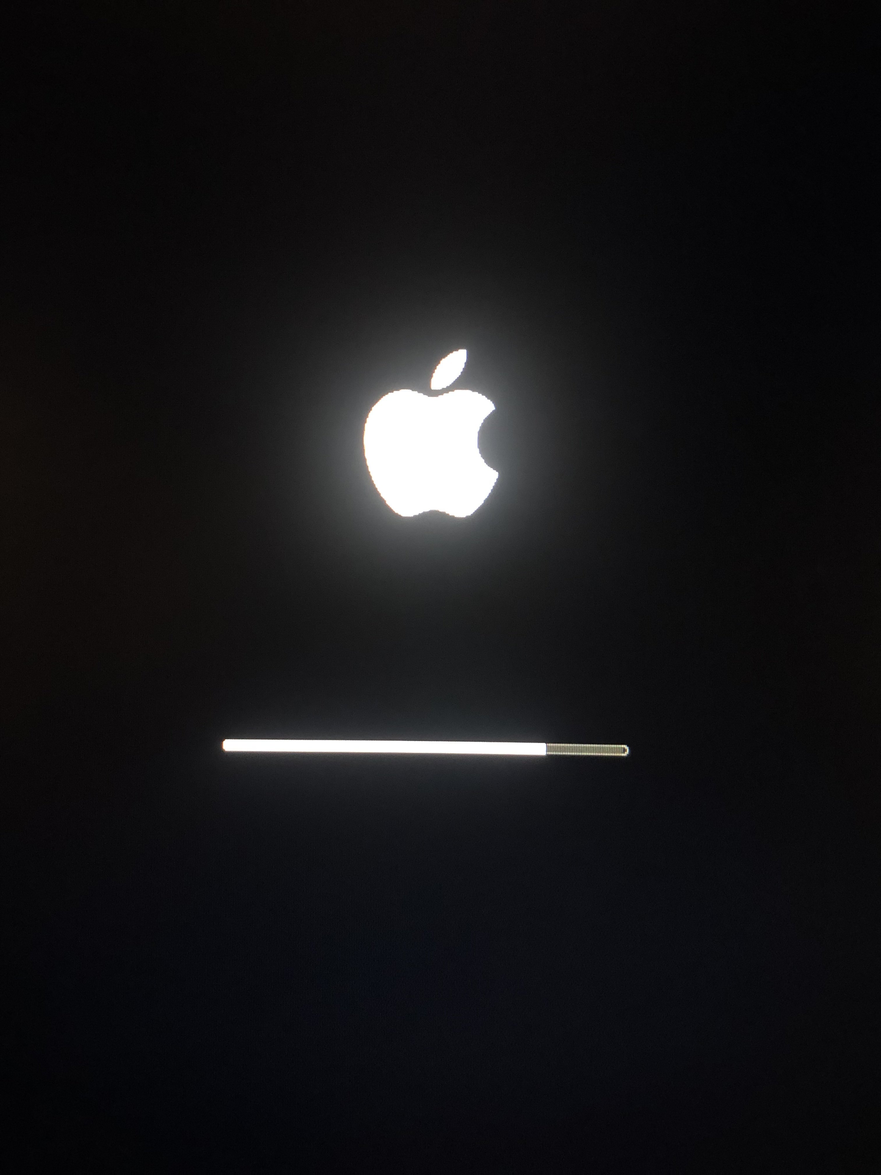

pixelkid94 Posted December 14, 2018 Share Posted December 14, 2018 (edited) 1 hour ago, Gigamaxx said: 14.2 works for me, rename prelinkedkernel remove the bits and period... Trying that now... After restoring 14.2 to USB and using OsxAptio2 it left me at ++++++++++++ Prelinkedkernel(removed .bits) is in /S/L/Prelinkedkernels now but there is no /S/L/Kernels... is the kernel for AFTER the install? update: booting with prelinkedkernel gives me this error ”couldn’t allocate runtime area” update:switched to aptiomemfix. Now it boots through verbose until applecpumanagement line then vomits for a second then reboots Edited December 14, 2018 by pixelkid94 Link to comment https://www.insanelymac.com/forum/topic/335877-amd-mojave-kernel-development-and-testing/page/2/#findComment-2653680 Share on other sites More sharing options...

Gigamaxx Posted December 14, 2018 Share Posted December 14, 2018 24 minutes ago, pixelkid94 said: Trying that now... After restoring 14.2 to USB and using OsxAptio2 it left me at ++++++++++++ Prelinkedkernel(removed .bits) is in /S/L/Prelinkedkernels now but there is no /S/L/Kernels... is the kernel for AFTER the install? update: booting with prelinkedkernel gives me this error ”couldn’t allocate runtime area” update:switched to aptiomemfix. Now it boots through verbose until applecpumanagement line then vomits for a second then reboots Try nullcpumanagementkext in clover/Kexts/Other folder where the FakeSMCkext should be. Link to comment https://www.insanelymac.com/forum/topic/335877-amd-mojave-kernel-development-and-testing/page/2/#findComment-2653686 Share on other sites More sharing options...
pixelkid94 Posted December 14, 2018 Share Posted December 14, 2018 5 minutes ago, Gigamaxx said: Try nullcpumanagementkext in clover/Kexts/Other folder where the FakeSMCkext should be. I forgot about fakesmc -facepalm- Link to comment https://www.insanelymac.com/forum/topic/335877-amd-mojave-kernel-development-and-testing/page/2/#findComment-2653689 Share on other sites More sharing options...
pixelkid94 Posted December 14, 2018 Share Posted December 14, 2018 11 minutes ago, Gigamaxx said: Try nullcpumanagementkext in clover/Kexts/Other folder where the FakeSMCkext should be. With fakesmc it got through verbose mode gave me grey background and cursor then went to loading bar with black ground and got to point in picture then rebooted. Link to comment https://www.insanelymac.com/forum/topic/335877-amd-mojave-kernel-development-and-testing/page/2/#findComment-2653691 Share on other sites More sharing options...

jsl2000 Posted December 18, 2018 Share Posted December 18, 2018 On 12/13/2018 at 6:13 AM, gudelgado_ said: Well, I tried to up the system with penboot with Shanee's PrelinkedKernel, but I got those results, it looks like error a Power Management (ACPI), what do you think @Shaneee ? Replace IONetworkingFamily.kext by foxlet and I used Mojave AMD Beta kernel by Shanee. My Setup. Installed Operating Systems: High Sierra 10.13.3 - Windows 10 Pro - Yosemite 10.10CPU: AMD FX-6300 4Ghz Motherboard: M5A78L-M LX/BR RAM: 8GB DDR3 Graphics: XFX HD 7770 1GBHDD: 1TB Seagate - 2x 500GB Seagate - 80GB LAN: RTL8111 Sound: ALC888BOther: USB Wireless Mouse and Keyboard Bootloader: Clover - Legacy I got the same error as yours in my FX-6300 hackintosh too. Both legacy Clover and Enoch booting got the same KP due to AppleACPIPlatform(6.1) error which should be caused by incompatible kernel instead of bootloader or GPU/CPU. Link to comment https://www.insanelymac.com/forum/topic/335877-amd-mojave-kernel-development-and-testing/page/2/#findComment-2654314 Share on other sites More sharing options...
XLNC Posted December 19, 2018 Share Posted December 19, 2018 On 12/18/2018 at 8:43 AM, jsl2000 said: I got the same error as yours in my FX-6300 hackintosh too. Both legacy Clover and Enoch booting got the same KP due to AppleACPIPlatform(6.1) error which should be caused by incompatible kernel instead of bootloader or GPU/CPU. try this kernel and prelinkedkernel.https://www.dropbox.com/s/87740zzdrmxkp9c/XLNC_fx.zip?dl=0 2 Link to comment https://www.insanelymac.com/forum/topic/335877-amd-mojave-kernel-development-and-testing/page/2/#findComment-2654490 Share on other sites More sharing options...
