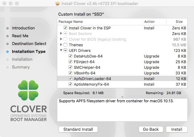

Yes it is set to AHCI. I am using clover Clover_v2.4k_r4722 and bilbo's stuff package for high sierra,
so i took ApfsDriverLoader-64.efi from there.
Edited by Vinsik
3 hours ago, Vinsik said:
Hi, Thanks for your answer.

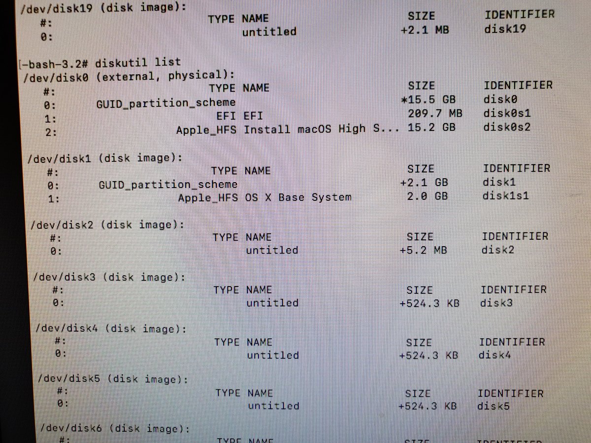

Please fire up a terminal, write the following:
diskutil list
and post the output here.
diskutil list
It shows the same as DiskUtility, only USB stick and EFI virtual drive. (also a lot of small disk images (loop mounts)).
Ill try to format usb stick, install clover and configure config.plist again, maybe that will help.
Seems silly that im the only one stuck at disk detection problem :)
UPDATE: tried to rebuild USB stick. no success. still no visible drives. I guess its the newest bios firmware then...
Edited by Vinsik
1 hour ago, jack.avenger said:
Please check that you are using gray SATA connector.
Ok ill try. Was this mentioned in previous bilbos posts. I didnt notice this before.
Edited by Vinsik
Hi, Thanks this helped.
