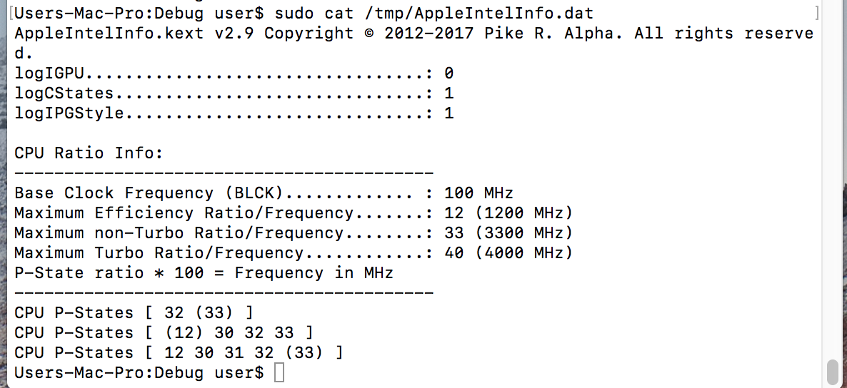

bilbo Posted October 15, 2018 Author Share Posted October 15, 2018 Try this. Replace your current SSDT-1. About PM, I assume that you followed all steps of my guide. First , check that you don't have KP Second , check your PM. Just repeat the steps with AppleintelInfo and check the output. If you don't have PM, maybe you have to repeat the of SSDT creation with ssdtprgen. I think that you did it , but pay special attention with the tip of drag ssdt-1 and epic.aml to desktop, renaming (this new and patched) ssdt-1 to dsdt.aml and add the argument -mode custom to ssdtprgen script. SSDT nanim test v2.zip Link to comment https://www.insanelymac.com/forum/topic/335860-guide-2018-z820-high-sierra-the-great-guide-sucess/page/2/#findComment-2641008 Share on other sites More sharing options...

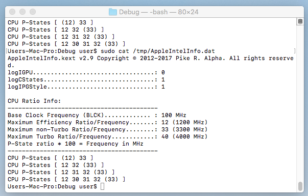

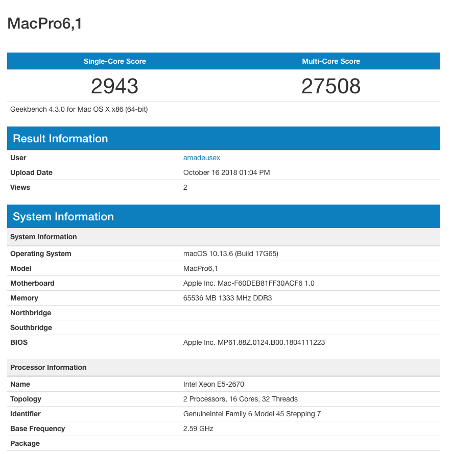

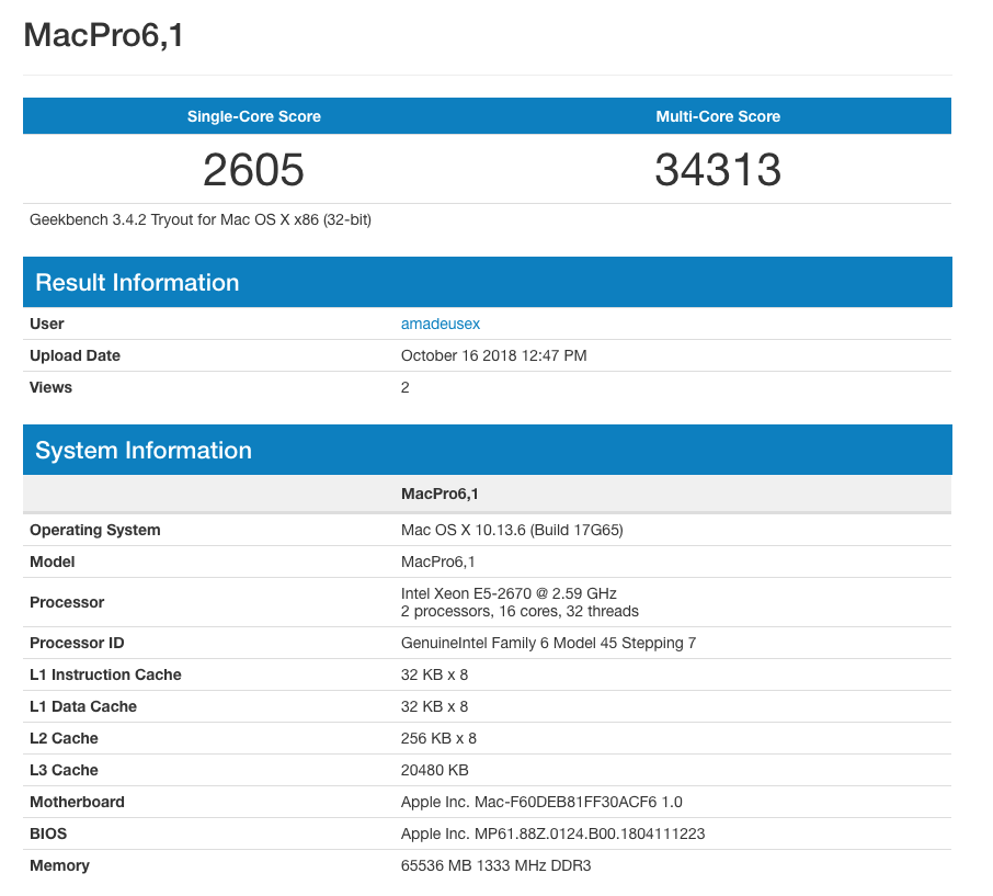

amadeusex Posted October 16, 2018 Share Posted October 16, 2018 Got some good news Guys PM now fully working here with a Sandy Bridge Dual setup (2xE5 2670 v1). Geekbench 3 score (32-bit) is around 35000 and Cpu speed step is working from 1.2 up to 3.3 GHz. What did the trick was ./ssdtPRGen.sh -cpus 2 -p 'E5-2670' -x 1 -target 0 -turbo 3300 -c 3 -mode custom Whatever else i've tried didn't work (I tried a lot ). My EFI folder for High Sierra z820v1 Dual E5 2670v1 Link to comment https://www.insanelymac.com/forum/topic/335860-guide-2018-z820-high-sierra-the-great-guide-sucess/page/2/#findComment-2641188 Share on other sites More sharing options...
nanim Posted October 16, 2018 Share Posted October 16, 2018 23 hours ago, bilbo said: Try this. Replace your current SSDT-1. About PM, I assume that you followed all steps of my guide. First , check that you don't have KP Second , check your PM. Just repeat the steps with AppleintelInfo and check the output. If you don't have PM, maybe you have to repeat the of SSDT creation with ssdtprgen. I think that you did it , but pay special attention with the tip of drag ssdt-1 and epic.aml to desktop, renaming (this new and patched) ssdt-1 to dsdt.aml and add the argument -mode custom to ssdtprgen script. SSDT nanim test v2.zip hi Bilbo I followed your Post (Part V: Power Management) 1. install Hwsensors. 2. Fix AppleIntelInfo.kext 3. sudo perl AICPMPatch.pl /System/Library/Extensions/AppleIntelCPUPowerManagement.kext /Contents/MacOS/AppleIntelCPUPowerManagement --patch 4. cp Legacyx86PlattformPlugin.kext /S/L/E 5. uncheck Asus AICPUMP (AppleIntelCPUPM) on clover 6. reboot 7. curl -o ~/Library/ssdtPRGen.zip https://codeload.github.com/Piker-Alpha/ssdtPRGen.sh/zip/Beta 8. chmod +x ssdtPRGen.sh 9. copy your ssdt-1(v2) to desktop and rename DSDT.aml 10. APIC.aml in origin, copy desktop 11. ./ssdtPRGen.sh -mode custom -b Mac-F60DEB81FF30ACF6 -p 'E5-2667 v2' -c 3 x 1 -cpus 2 -l 36 12. enable on clover "-xcpm" 13. reboot 14. sudo kextload AppleIntelinfo.kext 15. sudo cat /tmp/AppleIntelInfo.dat Link to comment https://www.insanelymac.com/forum/topic/335860-guide-2018-z820-high-sierra-the-great-guide-sucess/page/2/#findComment-2641213 Share on other sites More sharing options...
jack.avenger Posted October 16, 2018 Share Posted October 16, 2018 2 hours ago, amadeusex said: Got some good news Guys PM now fully working here with a Sandy Bridge Dual setup (2xE5 2670 v1). Geekbench 3 score (32-bit) is around 35000 and Cpu speed step is working from 1.2 up to 3.3 GHz. Hi, amadeusex. Can you show Cinebench R15 results? Link to comment https://www.insanelymac.com/forum/topic/335860-guide-2018-z820-high-sierra-the-great-guide-sucess/page/2/#findComment-2641219 Share on other sites More sharing options...

bilbo Posted October 16, 2018 Author Share Posted October 16, 2018 (edited) 2 hours ago, nanim said: hi Bilbo I followed your Post (Part V: Power Management) 1. install Hwsensors. 2. Fix AppleIntelInfo.kext . . . . perfect, you only forget copy the ssdt-1 v2 file to your efi folder, in /acpi/patched/ replacing the current ssd-1 (v1). This ssdt-1 is not only to generate the ssdt with pike script. For you, is mandatory keep it in the EFI folder. First version allowed boot (and install) in High Sierra. This version , if I'm not wrong, should allow you get a right PM. When you report the result, I'll extend the guide with a more elaborated explanation. Edited October 16, 2018 by bilbo Link to comment https://www.insanelymac.com/forum/topic/335860-guide-2018-z820-high-sierra-the-great-guide-sucess/page/2/#findComment-2641237 Share on other sites More sharing options...
bilbo Posted October 16, 2018 Author Share Posted October 16, 2018 4 hours ago, amadeusex said: Got some good news Guys PM now fully working here with a Sandy Bridge Dual setup (2xE5 2670 v1). Geekbench 3 score (32-bit) is around 35000 and Cpu speed step is working from 1.2 up to 3.3 GHz. What did the trick was ./ssdtPRGen.sh -cpus 2 -p 'E5-2670' -x 1 -target 0 -turbo 3300 -c 3 -mode custom Whatever else i've tried didn't work (I tried a lot ). My EFI folder for High Sierra z820v1 Dual E5 2670v1 Glad to heard that!!! Did you read my answer? I've seen your new ssdt and now it's right. I think that trick was to generate pike's ssdt loading the new ssdt-1. The ssdt that you were trying was obsolete. Link to comment https://www.insanelymac.com/forum/topic/335860-guide-2018-z820-high-sierra-the-great-guide-sucess/page/2/#findComment-2641245 Share on other sites More sharing options...

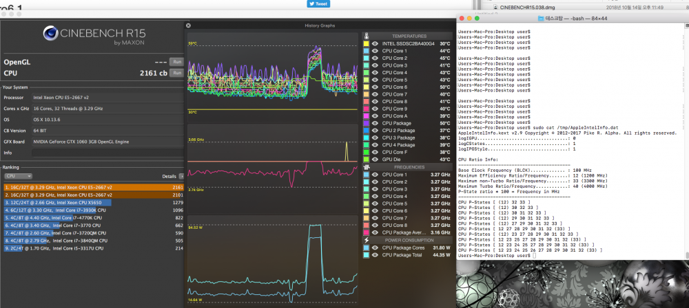

nanim Posted October 17, 2018 Share Posted October 17, 2018 8 hours ago, bilbo said: perfect, you only forget copy the ssdt-1 v2 file to your efi folder, in /acpi/patched/ replacing the current ssd-1 (v1). This ssdt-1 is not only to generate the ssdt with pike script. For you, is mandatory keep it in the EFI folder. First version allowed boot (and install) in High Sierra. This version , if I'm not wrong, should allow you get a right PM. When you report the result, I'll extend the guide with a more elaborated explanation. I copy ssdt-1(v2) ==> pached directory could you watch test7.png? Link to comment https://www.insanelymac.com/forum/topic/335860-guide-2018-z820-high-sierra-the-great-guide-sucess/page/2/#findComment-2641333 Share on other sites More sharing options...

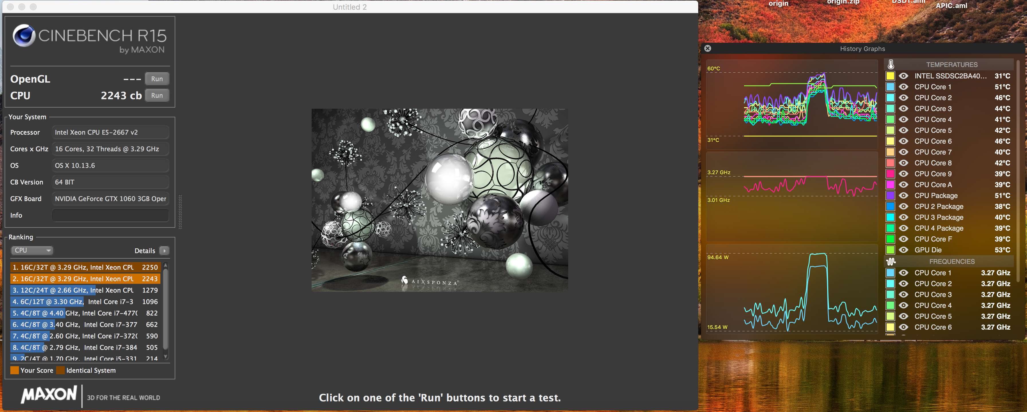

bilbo Posted October 17, 2018 Author Share Posted October 17, 2018 Well, it seems , it's all right ... . Don´t forget disable AppleIntelInfo.kext typing "sudo kextunload AppleIntelinfo.kext" after your tests. I assume that you can see differents freqs in your regular use... from 12 to 33 with some higher peaks... right? You can do more extensive test with geekbench (check my folder) to see more detailed graphs. Btw, HWSensors always shows info in single-cpu mode. But you have 2 cpus working, of course. That's a great news for the owners of the 26x7 users. This has been always the main issue reported for the users of z820. I'll add the info to the guide (and the right credits). Link to comment https://www.insanelymac.com/forum/topic/335860-guide-2018-z820-high-sierra-the-great-guide-sucess/page/2/#findComment-2641370 Share on other sites More sharing options...

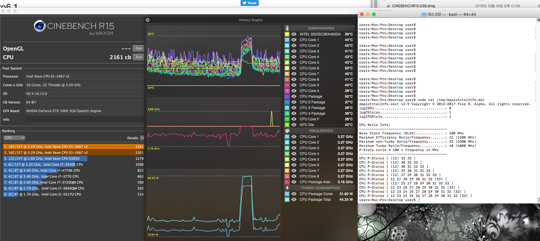

nanim Posted October 17, 2018 Share Posted October 17, 2018 5 hours ago, bilbo said: Well, it seems , it's all right ... . Don´t forget disable AppleIntelInfo.kext typing "sudo kextunload AppleIntelinfo.kext" after your tests. I assume that you can see differents freqs in your regular use... from 12 to 33 with some higher peaks... right? You can do more extensive test with geekbench (check my folder) to see more detailed graphs. Btw, HWSensors always shows info in single-cpu mode. But you have 2 cpus working, of course. That's a great news for the owners of the 26x7 users. This has been always the main issue reported for the users of z820. I'll add the info to the guide (and the right credits). yes i watched peaks my p-states 22~33 (E5 2667 v2 : 12 ~40) not found C-states.... and your geekbench broken... cant start geekbench app how can i fix it? Link to comment https://www.insanelymac.com/forum/topic/335860-guide-2018-z820-high-sierra-the-great-guide-sucess/page/2/#findComment-2641414 Share on other sites More sharing options...

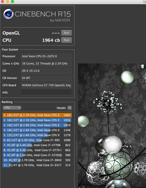

jack.avenger Posted October 17, 2018 Share Posted October 17, 2018 18 hours ago, amadeusex said: Sure my friend - Im cloning the High Sierra Installation to an SSD right now. If i remember correctly it was a score around 1900-2000 but i'll rerun it and post a screenshot. Geekbench 3 32 bit was 35000 (ish) and Geekbench 4 64 was around 28000 In Cinebench R15 I have ~1980 on my Z820. But Geekbench 3 (32 bit) shows only ~33800. Have tried with yours SSDT file on my Z820, results are the same. I think my low Geekbench result related to NUMA. My DDR3 modules are mixed 1333MHz / 1600MHz with different timings. Link to comment https://www.insanelymac.com/forum/topic/335860-guide-2018-z820-high-sierra-the-great-guide-sucess/page/2/#findComment-2641417 Share on other sites More sharing options...
amadeusex Posted October 17, 2018 Share Posted October 17, 2018 2 hours ago, jack.avenger said: In Cinebench R15 I have ~1980 on my Z820. But Geekbench 3 (32 bit) shows only ~33800. Have tried with yours SSDT file on my Z820, results are the same. I think my low Geekbench result related to NUMA. My DDR3 modules are mixed 1333MHz / 1600MHz with different timings. They're close enough my friend, and Yes the mixed Ram may be the culprit but no one gives a f... about benchmarks Link to comment https://www.insanelymac.com/forum/topic/335860-guide-2018-z820-high-sierra-the-great-guide-sucess/page/2/#findComment-2641433 Share on other sites More sharing options...
amadeusex Posted October 17, 2018 Share Posted October 17, 2018 3 hours ago, nanim said: and your geekbench broken... cant start geekbench app how can i fix it? Download it Link to comment https://www.insanelymac.com/forum/topic/335860-guide-2018-z820-high-sierra-the-great-guide-sucess/page/2/#findComment-2641439 Share on other sites More sharing options...
bilbo Posted October 17, 2018 Author Share Posted October 17, 2018 32000 vs 35000 is not too much in geekbench 3. And yes, It could be because of memory modules, indeed. Your whole ram will work so fast like the slower module. 1333 vs 1600 can give you the difference, but , anyway, it´s a slight difference. Link to comment https://www.insanelymac.com/forum/topic/335860-guide-2018-z820-high-sierra-the-great-guide-sucess/page/2/#findComment-2641455 Share on other sites More sharing options...
