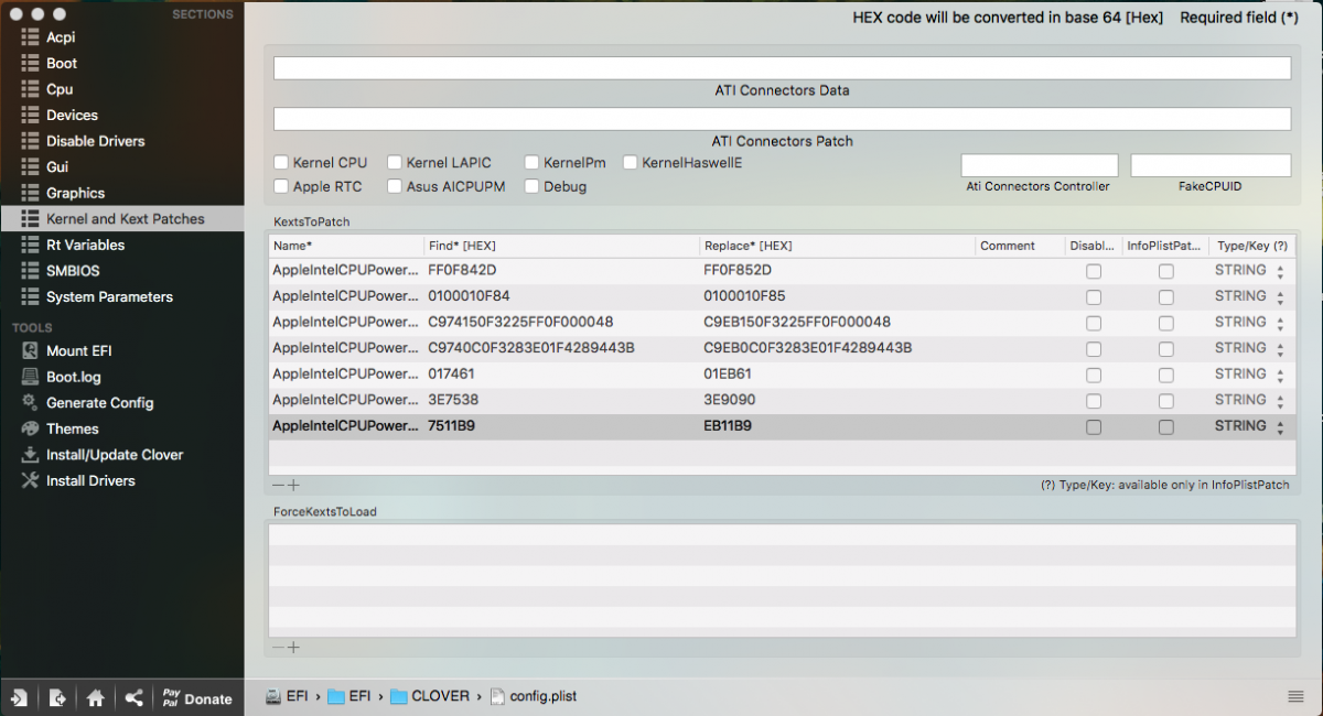

Using clover configurator is easier. Your clover configurator have to see like this.

sudo ./ssdtPRGen.sh  -f 4120 -turbo 4500
ssdtPRGen.sh v0.9 Copyright © 2011-2012 by † RevoGirl
             v6.6 Copyright © 2013 by † Jeroen
             v15.6 Copyright © 2013-2016 by Pike R. Alpha
Bugs > https://github.com/Piker-Alpha/ssdtPRGen.sh/issues <
gDataPath: /Users/christian/Library/ssdtPRGen/Data
Override value: (-f) clock frequency, now using: 4120 MHz!
Override value: (-turbo) maximum (turbo) frequency, now using: 4500 MHz!
System information: Mac OS X 10.12.1 (16B2657)
Brandstring 'Intel® Core i7-3960X CPU @ 3.30GHz'
Warning: No ACPI Processor declarations found in the DSDT!
Using assumed Scope (\_SB) {}
Generating ssdt.dsl for a 'MacPro5,1' with board-id [Mac-F221BEC8]
Sandy Bridge Core i7-3960X processor [0x206D6] setup [0x0402]
With a maximum TDP of 130 Watt, as specified by Intel
Number logical CPU's: 12 (Core Frequency: 4120 MHz)
Number of Turbo States: 3 (4220-4500 MHz)
Number of P-States: 34 (1200-4500 MHz)
Injected C-States for P000 (C1,C3,C6,C7)
Warning: 'cpu-type' may be set improperly (0x0402 instead of 0x0602)
Error: board-id [Mac-F221BEC8] not supported by Sandy Bridge – check SMBIOS data / use the -c option
Do you want to continue (y/n)? y
Warning: 'system-type' may be set improperly (1 instead of 2)
Intel ACPI Component Architecture
ASL Optimizing Compiler version 20140926-64 [Nov  6 2014]
Copyright © 2000 - 2014 Intel Corporation
ASL Input:     /Users/christian/Library/ssdtPRGen/ssdt.dsl - 280 lines, 8373 bytes, 64 keywords
AML Output:    /Users/christian/Library/ssdtPRGen/ssdt.aml - 2137 bytes, 27 named objects, 37 executable opcodes
Compilation complete. 0 Errors, 0 Warnings, 0 Remarks, 0 Optimizations
Do you want to copy /Users/christian/Library/ssdtPRGen/ssdt.aml to /Extra/ssdt.aml? (y/n)? n
Do you want to open ssdt.dsl (y/n)? n
I did try changing it to iMac12,2 and the board-id specified by ssdtPRGen.sh, and redid the SSDT and after that it wouldn't boot, until I changed it back to MacPro5.1 in Clover.
If I look at my setting I am permanently running at 4.12 & my AppleIntelInfo.kext shows no C and only 1 P states
AppleIntelInfo.kext v1.2 Copyright © 2012-2015 Pike R. Alpha. All rights reserved
Settings:
logMSRs............................: 1
logIGPU............................: 0
logIntelRegs.......................: 1
logCStates.........................: 1
logIPGStyle........................: 1
InitialTSC.........................: 0x66b753c6973
MWAIT C-States.....................: 135456
Model Specific Regiters
MSR_CORE_THREAD_COUNT......(0x35)  : 0x6000C
MSR_PLATFORM_INFO..........(0xCE)  : 0xC0070012100
MSR_PMG_CST_CONFIG_CONTROL.(0xE2)  : 0x1E008400
MSR_PMG_IO_CAPTURE_BASE....(0xE4)  : 0x20414
IA32_MPERF.................(0xE7)  : 0x662E6DACE86
IA32_APERF.................(0xE8)  : 0x6626240EE68
MSR_FLEX_RATIO.............(0x194) : 0xE2100
MSR_IA32_PERF_STATUS.......(0x198) : 0x25A100002100
MSR_IA32_PERF_CONTROL......(0x199) : 0x2100
IA32_CLOCK_MODULATION......(0x19A) : 0x0
IA32_THERM_STATUS..........(0x19C) : 0x881C0000
IA32_MISC_ENABLES..........(0x1A0) : 0x850089
MSR_MISC_PWR_MGMT..........(0x1AA) : 0x400000
MSR_TURBO_RATIO_LIMIT......(0x1AD) : 0x393939393939
IA32_ENERGY_PERF_BIAS......(0x1B0) : 0x0
MSR_POWER_CTL..............(0x1FC) : 0x2104005D
MSR_RAPL_POWER_UNIT........(0x606) : 0xA1003
MSR_PKG_POWER_LIMIT........(0x610) : 0x80069F4000149F40
MSR_PKG_ENERGY_STATUS......(0x611) : 0xB7C0A789
MSR_PKG_POWER_INFO.........(0x614) : 0x1A80410
MSR_PP0_CURRENT_CONFIG.....(0x601) : 0x80001FFF
MSR_PP0_POWER_LIMIT........(0x638) : 0x80000000
MSR_PP0_ENERGY_STATUS......(0x639) : 0x2DA82707
MSR_PP0_POLICY.............(0x63a) : 0x0
MSR_PKGC6_IRTL.............(0x60b) : 0x8868
MSR_PKGC7_IRTL.............(0x60c) : 0x886D
MSR_PKG_C2_RESIDENCY.......(0x60d) : 0x0
MSR_PKG_C3_RESIDENCY.......(0x3f8) : 0x0
MSR_PKG_C6_RESIDENCY.......(0x3f9) : 0x0
MSR_PKG_C7_RESIDENCY.......(0x3fa) : 0x0
IA32_TSC_DEADLINE..........(0x6E0) : 0x66B78319A2E
PCH device.................: 0x1D418086
CPU Ratio Info:
CPU Low Frequency Mode.............: 1200 MHz
CPU Maximum non-Turbo Frequency....: 3300 MHz
CPU Maximum Turbo Frequency........: 5700 MHz
CPU P-States [ (33) ]
Any help appreciated, thanks
You can not be use a MacPro5,1 definition because this guide was made to use a MacPro6,1 definition.
Thanks stinga, I have changed to MacPro6,1 - however it is still not working.
When I generated the SSDT.aml - I used the following
sudo ./ssdtPRGen.sh  -f 4125 -turbo 4500
Override value: (-f) clock frequency, now using: 4125 MHz!
Generating ssdt.dsl for a 'MacPro6,1' with board-id [Mac-F60DEB81FF30ACF6]
Number logical CPU's: 12 (Core Frequency: 4125 MHz)
Number of Turbo States: 3 (4225-4500 MHz)
Warning: 'cpu-type' may be set improperly (0x0402 instead of 0x0a02)
Error: board-id [Mac-F60DEB81FF30ACF6] not supported by Sandy Bridge – check SMBIOS data / use the -c option
Do I need to worry about the warnings & use any other parameters for the ssdtPRGen.sh ?
I've been using MP5,1 just fine on my X79 with your patches and a SSDT. I don't use the kext as it's designed for MP6,1. Speedstep is working as is Turbo.
ccozmo: type bdmesg into Terminal and have a look for MSR. Clover should patch it automatically if it detects that it's locked. It looks like we have the same board and mine doesn't have a locked MSR. Then check that all 7 patches to AppleIntelCPUPowerManagement are being applied.
I'm not overclocking my 3930k so I didn't use any custom parameters with ssdtPRGen. Just let it build a default SSDT for the CPU.
If you're still not getting any working speedstep, have a look at your CPU settings in the BIOS and see if anything there might be the cause.
Did you do anything special with your SSDT ? What parameters did you use ? Are you running Sierra ?
