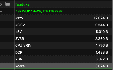

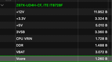

Andrey1970 Posted February 15, 2020 Share Posted February 15, 2020 (edited) 6 hours ago, Nuacho said: vcore 0,024v? maybe you were wrong? Give high loading on CPU, you have to see correct Vcore. CPU in idle time. CPU high loading. Edited February 15, 2020 by Andrey1970 Link to comment https://www.insanelymac.com/forum/topic/335292-virtualsmc-%E2%80%94-smc-emulator/page/29/#findComment-2708374 Share on other sites More sharing options...
DocXavier Posted February 15, 2020 Share Posted February 15, 2020 (edited) 1 hour ago, Andrey1970 said: Give high loading on CPU, you have to see correct Vcore. You are right. So, is 0.024 ok for idle? Edited February 15, 2020 by DocXavier Link to comment https://www.insanelymac.com/forum/topic/335292-virtualsmc-%E2%80%94-smc-emulator/page/29/#findComment-2708382 Share on other sites More sharing options...
Andrey1970 Posted February 15, 2020 Share Posted February 15, 2020 57 minutes ago, DocXavier said: You are right. So, is 0.024 ok for idle? Yes, it is strange, but any other IO-chip sensors from FakeSMC, too will show too small Vcore in idle. But you can always look Vcore here: Link to comment https://www.insanelymac.com/forum/topic/335292-virtualsmc-%E2%80%94-smc-emulator/page/29/#findComment-2708396 Share on other sites More sharing options...
vector sigma Posted February 15, 2020 Share Posted February 15, 2020 11 minutes ago, Andrey1970 said: Yes, it is strange, but any other IO-chip sensors from FakeSMC, too will show too small Vcore in idle. But you can always look Vcore here: VID instead of Vcore?? Link to comment https://www.insanelymac.com/forum/topic/335292-virtualsmc-%E2%80%94-smc-emulator/page/29/#findComment-2708404 Share on other sites More sharing options...
Andrey1970 Posted February 15, 2020 Share Posted February 15, 2020 10 minutes ago, vector sigma said: VID instead of Vcore?? I didn't understand. Explain, is slightly more detailed that you wanted to tell. Link to comment https://www.insanelymac.com/forum/topic/335292-virtualsmc-%E2%80%94-smc-emulator/page/29/#findComment-2708406 Share on other sites More sharing options...
vector sigma Posted February 15, 2020 Share Posted February 15, 2020 (edited) Vcore is the limit of the voltage the CPU can use while the VID is the voltage the CPU uses at any particular moment depending by its frequency range. The CPU communicate the VID to the VRM (Voltage Regulator Module) which send the correct Vcore to use. (large use of google ) VID --> VRM --> Vcore Basically VID is it a request, VRM allow or disallow and regulate the request, and Vcore is the final the CPU uses. Edited February 15, 2020 by vector sigma Link to comment https://www.insanelymac.com/forum/topic/335292-virtualsmc-%E2%80%94-smc-emulator/page/29/#findComment-2708408 Share on other sites More sharing options...
vector sigma Posted February 15, 2020 Share Posted February 15, 2020 2 hours ago, DocXavier said: You are right. So, is 0.024 ok for idle? if you turn off the power saving mode in your BIOS (C1E/EIST), if that is the case, you should see this value going to the max. Link to comment https://www.insanelymac.com/forum/topic/335292-virtualsmc-%E2%80%94-smc-emulator/page/29/#findComment-2708414 Share on other sites More sharing options...
Andrey1970 Posted February 15, 2020 Share Posted February 15, 2020 3 minutes ago, vector sigma said: if you turn off the power saving mode in your BIOS (C1E/EIST), if that is the case, you should see this value going to the max. Yes, I know it. 1 Link to comment https://www.insanelymac.com/forum/topic/335292-virtualsmc-%E2%80%94-smc-emulator/page/29/#findComment-2708416 Share on other sites More sharing options...

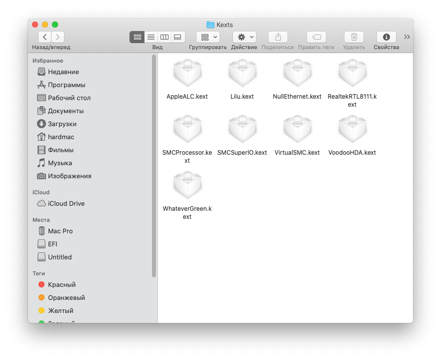

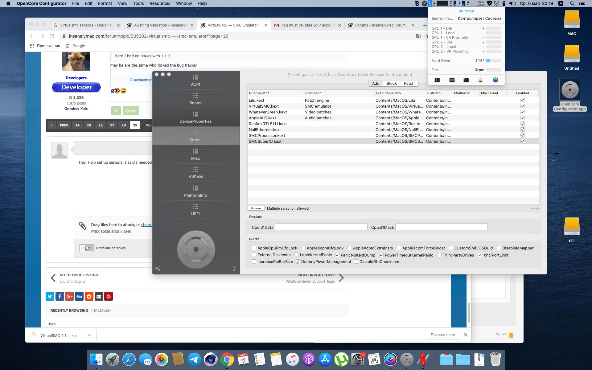

tyta Posted May 6, 2020 Share Posted May 6, 2020 (edited) Hey. Help set up sensors. I said that I need to kext folder EFI-OC-kext, but no sensors. I'm new to this .If I had Ryzen 2600 Edited May 6, 2020 by tyta Link to comment https://www.insanelymac.com/forum/topic/335292-virtualsmc-%E2%80%94-smc-emulator/page/29/#findComment-2721273 Share on other sites More sharing options...
neemagha Posted May 6, 2020 Share Posted May 6, 2020 Hello. iStat was working perfectly on my Hackintosh. The CPU and GPU temps are no longer displaying. I have fully updated to OpenCore 0.5.8 and latest VirtualSMC and associated drivers. Any suggestions? Link to comment https://www.insanelymac.com/forum/topic/335292-virtualsmc-%E2%80%94-smc-emulator/page/29/#findComment-2721279 Share on other sites More sharing options...

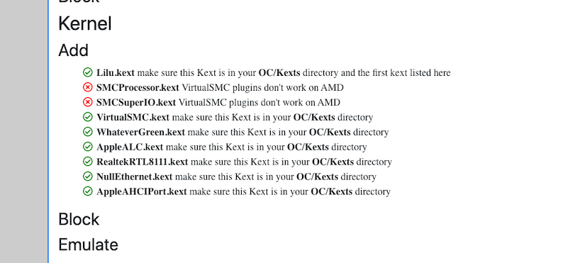

tyta Posted May 6, 2020 Share Posted May 6, 2020 (edited) 1 hour ago, neemagha said: Привет. iStat отлично работал на моем Хакинтоше. Температуры CPU и GPU больше не отображаются. Я полностью обновился до OpenCore 0.5.8 и последней версии VirtualSMC и связанных драйверов. Какие-либо предложения? I installed OpenCore 0.5.7, Mac OS Catalina 10.15.4, VirtualSMS updated in OpenCore configurator. Edited May 6, 2020 by tyta Link to comment https://www.insanelymac.com/forum/topic/335292-virtualsmc-%E2%80%94-smc-emulator/page/29/#findComment-2721285 Share on other sites More sharing options...
tyta Posted May 6, 2020 Share Posted May 6, 2020 2 hours ago, tyta said: I installed OpenCore 0.5.7, Mac OS Catalina 10.15.4, VirtualSMS updated in OpenCore configurator. I've found something ...Sanity Checker Link to comment https://www.insanelymac.com/forum/topic/335292-virtualsmc-%E2%80%94-smc-emulator/page/29/#findComment-2721297 Share on other sites More sharing options...
