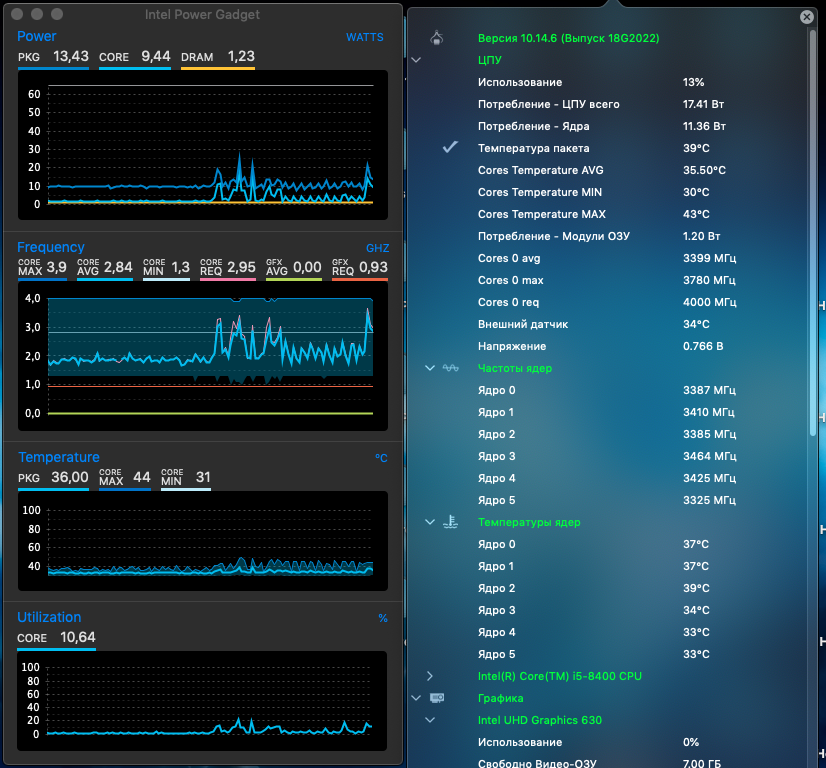

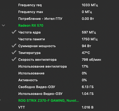

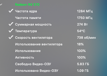

Nuacho Posted January 28, 2020 Share Posted January 28, 2020 @vector sigma Today I noticed that when using HWMonitorSMC2 - inel power gadget shows high frequencies. ps. Radeon rx570 at idle 34-35 watts should be. and in my idle time it is 90 watts and under a load of 274 watts - which is not true. Link to comment https://www.insanelymac.com/forum/topic/335292-virtualsmc-%E2%80%94-smc-emulator/page/28/#findComment-2706189 Share on other sites More sharing options...
jinbingmao Posted January 29, 2020 Share Posted January 29, 2020 (edited) 22小时前,努阿乔说: •HWMonitorSMC2 - inelps. Radeon rx570 [ 34-35][90] [ 274] Edited January 29, 2020 by jinbingmao 1 Link to comment https://www.insanelymac.com/forum/topic/335292-virtualsmc-%E2%80%94-smc-emulator/page/28/#findComment-2706208 Share on other sites More sharing options...
vector sigma Posted January 29, 2020 Share Posted January 29, 2020 (edited) 21 hours ago, Nuacho said: @vector sigma Today I noticed that when using HWMonitorSMC2 - inel power gadget shows high frequencies. Here are the same if I set the same timing, otherwise are different of course 17 hours ago, jinbingmao said: ps. Radeon rx570 at idle 34-35 watts should be. and in my idle time it is 90 watts and under a load of 274 watts - which is not true. I said this multiple times, values are taken from macOS. You should file a bug at Apple for unsupported hardware..... but I can image the answere EDIT you can try: https://support.apple.com/en-us/HT208898 They can fix it... if someone will tell to them Edited January 29, 2020 by vector sigma 1 1 Link to comment https://www.insanelymac.com/forum/topic/335292-virtualsmc-%E2%80%94-smc-emulator/page/28/#findComment-2706290 Share on other sites More sharing options...

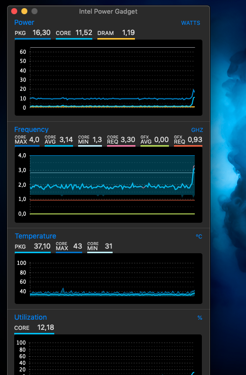

Andrey1970 Posted February 2, 2020 Share Posted February 2, 2020 @vector sigma HWMonitorSMC2 and IPG show different frequencies. It not different timing. Link to comment https://www.insanelymac.com/forum/topic/335292-virtualsmc-%E2%80%94-smc-emulator/page/28/#findComment-2706793 Share on other sites More sharing options...
vector sigma Posted February 3, 2020 Share Posted February 3, 2020 2 hours ago, Andrey1970 said: @vector sigma HWMonitorSMC2 and IPG show different frequencies. It not different timing. IPG show "Core Frequency min/max" for the entire life time of the app. Means if you turn on the pc in the morning (and you launch a benchmark) min is the low frequency when you started up the computer, while the frequency max will be the max frequency you registered yesterday Lol. In HWMonitorSMC2 min and max refear between two samples. As you can set from 10 ms up to 10 seconds, while IPG.app from 5ms to 1 seconds. Intel also doesn't show frequencies/temperature in detail for each core because needs a new interface. Timings are all, but I don't need IPG to know my mobile cpu reaches 3,1GHz in turbo boost... I know that already P.S. if you want more precision create a file or directory to your Desktop: ~/Desktop/IPGPMU and restart the app. Be aware that from now on there is only one winner between applications that uses IntelPowerGadget.framework, HWMonitorSMC2 or the other. Another tip, if you create: ~/Desktop/IPGOLD HWMonitorSMC2.app will use the old library... Link to comment https://www.insanelymac.com/forum/topic/335292-virtualsmc-%E2%80%94-smc-emulator/page/28/#findComment-2706807 Share on other sites More sharing options...
Andrey1970 Posted February 3, 2020 Share Posted February 3, 2020 19 hours ago, vector sigma said: IPG show "Core Frequency min/max" for the entire life time of the app. Means if you turn on the pc in the morning (and you launch a benchmark) min is the low frequency when you started up the computer, while the frequency max will be the max frequency you registered yesterday Lol. In HWMonitorSMC2 min and max refear between two samples. As you can set from 10 ms up to 10 seconds, while IPG.app from 5ms to 1 seconds. Intel also doesn't show frequencies/temperature in detail for each core because needs a new interface. Timings are all, but I don't need IPG to know my mobile cpu reaches 3,1GHz in turbo boost... I know that already P.S. if you want more precision create a file or directory to your Desktop: ~/Desktop/IPGPMU and restart the app. Be aware that from now on there is only one winner between applications that uses IntelPowerGadget.framework, HWMonitorSMC2 or the other. Another tip, if you create: ~/Desktop/IPGOLD HWMonitorSMC2.app will use the old library... I would prefer IPGPMU or IPGOLD, but it works only if IPG is started and I don't like to hold the folder on a desktop. It is better to provide a choice to the user in settings: IPGVECTOR IPGPMU IPGOLD It is possible? Link to comment https://www.insanelymac.com/forum/topic/335292-virtualsmc-%E2%80%94-smc-emulator/page/28/#findComment-2706929 Share on other sites More sharing options...

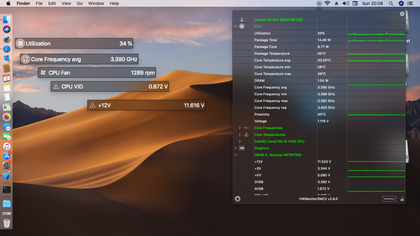

unixb0y Posted February 4, 2020 Share Posted February 4, 2020 On 2/2/2020 at 8:35 PM, vector sigma said: New HWMonitorSMC2.app v2.6.0 here with all the changes discussed here and there Just downloaded it, how can I show the plots? I don't have them, somehow. And find no settings where to activate them. Link to comment https://www.insanelymac.com/forum/topic/335292-virtualsmc-%E2%80%94-smc-emulator/page/28/#findComment-2707024 Share on other sites More sharing options...
vector sigma Posted February 4, 2020 Share Posted February 4, 2020 2 hours ago, unixb0y said: Just downloaded it, how can I show the plots? I don't have them, somehow. And find no settings where to activate them. a right click? 1 Link to comment https://www.insanelymac.com/forum/topic/335292-virtualsmc-%E2%80%94-smc-emulator/page/28/#findComment-2707049 Share on other sites More sharing options...

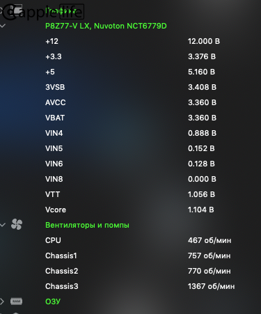

Nuacho Posted February 13, 2020 Share Posted February 13, 2020 @vector sigma asus p8z77vlx Nuvoton NCT6779D.zip 1 Link to comment https://www.insanelymac.com/forum/topic/335292-virtualsmc-%E2%80%94-smc-emulator/page/28/#findComment-2708162 Share on other sites More sharing options...

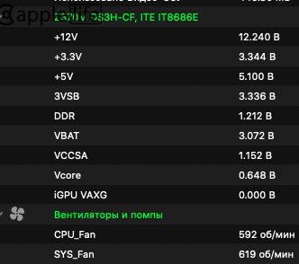

Nuacho Posted February 13, 2020 Share Posted February 13, 2020 @vector sigma Z370M DS3H-CF.plist.zip 1 Link to comment https://www.insanelymac.com/forum/topic/335292-virtualsmc-%E2%80%94-smc-emulator/page/28/#findComment-2708175 Share on other sites More sharing options...

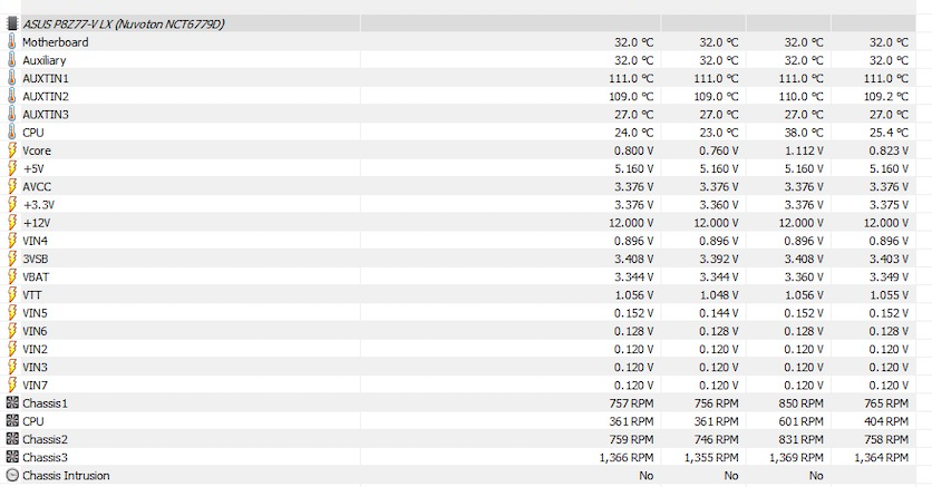

vector sigma Posted February 14, 2020 Share Posted February 14, 2020 15 hours ago, Nuacho said: @vector sigma Z370M DS3H-CF.plist.zip Added 16 hours ago, Nuacho said: @vector sigma asus p8z77vlx Nuvoton NCT6779D.zip Sure you want to show VIn4, VIN5, VIN6 and VIN8 without know what they are? Link to comment https://www.insanelymac.com/forum/topic/335292-virtualsmc-%E2%80%94-smc-emulator/page/28/#findComment-2708254 Share on other sites More sharing options...
Nuacho Posted February 14, 2020 Share Posted February 14, 2020 (edited) 1 hour ago, vector sigma said: Added Sure you want to show VIn4, VIN5, VIN6 and VIN8 without know what they are? Yes, let users decide whether it is necessary or not, you can always skip it. everyone sets up what he needs, and I just verified that it works. Edited February 14, 2020 by Nuacho Link to comment https://www.insanelymac.com/forum/topic/335292-virtualsmc-%E2%80%94-smc-emulator/page/28/#findComment-2708267 Share on other sites More sharing options...
vector sigma Posted February 14, 2020 Share Posted February 14, 2020 HWMonitorSMC2.app v2.6.1 released. 3 hours ago, Nuacho said: Yes, let users decide whether it is necessary or not, you can always skip it. everyone sets up what he needs, and I just verified that it works. I admit that a little more research (e.g. running both Aida64 and HWSensor in Windows) would have been helpful to you discovering more stuff. But consider again that not all the sensors can be physically attached to a real sensor but shown because the LPC chip has those pins. Anyway I've added it. 1 1 Link to comment https://www.insanelymac.com/forum/topic/335292-virtualsmc-%E2%80%94-smc-emulator/page/28/#findComment-2708290 Share on other sites More sharing options...

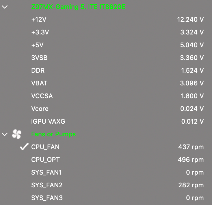

DocXavier Posted February 14, 2020 Share Posted February 14, 2020 Z97MX-Gaming 5.plist Thanks a lot Vector¡¡¡ 1 Link to comment https://www.insanelymac.com/forum/topic/335292-virtualsmc-%E2%80%94-smc-emulator/page/28/#findComment-2708294 Share on other sites More sharing options...
Nuacho Posted February 14, 2020 Share Posted February 14, 2020 58 minutes ago, vector sigma said: HWMonitorSMC2.app v2.6.1 released. I admit that a little more research (e.g. running both Aida64 and HWSensor in Windows) would have been helpful to you discovering more stuff. But consider again that not all the sensors can be physically attached to a real sensor but shown because the LPC chip has those pins. Anyway I've added it. Thanks for the advice, I understand that. for example, I’ll research which indicators work and which simply show a number. 1 Link to comment https://www.insanelymac.com/forum/topic/335292-virtualsmc-%E2%80%94-smc-emulator/page/28/#findComment-2708295 Share on other sites More sharing options...
vector sigma Posted February 14, 2020 Share Posted February 14, 2020 3 minutes ago, DocXavier said: Z97MX-Gaming 5.plist Thanks a lot Vector¡¡¡ I'm going to add it to the repository. Will be shared with the next release. 5 minutes ago, DocXavier said: Z97MX-Gaming 5.plist Thanks a lot Vector¡¡¡ Asus? Gigabyte?? else? 1 Link to comment https://www.insanelymac.com/forum/topic/335292-virtualsmc-%E2%80%94-smc-emulator/page/28/#findComment-2708296 Share on other sites More sharing options...
DocXavier Posted February 14, 2020 Share Posted February 14, 2020 3 minutes ago, vector sigma said: I'm going to add it to the repository. Will be shared with the next release. Asus? Gigabyte?? else? Sorry ... Gigabyte / IT8620E 1 1 Link to comment https://www.insanelymac.com/forum/topic/335292-virtualsmc-%E2%80%94-smc-emulator/page/28/#findComment-2708297 Share on other sites More sharing options...
Nuacho Posted February 15, 2020 Share Posted February 15, 2020 10 hours ago, DocXavier said: Z97MX-Gaming 5.plist Thanks a lot Vector¡¡¡ vcore 0,024v? maybe you were wrong? Link to comment https://www.insanelymac.com/forum/topic/335292-virtualsmc-%E2%80%94-smc-emulator/page/28/#findComment-2708340 Share on other sites More sharing options...
DocXavier Posted February 15, 2020 Share Posted February 15, 2020 (edited) 4 hours ago, Nuacho said: vcore 0,024v? maybe you were wrong? VIN0 should be Vcore as per chip specs ... But you are right, I don't know which is the shown value. Maybe some PLL volts? I'll try to find some info. Her is the plist hidding this info for now Thanks Nuacho for your notice¡¡¡ Z97MX-Gaming 5.plist Edited February 15, 2020 by DocXavier Link to comment https://www.insanelymac.com/forum/topic/335292-virtualsmc-%E2%80%94-smc-emulator/page/28/#findComment-2708358 Share on other sites More sharing options...
vector sigma Posted February 15, 2020 Share Posted February 15, 2020 2 hours ago, DocXavier said: VIN0 should be Vcore as per chip specs ... But you are right, I don't know which is the shown value. Maybe some PLL volts? I'll try to find some info. Her is the plist hidding this info for now Thanks Nuacho for your notice¡¡¡ Z97MX-Gaming 5.plist updated Link to comment https://www.insanelymac.com/forum/topic/335292-virtualsmc-%E2%80%94-smc-emulator/page/28/#findComment-2708369 Share on other sites More sharing options...
