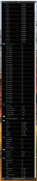

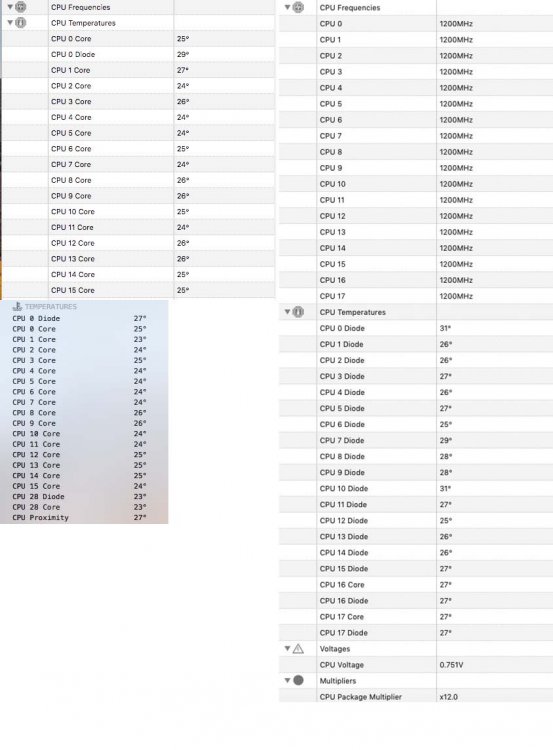

Guest Posted October 8, 2018 Share Posted October 8, 2018 Hi @vit9696 I am using your VirtualSMC kext togheter with SMCProcessor kext Testing it with @vectorsigma HWMonitorSMC2 app (Slice original app) I would like to show you some screen shot with/without SMCProcessor kext with: (app see in test description 18 cores 36 threads as it is but only 16 cores on the left (from 0 to 15)) without (always 18 cores/36 threads on app description and no data for CPU in this case) Is it a SMCProcessor fault? Thank you in advance Link to comment https://www.insanelymac.com/forum/topic/335292-virtualsmc-%E2%80%94-smc-emulator/page/11/#findComment-2639532 Share on other sites More sharing options...
vit9696 Posted October 12, 2018 Author Share Posted October 12, 2018 Hi, Best check smcread -s output and verify the key amount. VirtualSMC has all the necessary documentation about SMC keys in Docs folder. If the amount of keys does not match, I guess some research is going to be needed. Otherwise HWSensors2 is under question (more likely, because we tested large multicore systems). 1 Link to comment https://www.insanelymac.com/forum/topic/335292-virtualsmc-%E2%80%94-smc-emulator/page/11/#findComment-2640305 Share on other sites More sharing options...
Guest Posted October 12, 2018 Share Posted October 12, 2018 (edited) hi @vit9696 macOS 10.13.6 (17G65) Public keys (123): [#KEY] type [ui32] 75693332 len [ 4] attr [80] -> 0000007B [$Adr] type [ui32] 75693332 len [ 4] attr [80] -> 00000300 [$Num] type [ui8 ] 75693820 len [ 1] attr [D0] -> 01 [BATP] type [flag] 666C6167 len [ 1] attr [80] -> 00 [BEMB] type [flag] 666C6167 len [ 1] attr [80] -> 00 [CLKH] type [{clh] 7B636C68 len [ 8] attr [D0] -> 0000708000011940 [CLKT] type [ui32] 75693332 len [ 4] attr [D0] -> 0000EAFF [CLWK] type [ui16] 75693136 len [ 2] attr [D0] -> 9DF2 [CRCA] type [ui32] 75693332 len [ 4] attr [80] -> 74D4E1B0 [CRCB] type [ui32] 75693332 len [ 4] attr [80] -> 1FAF7297 [CRCC] type [ui32] 75693332 len [ 4] attr [80] -> A34059E0 [CRCF] type [ui32] 75693332 len [ 4] attr [90] -> FAA0FAA9 [CRCK] type [ui32] 75693332 len [ 4] attr [90] -> 00000000 [CRCR] type [ui32] 75693332 len [ 4] attr [80] -> F6C2CF61 [CRCU] type [ui32] 75693332 len [ 4] attr [80] -> 645B2572 [CRCa] type [ui32] 75693332 len [ 4] attr [90] -> 74D4E1B0 [CRCb] type [ui32] 75693332 len [ 4] attr [90] -> 1FAF7297 [CRCc] type [ui32] 75693332 len [ 4] attr [90] -> A34059E0 [CRCr] type [ui32] 75693332 len [ 4] attr [90] -> F6C2CF61 [CRCu] type [ui32] 75693332 len [ 4] attr [90] -> 645B2572 [DPLM] type [{lim] 7B6C696D len [ 5] attr [51] -> NOT READABLE, code 85 [DUSR] type [ui8 ] 75693820 len [ 1] attr [40] -> NOT READABLE, code 85 [EFBM] type [ui8 ] 75693820 len [ 1] attr [C0] -> 00 [EFBP] type [ui8 ] 75693820 len [ 1] attr [C0] -> 00 [EFBS] type [ui8 ] 75693820 len [ 1] attr [D0] -> 0D [EPCI] type [ui32] 75693332 len [ 4] attr [80] -> 0810F000 [EVCT] type [hex_] 6865785F len [ 2] attr [D0] -> 0000 [EVHF] type [ch8*] 6368382A len [28] attr [90] -> 00000000000000000000000000000000000000000000000000000000 [EVRD] type [ch8*] 6368382A len [32] attr [90] -> 0000000000000000000000000000000000000000000000000000000000000000 [FAC0] type [ui8 ] 75693820 len [ 1] attr [C0] -> 00 [FNum] type [ui8 ] 75693820 len [ 1] attr [80] -> 00 [HBKP] type [ch8*] 6368382A len [32] attr [C0] -> 0000000000000000000000000000000000000000000000000000000000000000 [LDKN] type [ui8 ] 75693820 len [ 1] attr [80] -> 02 [LDLG] type [ch8*] 6368382A len [ 1] attr [50] -> NOT READABLE, code 85 [LDSP] type [flag] 666C6167 len [ 1] attr [40] -> NOT READABLE, code 85 [LsNM] type [ui8 ] 75693820 len [ 1] attr [80] -> 00 [MSDW] type [flag] 666C6167 len [ 1] attr [50] -> NOT READABLE, code 85 [MSFW] type [flag] 666C6167 len [ 1] attr [C0] -> 00 [MSPC] type [ui8 ] 75693820 len [ 1] attr [D0] -> 19 [MSPP] type [ui8 ] 75693820 len [ 1] attr [80] -> 00 [MSPR] type [ui8 ] 75693820 len [ 2] attr [80] -> 0001 [MSPS] type [hex_] 6865785F len [ 2] attr [80] -> 0004 [MSQC] type [ui8 ] 75693820 len [ 1] attr [80] -> 00 [MSSD] type [si8 ] 73693820 len [ 1] attr [D0] -> 05 [MSSP] type [si8 ] 73693820 len [ 1] attr [C0] -> 05 [MSSW] type [flag] 666C6167 len [ 1] attr [C0] -> 00 [MSTc] type [ui8 ] 75693820 len [ 1] attr [80] -> 00 [MSTe] type [ui8 ] 75693820 len [ 1] attr [80] -> 00 [MSTf] type [ui8 ] 75693820 len [ 1] attr [80] -> 00 [MSTi] type [ui8 ] 75693820 len [ 1] attr [80] -> 00 [MSTj] type [ui8 ] 75693820 len [ 1] attr [80] -> 00 [MSTm] type [ui8 ] 75693820 len [ 1] attr [80] -> 00 [MSWr] type [ui8 ] 75693820 len [ 1] attr [80] -> 00 [NATJ] type [ui8 ] 75693820 len [ 1] attr [C0] -> 00 [NATi] type [ui16] 75693136 len [ 2] attr [C0] -> 0000 [NTOK] type [ui8 ] 75693820 len [ 1] attr [50] -> NOT READABLE, code 85 [OSWD] type [ui16] 75693136 len [ 2] attr [C0] -> 001C [RBr ] type [ch8*] 6368382A len [ 8] attr [80] -> 6A31333700356100 [REV ] type [{rev] 7B726576 len [ 6] attr [90] -> 02410F000001 [RGEN] type [ui8 ] 75693820 len [ 1] attr [80] -> 02 [RMAC] type [ch8*] 6368382A len [ 6] attr [C4] -> 0A88552FD273 [RMSN] type [ch8*] 6368382A len [17] attr [C4] -> 433032544C314135485838374142434445 [RMde] type [char] 63686172 len [ 1] attr [80] -> 41 [RPlt] type [ch8*] 6368382A len [ 8] attr [80] -> 6A31333700000000 [RSSN] type [ch8*] 6368382A len [16] attr [C4] -> 433032564A30424D4858383700000000 [RVBF] type [{rev] 7B726576 len [ 6] attr [90] -> 02280F000007 [RVCR] type [{rev] 7B726576 len [ 6] attr [90] -> FFFFFFFFFFFF [RVUF] type [{rev] 7B726576 len [ 6] attr [90] -> 02280F000007 [WKTP] type [ui8 ] 75693820 len [ 1] attr [D0] -> 00 [PC0C] type [sp96] 73703936 len [ 2] attr [80] -> 0000 [PC0R] type [sp96] 73703936 len [ 2] attr [80] -> 0000 [PC3C] type [flt ] 666C7420 len [ 4] attr [80] -> C7853B42 [PCAM] type [flt ] 666C7420 len [ 4] attr [80] -> 00000000 [PCEC] type [flt ] 666C7420 len [ 4] attr [80] -> C7853B42 [PCPC] type [sp96] 73703936 len [ 2] attr [80] -> 0000 [PCPR] type [sp96] 73703936 len [ 2] attr [80] -> 096F [PCPT] type [sp96] 73703936 len [ 2] attr [80] -> 096F [PCTR] type [sp96] 73703936 len [ 2] attr [80] -> 096F [TC0C] type [sp78] 73703738 len [ 2] attr [80] -> 1800 [TC0D] type [sp78] 73703738 len [ 2] attr [80] -> 1B00 [TC0E] type [sp78] 73703738 len [ 2] attr [80] -> 1B00 [TC0F] type [sp78] 73703738 len [ 2] attr [80] -> 1B00 [TC0G] type [sp78] 73703738 len [ 2] attr [80] -> 0000 [TC0H] type [sp78] 73703738 len [ 2] attr [80] -> 1B00 [TC0J] type [sp78] 73703738 len [ 2] attr [80] -> 0000 [TC0P] type [sp78] 73703738 len [ 2] attr [80] -> 1B00 [TC0c] type [sp78] 73703738 len [ 2] attr [80] -> 1800 [TC0p] type [sp78] 73703738 len [ 2] attr [80] -> 1B00 [TC1C] type [sp78] 73703738 len [ 2] attr [80] -> 1700 [TC1c] type [sp78] 73703738 len [ 2] attr [80] -> 1700 [TC2C] type [sp78] 73703738 len [ 2] attr [80] -> 1700 [TC2c] type [sp78] 73703738 len [ 2] attr [80] -> 1700 [TC3C] type [sp78] 73703738 len [ 2] attr [80] -> 1A00 [TC3c] type [sp78] 73703738 len [ 2] attr [80] -> 1A00 [TC4C] type [sp78] 73703738 len [ 2] attr [80] -> 1700 [TC4c] type [sp78] 73703738 len [ 2] attr [80] -> 1700 [TC5C] type [sp78] 73703738 len [ 2] attr [80] -> 1700 [TC5c] type [sp78] 73703738 len [ 2] attr [80] -> 1700 [TC6C] type [sp78] 73703738 len [ 2] attr [80] -> 1800 [TC6c] type [sp78] 73703738 len [ 2] attr [80] -> 1800 [TC7C] type [sp78] 73703738 len [ 2] attr [80] -> 1700 [TC7c] type [sp78] 73703738 len [ 2] attr [80] -> 1700 [TC8C] type [sp78] 73703738 len [ 2] attr [80] -> 1900 [TC8c] type [sp78] 73703738 len [ 2] attr [80] -> 1900 [TC9C] type [sp78] 73703738 len [ 2] attr [80] -> 1A00 [TC9c] type [sp78] 73703738 len [ 2] attr [80] -> 1A00 [TCAC] type [sp78] 73703738 len [ 2] attr [80] -> 1800 [TCAc] type [sp78] 73703738 len [ 2] attr [80] -> 1800 [TCBC] type [sp78] 73703738 len [ 2] attr [80] -> 1700 [TCBc] type [sp78] 73703738 len [ 2] attr [80] -> 1700 [TCCC] type [sp78] 73703738 len [ 2] attr [80] -> 1900 [TCCc] type [sp78] 73703738 len [ 2] attr [80] -> 1900 [TCDC] type [sp78] 73703738 len [ 2] attr [80] -> 1900 [TCDc] type [sp78] 73703738 len [ 2] attr [80] -> 1900 [TCEC] type [sp78] 73703738 len [ 2] attr [80] -> 1800 [TCEc] type [sp78] 73703738 len [ 2] attr [80] -> 1800 [TCFC] type [sp78] 73703738 len [ 2] attr [80] -> 1800 [TCFc] type [sp78] 73703738 len [ 2] attr [80] -> 1800 [TCGC] type [sp78] 73703738 len [ 2] attr [80] -> 1900 [TCGc] type [sp78] 73703738 len [ 2] attr [80] -> 1900 [TCHC] type [sp78] 73703738 len [ 2] attr [80] -> 1B00 [TCHc] type [sp78] 73703738 len [ 2] attr [80] -> 1B00 [VC0C] type [sp3c] 73703363 len [ 2] attr [80] -> 0B63 Hidden keys (?): [____] type [flag] 666C6167 len [ 1] attr [80] -> 01 [OSK0] type [ch8*] 6368382A len [32] attr [90] -> 6F757268617264776F726B62797468657365776F72647367756172646564706C [OSK1] type [ch8*] 6368382A len [32] attr [90] -> 65617365646F6E74737465616C2863294170706C65436F6D7075746572496E63 [KPPW] type [ch8*] 6368382A len [32] attr [50] -> NOT READABLE [KPST] type [ui8 ] 75693820 len [ 1] attr [80] -> 00 Then on pictures attacched on the left new and very old app with VirtualSMC and SMCProcessor on the right new app with FakeSMC and old sensor With an old app I have tested also a 2696 v4 Xeon (22/44 threads) and all cores and frequency was there (No public VirtualSMC kext was available in that time) I can't test now because link is not available anymore thank you for your explanation Edited October 12, 2018 by Guest Link to comment https://www.insanelymac.com/forum/topic/335292-virtualsmc-%E2%80%94-smc-emulator/page/11/#findComment-2640327 Share on other sites More sharing options...

vit9696 Posted October 14, 2018 Author Share Posted October 14, 2018 On 10/12/2018 at 11:52 AM, fabiosun said: hi @vit9696 macOS 10.13.6 (17G65) Public keys (123): [#KEY] type [ui32] 75693332 len [ 4] attr [80] -> 0000007B [$Adr] type [ui32] 75693332 len [ 4] attr [80] -> 00000300 [$Num] type [ui8 ] 75693820 len [ 1] attr [D0] -> 01 [BATP] type [flag] 666C6167 len [ 1] attr [80] -> 00 [BEMB] type [flag] 666C6167 len [ 1] attr [80] -> 00 [CLKH] type [{clh] 7B636C68 len [ 8] attr [D0] -> 0000708000011940 [CLKT] type [ui32] 75693332 len [ 4] attr [D0] -> 0000EAFF [CLWK] type [ui16] 75693136 len [ 2] attr [D0] -> 9DF2 [CRCA] type [ui32] 75693332 len [ 4] attr [80] -> 74D4E1B0 [CRCB] type [ui32] 75693332 len [ 4] attr [80] -> 1FAF7297 [CRCC] type [ui32] 75693332 len [ 4] attr [80] -> A34059E0 [CRCF] type [ui32] 75693332 len [ 4] attr [90] -> FAA0FAA9 [CRCK] type [ui32] 75693332 len [ 4] attr [90] -> 00000000 [CRCR] type [ui32] 75693332 len [ 4] attr [80] -> F6C2CF61 [CRCU] type [ui32] 75693332 len [ 4] attr [80] -> 645B2572 [CRCa] type [ui32] 75693332 len [ 4] attr [90] -> 74D4E1B0 [CRCb] type [ui32] 75693332 len [ 4] attr [90] -> 1FAF7297 [CRCc] type [ui32] 75693332 len [ 4] attr [90] -> A34059E0 [CRCr] type [ui32] 75693332 len [ 4] attr [90] -> F6C2CF61 [CRCu] type [ui32] 75693332 len [ 4] attr [90] -> 645B2572 [DPLM] type [{lim] 7B6C696D len [ 5] attr [51] -> NOT READABLE, code 85 [DUSR] type [ui8 ] 75693820 len [ 1] attr [40] -> NOT READABLE, code 85 [EFBM] type [ui8 ] 75693820 len [ 1] attr [C0] -> 00 [EFBP] type [ui8 ] 75693820 len [ 1] attr [C0] -> 00 [EFBS] type [ui8 ] 75693820 len [ 1] attr [D0] -> 0D [EPCI] type [ui32] 75693332 len [ 4] attr [80] -> 0810F000 [EVCT] type [hex_] 6865785F len [ 2] attr [D0] -> 0000 [EVHF] type [ch8*] 6368382A len [28] attr [90] -> 00000000000000000000000000000000000000000000000000000000 [EVRD] type [ch8*] 6368382A len [32] attr [90] -> 0000000000000000000000000000000000000000000000000000000000000000 [FAC0] type [ui8 ] 75693820 len [ 1] attr [C0] -> 00 [FNum] type [ui8 ] 75693820 len [ 1] attr [80] -> 00 [HBKP] type [ch8*] 6368382A len [32] attr [C0] -> 0000000000000000000000000000000000000000000000000000000000000000 [LDKN] type [ui8 ] 75693820 len [ 1] attr [80] -> 02 [LDLG] type [ch8*] 6368382A len [ 1] attr [50] -> NOT READABLE, code 85 [LDSP] type [flag] 666C6167 len [ 1] attr [40] -> NOT READABLE, code 85 [LsNM] type [ui8 ] 75693820 len [ 1] attr [80] -> 00 [MSDW] type [flag] 666C6167 len [ 1] attr [50] -> NOT READABLE, code 85 [MSFW] type [flag] 666C6167 len [ 1] attr [C0] -> 00 [MSPC] type [ui8 ] 75693820 len [ 1] attr [D0] -> 19 [MSPP] type [ui8 ] 75693820 len [ 1] attr [80] -> 00 [MSPR] type [ui8 ] 75693820 len [ 2] attr [80] -> 0001 [MSPS] type [hex_] 6865785F len [ 2] attr [80] -> 0004 [MSQC] type [ui8 ] 75693820 len [ 1] attr [80] -> 00 [MSSD] type [si8 ] 73693820 len [ 1] attr [D0] -> 05 [MSSP] type [si8 ] 73693820 len [ 1] attr [C0] -> 05 [MSSW] type [flag] 666C6167 len [ 1] attr [C0] -> 00 [MSTc] type [ui8 ] 75693820 len [ 1] attr [80] -> 00 [MSTe] type [ui8 ] 75693820 len [ 1] attr [80] -> 00 [MSTf] type [ui8 ] 75693820 len [ 1] attr [80] -> 00 [MSTi] type [ui8 ] 75693820 len [ 1] attr [80] -> 00 [MSTj] type [ui8 ] 75693820 len [ 1] attr [80] -> 00 [MSTm] type [ui8 ] 75693820 len [ 1] attr [80] -> 00 [MSWr] type [ui8 ] 75693820 len [ 1] attr [80] -> 00 [NATJ] type [ui8 ] 75693820 len [ 1] attr [C0] -> 00 [NATi] type [ui16] 75693136 len [ 2] attr [C0] -> 0000 [NTOK] type [ui8 ] 75693820 len [ 1] attr [50] -> NOT READABLE, code 85 [OSWD] type [ui16] 75693136 len [ 2] attr [C0] -> 001C [RBr ] type [ch8*] 6368382A len [ 8] attr [80] -> 6A31333700356100 [REV ] type [{rev] 7B726576 len [ 6] attr [90] -> 02410F000001 [RGEN] type [ui8 ] 75693820 len [ 1] attr [80] -> 02 [RMAC] type [ch8*] 6368382A len [ 6] attr [C4] -> 0A88552FD273 [RMSN] type [ch8*] 6368382A len [17] attr [C4] -> 433032544C314135485838374142434445 [RMde] type [char] 63686172 len [ 1] attr [80] -> 41 [RPlt] type [ch8*] 6368382A len [ 8] attr [80] -> 6A31333700000000 [RSSN] type [ch8*] 6368382A len [16] attr [C4] -> 433032564A30424D4858383700000000 [RVBF] type [{rev] 7B726576 len [ 6] attr [90] -> 02280F000007 [RVCR] type [{rev] 7B726576 len [ 6] attr [90] -> FFFFFFFFFFFF [RVUF] type [{rev] 7B726576 len [ 6] attr [90] -> 02280F000007 [WKTP] type [ui8 ] 75693820 len [ 1] attr [D0] -> 00 [PC0C] type [sp96] 73703936 len [ 2] attr [80] -> 0000 [PC0R] type [sp96] 73703936 len [ 2] attr [80] -> 0000 [PC3C] type [flt ] 666C7420 len [ 4] attr [80] -> C7853B42 [PCAM] type [flt ] 666C7420 len [ 4] attr [80] -> 00000000 [PCEC] type [flt ] 666C7420 len [ 4] attr [80] -> C7853B42 [PCPC] type [sp96] 73703936 len [ 2] attr [80] -> 0000 [PCPR] type [sp96] 73703936 len [ 2] attr [80] -> 096F [PCPT] type [sp96] 73703936 len [ 2] attr [80] -> 096F [PCTR] type [sp96] 73703936 len [ 2] attr [80] -> 096F [TC0C] type [sp78] 73703738 len [ 2] attr [80] -> 1800 [TC0D] type [sp78] 73703738 len [ 2] attr [80] -> 1B00 [TC0E] type [sp78] 73703738 len [ 2] attr [80] -> 1B00 [TC0F] type [sp78] 73703738 len [ 2] attr [80] -> 1B00 [TC0G] type [sp78] 73703738 len [ 2] attr [80] -> 0000 [TC0H] type [sp78] 73703738 len [ 2] attr [80] -> 1B00 [TC0J] type [sp78] 73703738 len [ 2] attr [80] -> 0000 [TC0P] type [sp78] 73703738 len [ 2] attr [80] -> 1B00 [TC0c] type [sp78] 73703738 len [ 2] attr [80] -> 1800 [TC0p] type [sp78] 73703738 len [ 2] attr [80] -> 1B00 [TC1C] type [sp78] 73703738 len [ 2] attr [80] -> 1700 [TC1c] type [sp78] 73703738 len [ 2] attr [80] -> 1700 [TC2C] type [sp78] 73703738 len [ 2] attr [80] -> 1700 [TC2c] type [sp78] 73703738 len [ 2] attr [80] -> 1700 [TC3C] type [sp78] 73703738 len [ 2] attr [80] -> 1A00 [TC3c] type [sp78] 73703738 len [ 2] attr [80] -> 1A00 [TC4C] type [sp78] 73703738 len [ 2] attr [80] -> 1700 [TC4c] type [sp78] 73703738 len [ 2] attr [80] -> 1700 [TC5C] type [sp78] 73703738 len [ 2] attr [80] -> 1700 [TC5c] type [sp78] 73703738 len [ 2] attr [80] -> 1700 [TC6C] type [sp78] 73703738 len [ 2] attr [80] -> 1800 [TC6c] type [sp78] 73703738 len [ 2] attr [80] -> 1800 [TC7C] type [sp78] 73703738 len [ 2] attr [80] -> 1700 [TC7c] type [sp78] 73703738 len [ 2] attr [80] -> 1700 [TC8C] type [sp78] 73703738 len [ 2] attr [80] -> 1900 [TC8c] type [sp78] 73703738 len [ 2] attr [80] -> 1900 [TC9C] type [sp78] 73703738 len [ 2] attr [80] -> 1A00 [TC9c] type [sp78] 73703738 len [ 2] attr [80] -> 1A00 [TCAC] type [sp78] 73703738 len [ 2] attr [80] -> 1800 [TCAc] type [sp78] 73703738 len [ 2] attr [80] -> 1800 [TCBC] type [sp78] 73703738 len [ 2] attr [80] -> 1700 [TCBc] type [sp78] 73703738 len [ 2] attr [80] -> 1700 [TCCC] type [sp78] 73703738 len [ 2] attr [80] -> 1900 [TCCc] type [sp78] 73703738 len [ 2] attr [80] -> 1900 [TCDC] type [sp78] 73703738 len [ 2] attr [80] -> 1900 [TCDc] type [sp78] 73703738 len [ 2] attr [80] -> 1900 [TCEC] type [sp78] 73703738 len [ 2] attr [80] -> 1800 [TCEc] type [sp78] 73703738 len [ 2] attr [80] -> 1800 [TCFC] type [sp78] 73703738 len [ 2] attr [80] -> 1800 [TCFc] type [sp78] 73703738 len [ 2] attr [80] -> 1800 [TCGC] type [sp78] 73703738 len [ 2] attr [80] -> 1900 [TCGc] type [sp78] 73703738 len [ 2] attr [80] -> 1900 [TCHC] type [sp78] 73703738 len [ 2] attr [80] -> 1B00 [TCHc] type [sp78] 73703738 len [ 2] attr [80] -> 1B00 [VC0C] type [sp3c] 73703363 len [ 2] attr [80] -> 0B63 Hidden keys (?): [____] type [flag] 666C6167 len [ 1] attr [80] -> 01 [OSK0] type [ch8*] 6368382A len [32] attr [90] -> 6F757268617264776F726B62797468657365776F72647367756172646564706C [OSK1] type [ch8*] 6368382A len [32] attr [90] -> 65617365646F6E74737465616C2863294170706C65436F6D7075746572496E63 [KPPW] type [ch8*] 6368382A len [32] attr [50] -> NOT READABLE [KPST] type [ui8 ] 75693820 len [ 1] attr [80] -> 00 This dump shows all the 18 cores from TC0C to TCHC. Contact the developers of the monitoring tools. Link to comment https://www.insanelymac.com/forum/topic/335292-virtualsmc-%E2%80%94-smc-emulator/page/11/#findComment-2640726 Share on other sites More sharing options...
Guest Posted October 14, 2018 Share Posted October 14, 2018 (edited) Done Developer solved this as soon as I have shown him this Thank you for point me in the right direction 5 minutes ago, vit9696 said: This dump shows all the 18 cores from TC0C to TCHC. Contact the developers of the monitoring tools. Edited October 14, 2018 by Guest Link to comment https://www.insanelymac.com/forum/topic/335292-virtualsmc-%E2%80%94-smc-emulator/page/11/#findComment-2640727 Share on other sites More sharing options...
