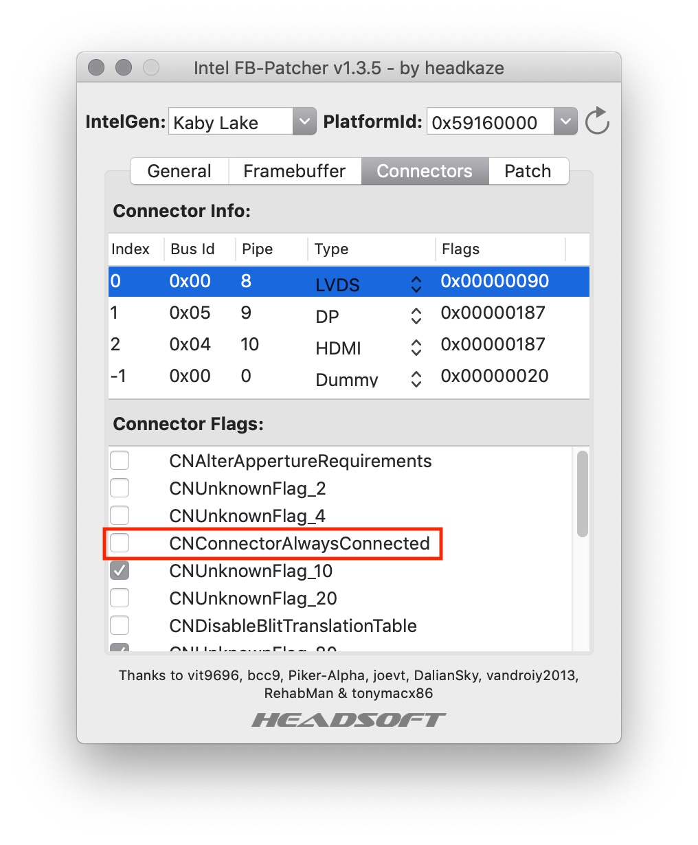

Still seem to be having the same issue. Tried the usual 0x59160000 and 0x591B0000. Using the lated 1.3.5 FBPatcher. Still locks at IOScreenLockState. :blink:
1 hour ago, tikizondo94 said:
Does this look correct? I added the CNConnectorAlwaysConnected flag to "off". Plist attached
config.plist.zip
Yes that does look correct. Just a few other things to note:
- Don't rename GFX0 -> IGPU (WEG does this)
- Try setting Graphics/EDID/Inject=true / ProductID=0x9c7c
- Only set ProductName / BoardSerialNumber / SerialNumber / SmUUID in SMBIOS
- Remove RtVariables/MLB / ROM
- Remove KextsToPatch/minStolenSize patch
- Maybe try SMBIOS/ProductName/MacBookPro14,2 or others?
- If you're sure you've changed your DVMT pre-alloc to 64 MB or higher in BIOS don't use the "DVMT pre-alloc 32 MB" patch
- Make sure you don't have any custom kexts in /L/E and /S/L/E (sort files by date to make it easier to find any)
- Remove all files from CLOVER/ACPI/patched
- Run "sudo kextcache -i /" from Terminal to rebuild your kext cache
Now if all that fails I think you need to experiment with your connectors. Try changing the Type of connector 0 first. Then maybe try different Index / Bus Id / Pipe / Type / Flags values. It's a lot trial and error and rebooting but you may find a setting that works for you. I would also search the forums for similar configs and see if anyone has a patch that worked for them.
I've also seen patches that change the order of connectors. There is a new patch method called "AllData" in the latest WEG that can make it easier to do a patch like this. It's also an option in the latest Intel FB-Patcher.
Eg.
Key: framebuffer-con0-alldata
Value: <01050900 00080000 c7010000 02040a00 00040000 c7010000 03060a00 00040000 c7010000 00000800 02000000 98000000>
I personally don't have any experience changing the order of connectors but it's something some configs require.

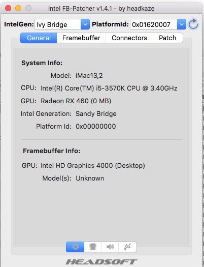

Hi, the first (info screen) shows sandy bridge CPU generation, but should be ivy bridge i think. I tried older version ( 6-8 weeks agao) and i think there was shown correct cpu gen for my i5-3570K.  Platform-ID (by clover)is like shown in the upper right select box. But in system info 00000.
From where  / How get the app the System Info data?
Same here with latest and old version :cry:
