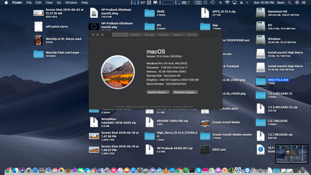

rob88v Posted June 11, 2018 Share Posted June 11, 2018 Testing Mojave 10.14 on my HP Probook 4540s everything works with the exception of sound at the moment. If anyone has gotten sound to work in Mojave yet I would love to know how to get it going on the laptop for testing. Link to comment https://www.insanelymac.com/forum/topic/334898-pre-release-macos-mojave/page/25/#findComment-2618390 Share on other sites More sharing options...
Sherlocks Posted June 11, 2018 Share Posted June 11, 2018 Testing Mojave 10.14 on my HP Probook 4540s everything works with the exception of sound at the moment. If anyone has gotten sound to work in Mojave yet I would love to know how to get it going on the laptop for testing.need to change layout. can you tell me create install media app? where does it get this app? has this app GUI? 나의 LG-F800S 의 Tapatalk에서 보냄 Link to comment https://www.insanelymac.com/forum/topic/334898-pre-release-macos-mojave/page/25/#findComment-2618392 Share on other sites More sharing options...

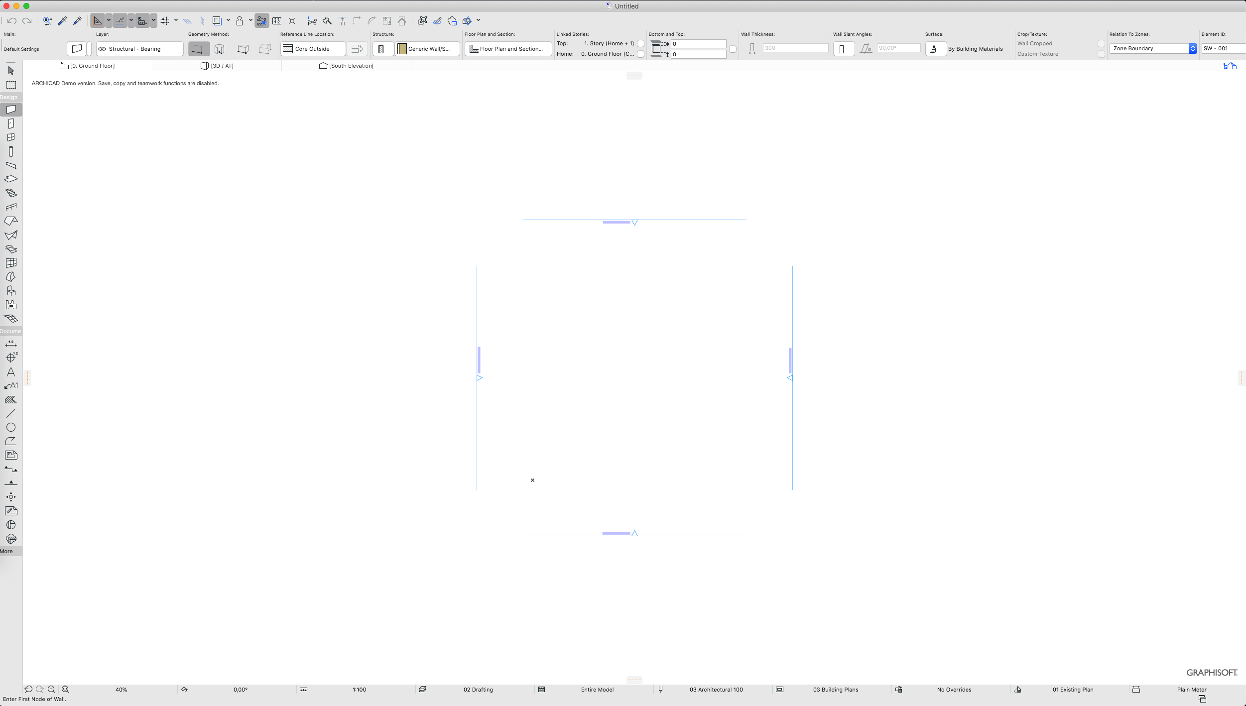

surfinchina Posted June 11, 2018 Share Posted June 11, 2018 59 minutes ago, WarDoc said: works here You tried Archicad? Link to comment https://www.insanelymac.com/forum/topic/334898-pre-release-macos-mojave/page/25/#findComment-2618407 Share on other sites More sharing options...

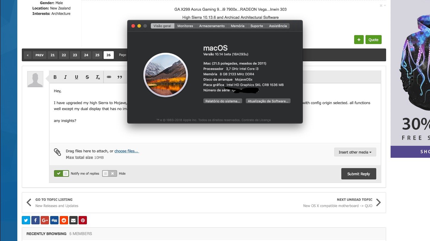

demos41 Posted June 11, 2018 Share Posted June 11, 2018 Hey, I have upgraded my high Sierra to Mojave, although I am unable to boot from drive, have installed clover, but no boot. I can only boot from usb with config origin selected. all functions well except my dual display that has no image. dp. any insights? Link to comment https://www.insanelymac.com/forum/topic/334898-pre-release-macos-mojave/page/25/#findComment-2618415 Share on other sites More sharing options...
arsradu Posted June 11, 2018 Share Posted June 11, 2018 (edited) 2 hours ago, surfinchina said: You tried Archicad? Works here, as well. I mean, I don't know what exactly are you trying to do...maybe there is a specific scenario in which it doesn't work, but...it does open up fine. Which version did you try? Maybe they already released an update...and all you need is to install it? Would be too easy, I know. :)) But...who knows. Maybe it's stupid little things like these that we don't pay attention to, that cause the biggest troubles. I'm just saying. It's worth double checking. Also, did you make a clean install of Mojave? Also, does ArchiCAD use Java....? If so...is it installed? I'm not sure what you should see in Demo mode... Never used this software before. Looks like a pretty graphics intensive one (which makes perfect sense considering its purpose). But anyway, as I said, it does open up just fine. Edited June 11, 2018 by arsradu Link to comment https://www.insanelymac.com/forum/topic/334898-pre-release-macos-mojave/page/25/#findComment-2618423 Share on other sites More sharing options...

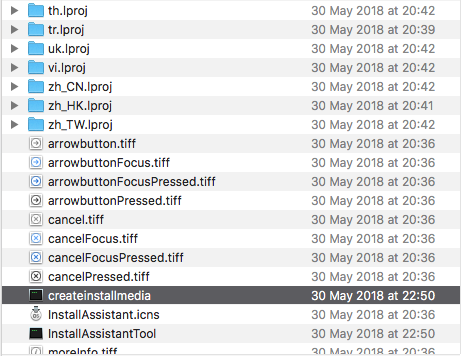

SavageAUS Posted June 11, 2018 Share Posted June 11, 2018 Testing Mojave 10.14 on my HP Probook 4540s everything works with the exception of sound at the moment. If anyone has gotten sound to work in Mojave yet I would love to know how to get it going on the laptop for testing.What is and where did you get the create install media app?Sent from my SM-G930F using Tapatalk Link to comment https://www.insanelymac.com/forum/topic/334898-pre-release-macos-mojave/page/25/#findComment-2618435 Share on other sites More sharing options...
surfinchina Posted June 11, 2018 Share Posted June 11, 2018 (edited) 1 hour ago, arsradu said: Works here, as well. I mean, I don't know what exactly are you trying to do...maybe there is a specific scenario in which it doesn't work, but...it does open up fine. Which version did you try? Maybe they already released an update...and all you need is to install it? Would be too easy, I know. :)) But...who knows. Maybe it's stupid little things like these that we don't pay attention to, that cause the biggest troubles. I'm just saying. It's worth double checking. Also, did you make a clean install of Mojave? Also, does ArchiCAD use Java....? If so...is it installed? I'm not sure what you should see in Demo mode... Never used this software before. Looks like a pretty graphics intensive one (which makes perfect sense considering its purpose). But anyway, as I said, it does open up just fine. Hey thanks for taking the time to load it!! Yeah it opens fine for me too but trying to actually draw a wall or anything results in endless spinning wheels. I've just wiped my mojave and did a fresh install on a formatted SSD then a fresh install of Archicad (the latest version), but still bad. I'll double check the java. Thanks again man, I appreciate your help. edit: Java is installed and seems ok. Hard to say if it's working fine or not I'm not really bothered and I'm sure it'll get fixed. I'll put the mojave desktop on the HS for now and probably not even notice it's not Mojave haha. Edited June 11, 2018 by surfinchina Link to comment https://www.insanelymac.com/forum/topic/334898-pre-release-macos-mojave/page/25/#findComment-2618436 Share on other sites More sharing options...
demos41 Posted June 11, 2018 Share Posted June 11, 2018 (edited) clover 4515 in first topic does not boot my disk, any way to make ssd bootable?, can only good from pen used to have apple file in my clover, not anymore? can't even mount volume Mojave is on Edited June 11, 2018 by demos41 Link to comment https://www.insanelymac.com/forum/topic/334898-pre-release-macos-mojave/page/25/#findComment-2618438 Share on other sites More sharing options...
arsradu Posted June 11, 2018 Share Posted June 11, 2018 (edited) 26 minutes ago, surfinchina said: Hey thanks for taking the time to load it!! Yeah it opens fine for me too but trying to actually draw a wall or anything results in endless spinning wheels. I've just wiped my mojave and did a fresh install on a formatted SSD then a fresh install of Archicad (the latest version), but still bad. I'll double check the java. Thanks again man, I appreciate your help. edit: Java is installed and seems ok. Hard to say if it's working fine or not I'm not really bothered and I'm sure it'll get fixed. I'll put the mojave desktop on the HS for now and probably not even notice it's not Mojave haha. It's actually the same for me with Adobe Lightroom. It's not endless spinning wheel. But it is very, very slow. Doing anything, moving any slider is laggy. And it is kind of annoying to use. It makes actually getting some work done pretty hard and frustrating. But hey, I didn't expect it to run smoothly from the very beginning.:)) And especially on a BETA. :))) So, yeah, I'm pretty happy that it actually runs. And, as I said before, and as the actual OS warns about (at least in my case), some apps are not yet optimised. This will most likely be fixed in the future. Glad I could help! Took a while to download and install that software (at least on my rig). :))) I'm glad it wasn't for nothing. Edited June 11, 2018 by arsradu 1 Link to comment https://www.insanelymac.com/forum/topic/334898-pre-release-macos-mojave/page/25/#findComment-2618440 Share on other sites More sharing options...
arsradu Posted June 11, 2018 Share Posted June 11, 2018 (edited) 46 minutes ago, SavageAUS said: What is and where did you get the create install media app? Sent from my SM-G930F using Tapatalk Createinstallmedia is not an app. It's a component of the MacOS installer found in /Content/Resources/. And it is used to create USB installation media (such as a bootable USB drive). Download the MacOS 10.14 app from the App Store. Open up Terminal, and do this: sudo /Applications/Install\ macOS\ 10.14\ Beta.app/Contents/Resources/createinstallmedia --volume /Volumes/Untitled This assumes that your USB drive is called Untitled, which is the default name. If that's not the case for you, make sure you adjust the name in the command above. That should create a USB drive for you. You can use the Clover installation of your HDD/SSD if you already have Clover installed. Or, you can try to install Clover on the actual USB driver, to make that one bootable, as well. Though I had issues with this method in the past (it's probably been fixed since then, but anyway). So I usually prefer to keep my USB installers intact, and use the Clover installation on my SSD to boot it. It will use that for future reboots anyway, after copying the installation files to the HDD/SSD. Edited June 11, 2018 by arsradu Link to comment https://www.insanelymac.com/forum/topic/334898-pre-release-macos-mojave/page/25/#findComment-2618446 Share on other sites More sharing options...
SavageAUS Posted June 11, 2018 Share Posted June 11, 2018 (edited) 3 minutes ago, arsradu said: Createinstallmedia is not an app. It's a component of the MacOS installer. And it is used to create USB installation media (such as a bootable USB drive). Download the MacOS 10.14 app from the App Store. Open up Terminal, and do this: sudo /Applications/Install\ macOS\ 10.14\ Beta.app/Contents/Resources/createinstallmedia --volume /Volumes/Untitled This assumes that your USB drive is called Untitled, which is the default name. If that's not the case for you, make sure you adjust the name in the command above. That should create a USB drive for you. You can use the Clover installation of your HDD/SSD if you already have Clover installed. Or, you can try to install Clover on the actual USB driver, to make that one bootable, as well. Though I had issues with this method in the past (it's probably been fixed since then, but anyway). So I usually prefer to keep my USB installers intact, and use the Clover installation on my SSD to boot it. It will use that for future reboots anyway, after copying the installation files to the HDD/SSD. Yes I am aware of the terminal approach but on the desktop of the image I quoted under the system information screen you will see an iMac icon with createinstallmedia label. Also to anyone else testing Mojave arr you using one of the osxwifi + BT cards? If so does it still work natively in Mojave? As I'm looking at getting one. Edited June 11, 2018 by SavageAUS Link to comment https://www.insanelymac.com/forum/topic/334898-pre-release-macos-mojave/page/25/#findComment-2618447 Share on other sites More sharing options...
arsradu Posted June 11, 2018 Share Posted June 11, 2018 (edited) 12 minutes ago, SavageAUS said: Yes I am aware of the terminal approach but on the desktop of the image I quoted under the system information screen you will see an iMac icon with createinstallmedia label. Also to anyone else testing Mojave arr you using one of the osxwifi + BT cards? If so does it still work natively in Mojave? As I'm looking at getting one. Oh! I see it now. Sorry. I was like...what Create Install Media app? :))) Yeah, you're right. Now I see it too. Though, I have to say, it's the first time I see that app. But...using my detective skills, and googling skills, I determined that it should be this app: https://github.com/chris1111/Create-Install-Media As for your WiFI & BT adapter question, uhm, no, I'm not using something like that. So I can't really advise you on the matter. Though I did think about purchasing one. Not sure how useful would be...for a Desktop PC... I mean, that's pretty much what hold me back from purchasing one in the first place. Edited June 11, 2018 by arsradu Link to comment https://www.insanelymac.com/forum/topic/334898-pre-release-macos-mojave/page/25/#findComment-2618449 Share on other sites More sharing options...
