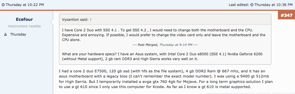

crazybirdy Posted June 11, 2018 Share Posted June 11, 2018 8 minutes ago, ANONIMNIQ said: I'm with a little diferent configuration now, but still old. High Serra works fine. Gigabyte GA-G41M-Combo v2 Intel Core 2 Duo E8400, 3000 MHz 4gb ram Quadro FX 1800 (768 MB) Core 2 Duo E8400 (SSE4.1 only, no SSE4.2) Still the same CPU, the same problem. I didn't find anyone work without SSE4.2 now. Need next lucky beta. Link to comment https://www.insanelymac.com/forum/topic/334898-pre-release-macos-mojave/page/26/#findComment-2618471 Share on other sites More sharing options...

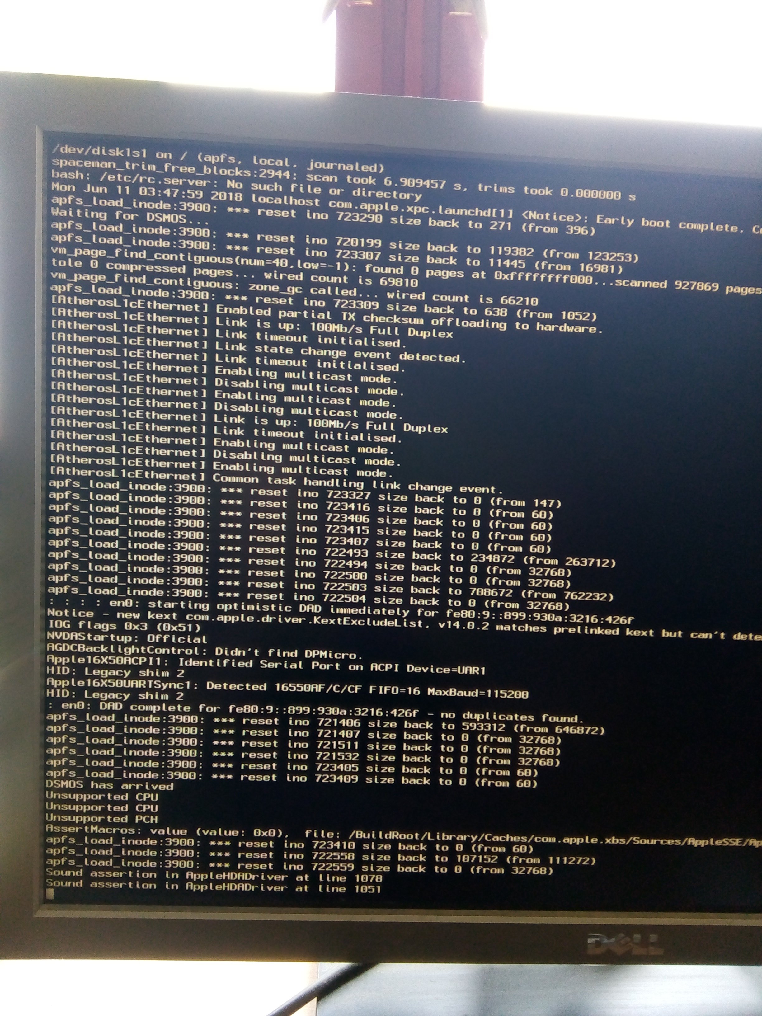

arsradu Posted June 11, 2018 Share Posted June 11, 2018 11 minutes ago, ANONIMNIQ said: Here is screenshot from verbose mode. After this grey screen with cursor appear and PC restarts. I can't access EFI partition on USB drive form Windows, I'm not sure why, should try later from virtual machine and will post my Clover folder. I'm with a little diferent configuration now, but still old. High Serra works fine. Gigabyte GA-G41M-Combo v2 Intel Core 2 Duo E8400, 3000 MHz 4gb ram Quadro FX 1800 (768 MB) Which Clover version are you using? Link to comment https://www.insanelymac.com/forum/topic/334898-pre-release-macos-mojave/page/26/#findComment-2618472 Share on other sites More sharing options...

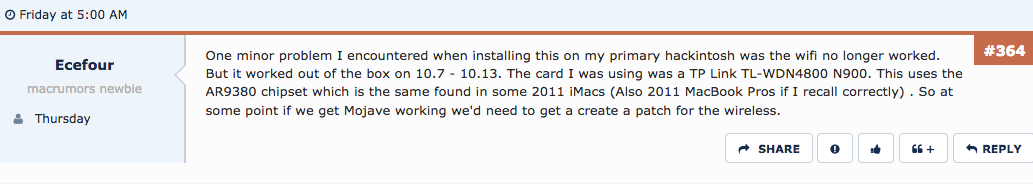

ammoune78 Posted June 11, 2018 Share Posted June 11, 2018 2 hours ago, SavageAUS said: Also to anyone else testing Mojave arr you using one of the osxwifi + BT cards? If so does it still work natively in Mojave? As I'm looking at getting one. For desktop and laptop native support Wifi/Bluetooth Desktop BCM94360CD Laptop BCM94360HMB eBay links Link to comment https://www.insanelymac.com/forum/topic/334898-pre-release-macos-mojave/page/26/#findComment-2618493 Share on other sites More sharing options...
SavageAUS Posted June 11, 2018 Share Posted June 11, 2018 (edited) 54 minutes ago, ammoune78 said: For desktop and laptop native support Wifi/Bluetooth Desktop BCM94360CD Laptop BCM94360HMB eBay links Thanks. I'm hoping they re add support for atheros in Mojave as the first beta dropped Atheros40 <--- i think thats the kext name i re added from high sierra. If they dont add support back for atheros then ill be after WiFi +BT for my desktop but if they do add atheros support back then ill just need native bluetooth support. Sent from my SM-G930F using Tapatalk Edited June 11, 2018 by SavageAUS Link to comment https://www.insanelymac.com/forum/topic/334898-pre-release-macos-mojave/page/26/#findComment-2618494 Share on other sites More sharing options...

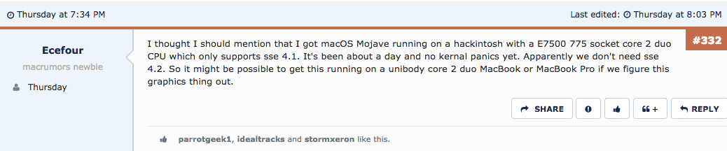

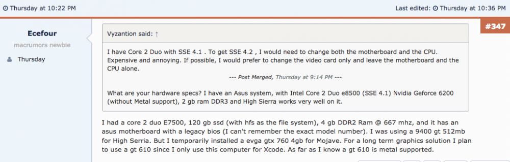

ammoune78 Posted June 11, 2018 Share Posted June 11, 2018 2 hours ago, crazybirdy said: I saw your old post with ASUS P5Q-VM Intel® Core™2 DuoE8400 (6M Cache, 3.00 GHz) 4GB ram NVIDIA Quadro 600 - 1 GB It's the same as mine, Core 2 Duo E8400 (SSE4.1 only, no SSE4.2) + GT 640 1G, after installation success, boot to system restarting on gray screen and mouse. (GPT + APFS, Clover 4522. Works fine with 10.13.6) I think it's the end for SSE4.1 cpu now. Forum Macrumors has confirmed that Core2Due working on Mojave as its shown in the screenshot: Just search on the net, you'll find the fix 1 Link to comment https://www.insanelymac.com/forum/topic/334898-pre-release-macos-mojave/page/26/#findComment-2618495 Share on other sites More sharing options...
ammoune78 Posted June 11, 2018 Share Posted June 11, 2018 11 minutes ago, SavageAUS said: Thanks. I'm hoping they re add support for atheros in Mojave as the first beta dropped Atheros40 Sent from my SM-G930F using Tapatalk Broadcom cards give continuity support, i can receive calls on my laptop hack with Atheros, but missing airplay, airdrop and other things. 1 Link to comment https://www.insanelymac.com/forum/topic/334898-pre-release-macos-mojave/page/26/#findComment-2618497 Share on other sites More sharing options...

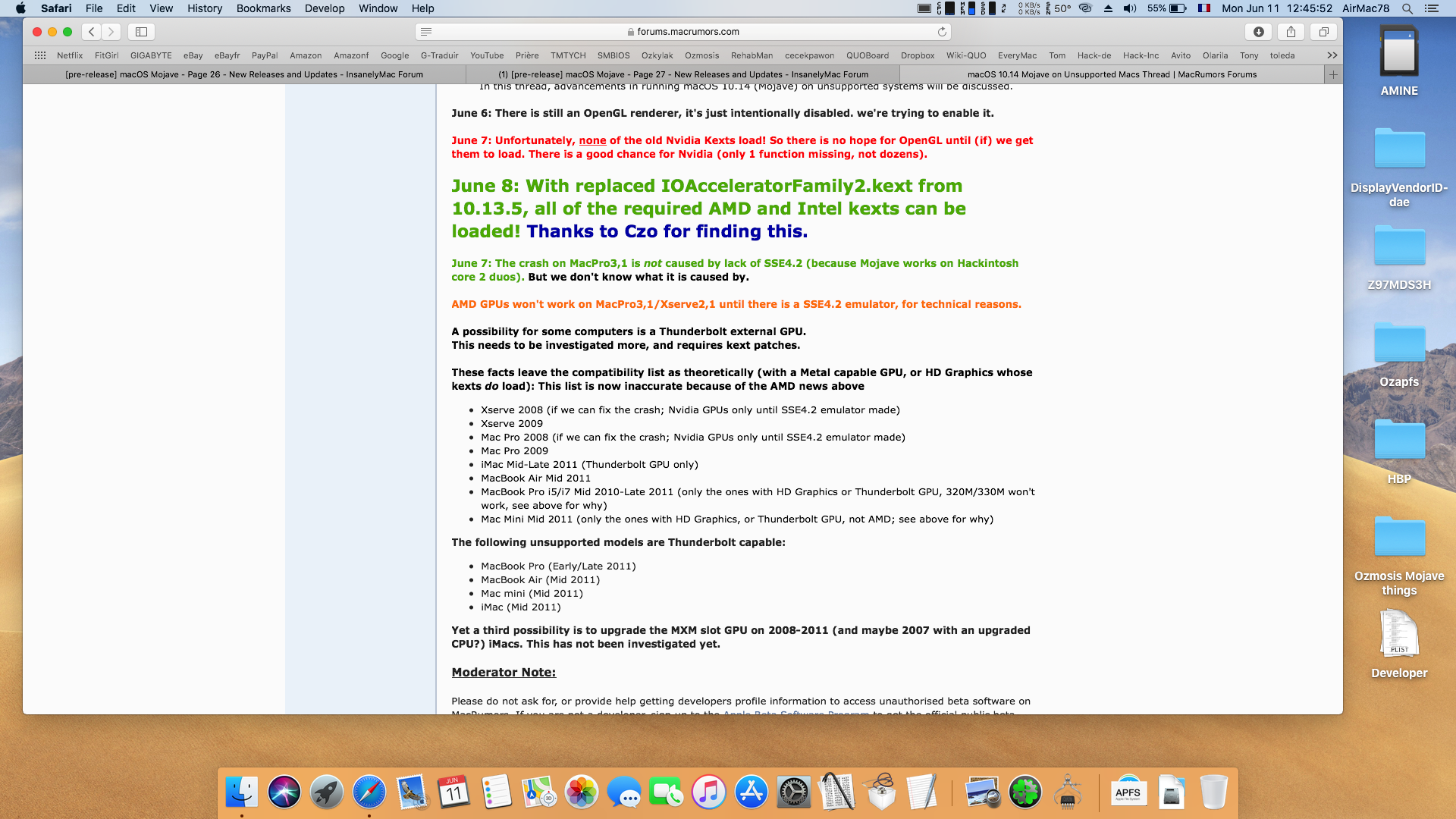

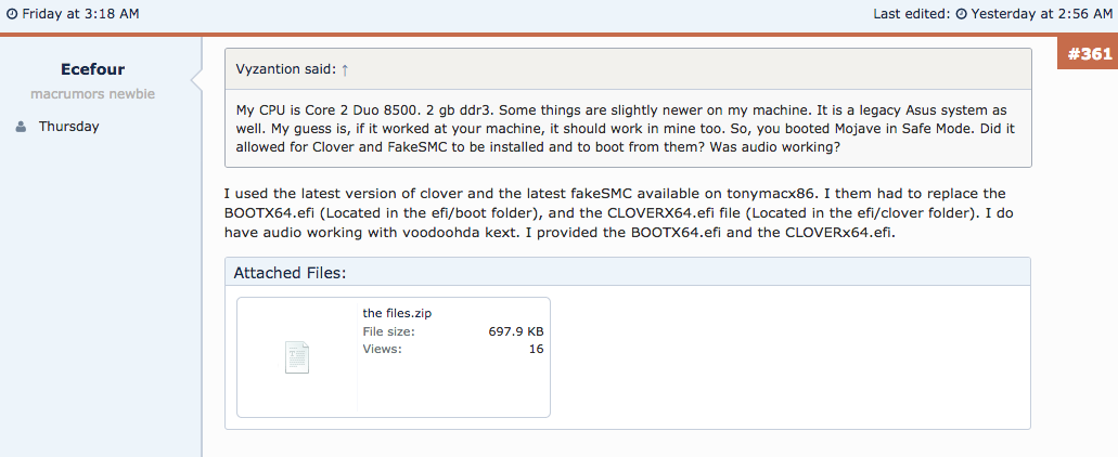

crazybirdy Posted June 11, 2018 Share Posted June 11, 2018 5 minutes ago, ammoune78 said: Forum Macrumors has confirmed that Core2Due working on Mojave as its shown in the screenshot: Just search on the net, you'll find the fix Thanks for your info, I already tried it, found nothing more than above. I'm not sure, it's really boot into the installed Mojave system or not? 1 Link to comment https://www.insanelymac.com/forum/topic/334898-pre-release-macos-mojave/page/26/#findComment-2618499 Share on other sites More sharing options...
ammoune78 Posted June 11, 2018 Share Posted June 11, 2018 I do not have a LGA775 socket components to test it, but you have to review your config.plist and check your DSDT or graphics card, it might be a trick for that! If people not only one user, but users confirmed that it work, then you just have to check or ask for a config.plist that already working! 1 Link to comment https://www.insanelymac.com/forum/topic/334898-pre-release-macos-mojave/page/26/#findComment-2618504 Share on other sites More sharing options...
crazybirdy Posted June 11, 2018 Share Posted June 11, 2018 (edited) 12 minutes ago, ammoune78 said: I do not have a LGA775 socket components to test it, but you have to review your config.plist and check your DSDT or graphics card, it might be a trick for that! If people not only one user, but users confirmed that it work, then you just have to check or ask for a config.plist that already working! It's only one user Ecefer post it work without anything, no more evidence, that's why I'm not sure it's really work or not. Edited June 11, 2018 by crazybirdy 1 Link to comment https://www.insanelymac.com/forum/topic/334898-pre-release-macos-mojave/page/26/#findComment-2618510 Share on other sites More sharing options...
Badruzeus Posted June 11, 2018 Share Posted June 11, 2018 (edited) 58 minutes ago, ammoune78 said: I do not have a LGA775 socket components to test it, but you have to review your config.plist and check your DSDT or graphics card, it might be a trick for that! If people not only one user, but users confirmed that it work, then you just have to check or ask for a config.plist that already working! Not sure if there's difference between real mac and hackintosh Pc on this case. This reminds me when got same issue installing Sierra some years back on my MBP2009 with Core2Duo. It got succeeded with dosdude1 patcher, but no luck using it on pc with similar cpu. Later on, after 10.12 finally released, It worked well with same config. Edited June 11, 2018 by Badruzeus Link to comment https://www.insanelymac.com/forum/topic/334898-pre-release-macos-mojave/page/26/#findComment-2618514 Share on other sites More sharing options...
ammoune78 Posted June 11, 2018 Share Posted June 11, 2018 (edited) 13 minutes ago, crazybirdy said: It's only one user Ecefer post it work without anything, no more evidence, that's why I'm not sure it's really work or not. Have you did this to bypass compatibility check, like dear fusion71au said? 12 hours ago, fusion71au said: You can clean install Mojave beta on an HFS partition with a patched OSInstall.mpkg (this starts core.pkg installation) ---> bypasses compatibility checks. See post#258 in macrumors unsupported macs thread, credit to @foxlet. After the package installer completes, copy boot.efi (from "Misc Files.zip" attachment or extract yourself from BaseSystem.dmg with Pacifist) to /S/L/CoreServices of the Mojave volume, and copy SeedEnrollment.plist file into the /Users/Shared folder with the "." prefix so it becomes a hidden system file eg if SeedEnrollment.plist is in your ~/Downloads folder, use the terminal command cp ~/Downloads/SeedEnrollment.plist /Volumes/Mojave/Users/Shared/.SeedEnrollment.plist Good Luck Misc Files.zip It might work Edited June 11, 2018 by ammoune78 1 Link to comment https://www.insanelymac.com/forum/topic/334898-pre-release-macos-mojave/page/26/#findComment-2618516 Share on other sites More sharing options...
crazybirdy Posted June 11, 2018 Share Posted June 11, 2018 (edited) 18 minutes ago, ammoune78 said: Have you did this to bypass compatibility check? It might work The compatibility check is only for installation. Compatibility is not a issue. I can boot to installation screen, and install Mojave as GPT+APFS, or GPT+HFS+J, or MBR+HFS+J successful. (will not convert to APFS.) My problem is, After installation finished, it can not boot into the installed Mojave system with all the three types above. I think, it's E8400 without SSE4.2 issue. I can't figure out why Ecefer said it works with E7500? I already ask for his config.plist, not reply yet. I think we need more info. how Ecefer made it worked? Edited June 11, 2018 by crazybirdy 1 Link to comment https://www.insanelymac.com/forum/topic/334898-pre-release-macos-mojave/page/26/#findComment-2618523 Share on other sites More sharing options...

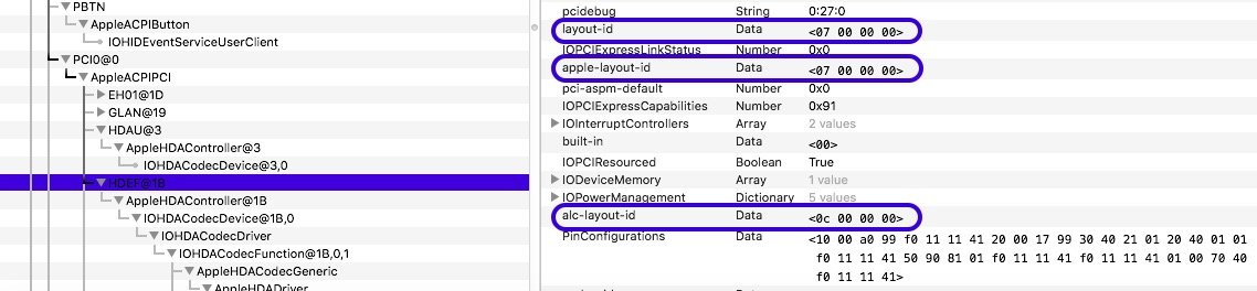

wern apfel Posted June 11, 2018 Share Posted June 11, 2018 On 6/9/2018 at 7:37 PM, ammoune78 said: It finally should end up with something like that: The thing going bad in he's HDEF patch is merging apple-layout-id with alc-layout-id, but instead of doing that he only need to put alc-layout-id. With the AppleALC I attached on my previous post, it works without any changes except the boot arguments. 1 Link to comment https://www.insanelymac.com/forum/topic/334898-pre-release-macos-mojave/page/26/#findComment-2618531 Share on other sites More sharing options...

ammoune78 Posted June 11, 2018 Share Posted June 11, 2018 2 minutes ago, wern apfel said: With the AppleALC I attached on my previous post, it works without any changes except the boot arguments. Yes, but not for all codecs for sure, i've tried all the things, so here's the conclusion for my codec to work: 1- use only VoodooHDA, so the audio just work fine, but Guitar Rig no. 2- use AppleALC from high sierra just work fine 3- use the last AppleALC from @arsradu post, using alc-layout-id in DSDT and putting -alcbeta -lilubeta But from time to time when i boot using AppleALC all versions, i get audio grayed, so i have to shutdown the laptop, remove the battery, power on it, and work again for a while! Link to comment https://www.insanelymac.com/forum/topic/334898-pre-release-macos-mojave/page/26/#findComment-2618533 Share on other sites More sharing options...
wern apfel Posted June 11, 2018 Share Posted June 11, 2018 On 6/9/2018 at 8:32 PM, abdouoi said: @wern apfel @ammoune78 Thanks guys it is now working except for the microphone. Here is the new ioreg ioreg_2.ioreg The ioreg looks good and it should work as before. Link to comment https://www.insanelymac.com/forum/topic/334898-pre-release-macos-mojave/page/26/#findComment-2618537 Share on other sites More sharing options...

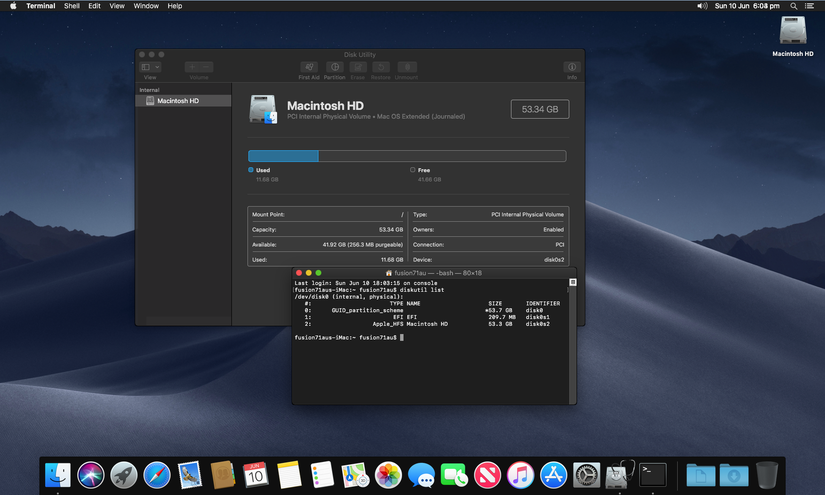

crazybirdy Posted June 11, 2018 Share Posted June 11, 2018 49 minutes ago, Dragster27 said: There's one weird thing tho... I installed it in an external USB hard drive... in one occasion I rebooted the machine and the Mojave partition was gone... not sure if there's a problem with APFS... I had to reinstall the OS. Only Sierra 10.12+ support APFS to view it. El Capitan didn't support APFS, can't see it, unless you install Mojave as HFS+J with MBR patch method (will not convert HFS+j to APFS). 1 Link to comment https://www.insanelymac.com/forum/topic/334898-pre-release-macos-mojave/page/26/#findComment-2618545 Share on other sites More sharing options...
