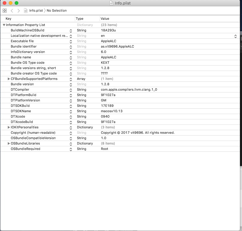

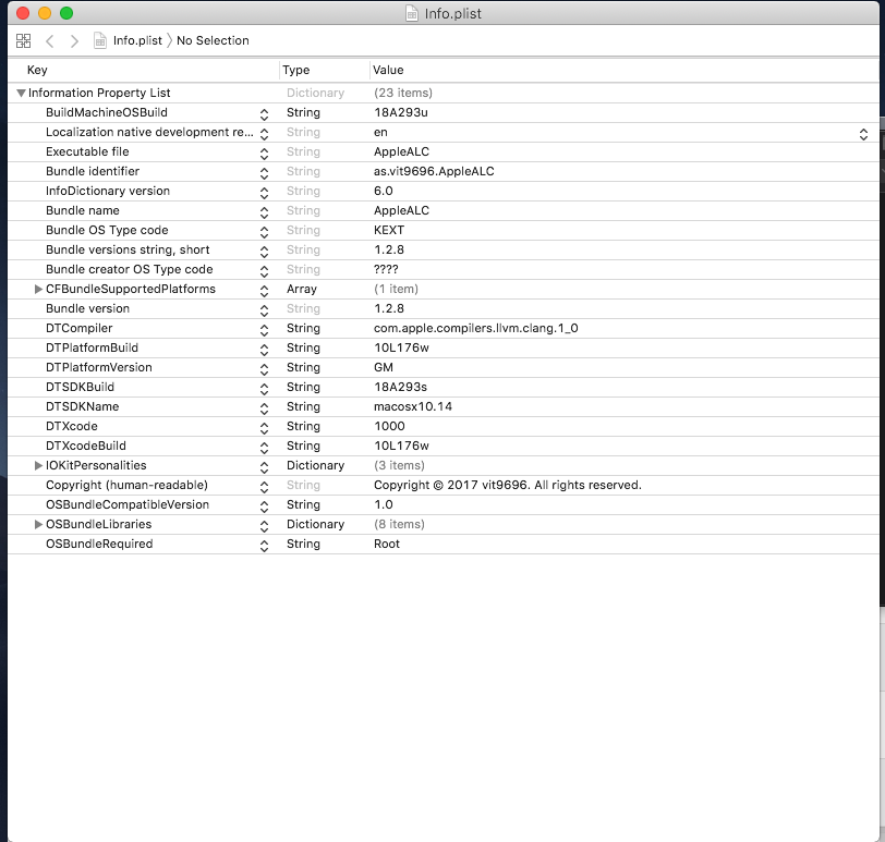

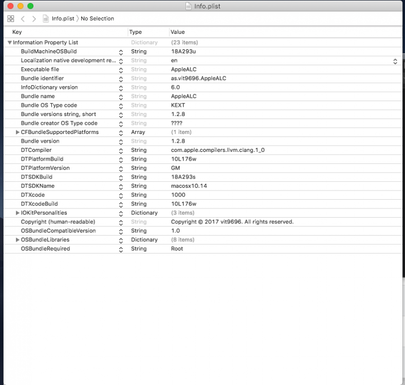

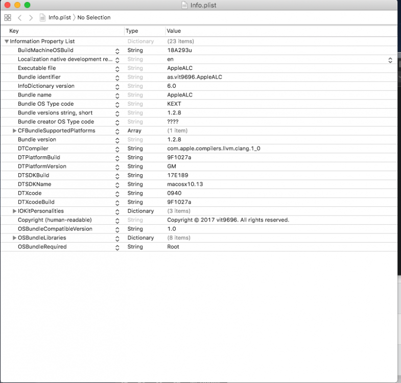

Pavo Posted June 11, 2018 Share Posted June 11, 2018 (edited) 24 minutes ago, MorenoAv said: You are right Pavo, the bootflag that I have is -lilubetaall, and it doesn't work... Are you using latest AppleALC v1.2.8? You might have to use latest Lilu also, here are both freshly compiled. AppleALC.kext.zip Lilu.kext.zip Edited June 11, 2018 by Pavo 1 Link to comment https://www.insanelymac.com/forum/topic/334898-pre-release-macos-mojave/page/28/#findComment-2618658 Share on other sites More sharing options...
MorenoAv Posted June 11, 2018 Share Posted June 11, 2018 (edited) 27 minutes ago, Pavo said: Are you using latest AppleALC v1.2.8? Yes I am... Edited June 11, 2018 by MorenoAv Link to comment https://www.insanelymac.com/forum/topic/334898-pre-release-macos-mojave/page/28/#findComment-2618659 Share on other sites More sharing options...

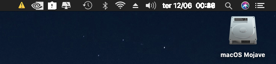

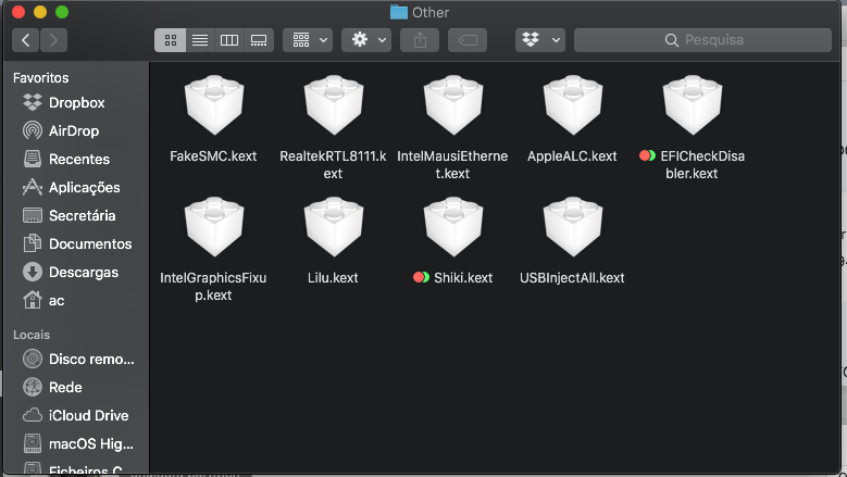

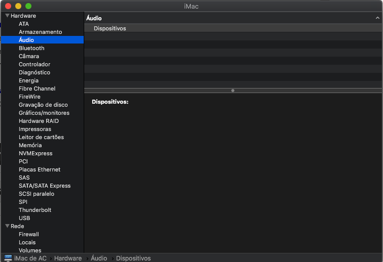

MorenoAv Posted June 11, 2018 Share Posted June 11, 2018 I have updated the kexts that you provided and nothing has changed, as you can see... Link to comment https://www.insanelymac.com/forum/topic/334898-pre-release-macos-mojave/page/28/#findComment-2618662 Share on other sites More sharing options...
Pavo Posted June 11, 2018 Share Posted June 11, 2018 1 minute ago, MorenoAv said: I have updated the kexts that you provided and nothing has changed, as you can see... upload your EFI folder please Link to comment https://www.insanelymac.com/forum/topic/334898-pre-release-macos-mojave/page/28/#findComment-2618663 Share on other sites More sharing options...
SavageAUS Posted June 11, 2018 Share Posted June 11, 2018 I have updated the kexts that you provided and nothing has changed, as you can seeDo you have any rogue audio kexts in /System/Library/Extensions or /Library/Extensions ?Sent from my SM-G930F using Tapatalk Link to comment https://www.insanelymac.com/forum/topic/334898-pre-release-macos-mojave/page/28/#findComment-2618664 Share on other sites More sharing options...
MorenoAv Posted June 11, 2018 Share Posted June 11, 2018 1 minute ago, Pavo said: upload your EFI folder please oks it's here... And I don't think so, SavageAus ... EFI.zip Link to comment https://www.insanelymac.com/forum/topic/334898-pre-release-macos-mojave/page/28/#findComment-2618666 Share on other sites More sharing options...

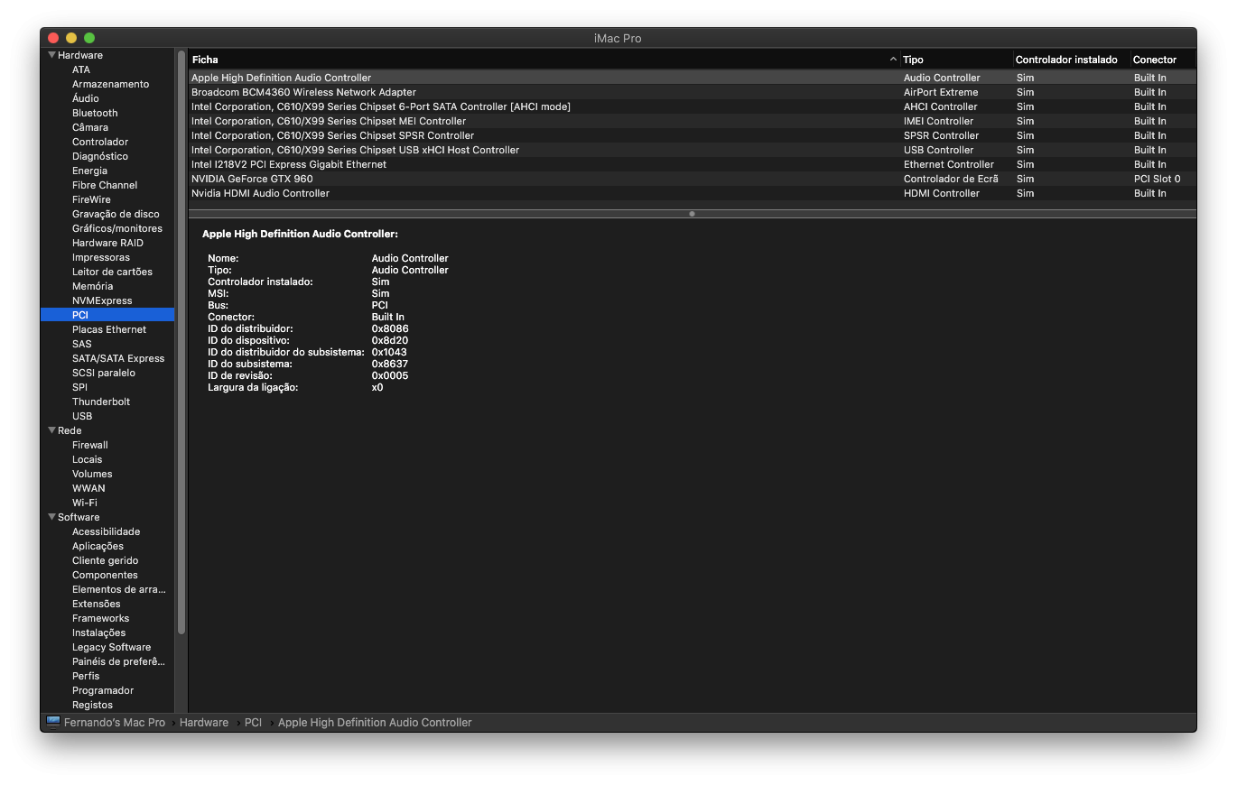

Pavo Posted June 11, 2018 Share Posted June 11, 2018 11 minutes ago, MorenoAv said: oks it's here... And I don't think so, SavageAus ... EFI.zip Well from what I can tell you are using the wrong layout-id, your GA-Z97N-WiFi mojo has Realtek® ALC892 codec and AppleALC codec list says to use the following layout-ids: Realtek ALC892 layout 1, 2, 3, (4 for laptop), 5, 7, 28, 31, 92, 98, 99 And its also best to use a SSDT to set the new all-layout-id instead of using Clover to inject the id. SSDT-HDEF.aml Link to comment https://www.insanelymac.com/forum/topic/334898-pre-release-macos-mojave/page/28/#findComment-2618668 Share on other sites More sharing options...

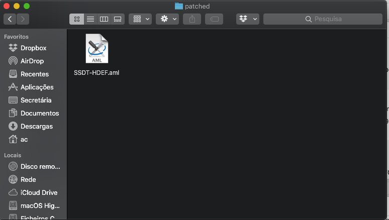

MorenoAv Posted June 11, 2018 Share Posted June 11, 2018 ok the ssdt is put in the acpi patched, correct? Link to comment https://www.insanelymac.com/forum/topic/334898-pre-release-macos-mojave/page/28/#findComment-2618669 Share on other sites More sharing options...
Pavo Posted June 11, 2018 Share Posted June 11, 2018 8 minutes ago, MorenoAv said: ok the ssdt is put in the acpi patched, correct? Yes Link to comment https://www.insanelymac.com/forum/topic/334898-pre-release-macos-mojave/page/28/#findComment-2618672 Share on other sites More sharing options...

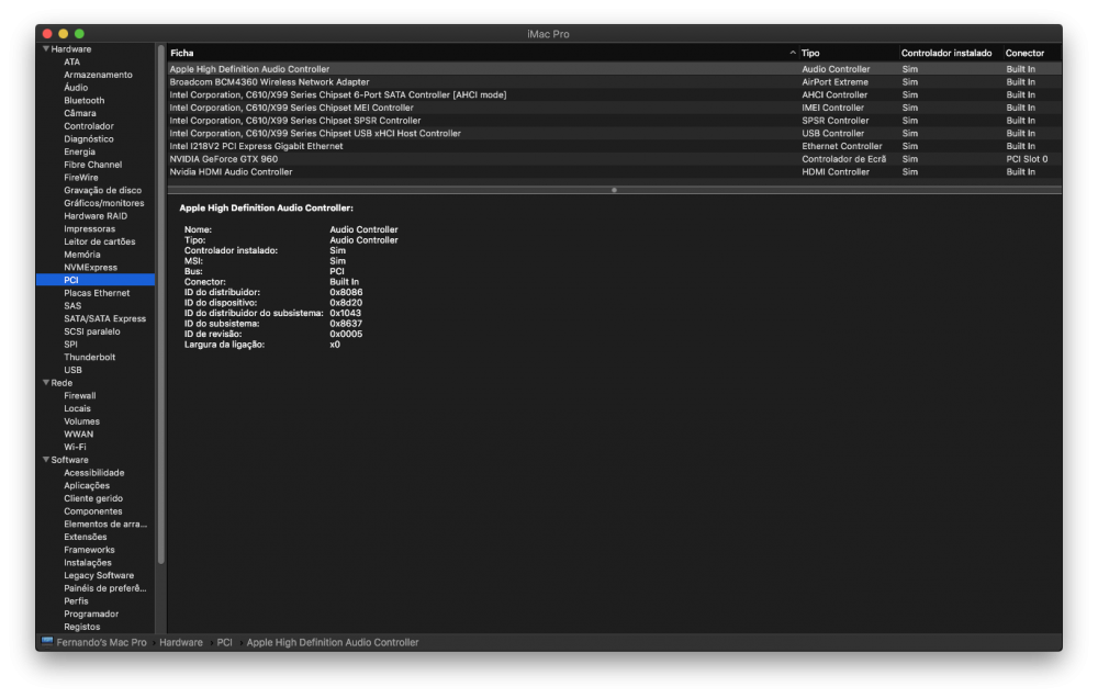

Fergarth Posted June 11, 2018 Share Posted June 11, 2018 (edited) Okay as I anticipated, sooner or later I would be able to install Mojave on my X-99. Everything works fine, except the XCPM speedsteps ... anyone who can give a hand? EIST enable or not? Plugin Type in plist or not? I think my DSDT already has the plugin type included... Edited June 11, 2018 by Fergarth Link to comment https://www.insanelymac.com/forum/topic/334898-pre-release-macos-mojave/page/28/#findComment-2618674 Share on other sites More sharing options...

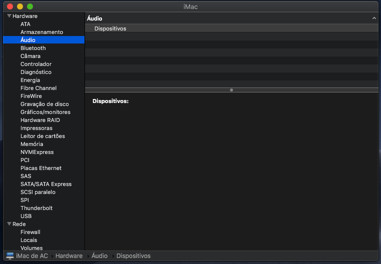

MorenoAv Posted June 11, 2018 Share Posted June 11, 2018 And after the SSDT-HDEF.aml, nothing... all is equal I have no audio devices Link to comment https://www.insanelymac.com/forum/topic/334898-pre-release-macos-mojave/page/28/#findComment-2618675 Share on other sites More sharing options...
ammoune78 Posted June 11, 2018 Share Posted June 11, 2018 Just now, MorenoAv said: I have no audio devices Remove 11 from Devices=>Audio in config.plist Link to comment https://www.insanelymac.com/forum/topic/334898-pre-release-macos-mojave/page/28/#findComment-2618676 Share on other sites More sharing options...
MorenoAv Posted June 11, 2018 Share Posted June 11, 2018 hi ammoune78, I have already removed the 11 from devices... Link to comment https://www.insanelymac.com/forum/topic/334898-pre-release-macos-mojave/page/28/#findComment-2618677 Share on other sites More sharing options...

MorenoAv Posted June 12, 2018 Share Posted June 12, 2018 I have that also, fresh compiled by Pavo, and a fresh lilu also compiled by Pavo and an SSDT-HDEF.aml and yet still nothing... Thanks Link to comment https://www.insanelymac.com/forum/topic/334898-pre-release-macos-mojave/page/28/#findComment-2618680 Share on other sites More sharing options...
ammoune78 Posted June 12, 2018 Share Posted June 12, 2018 This one is v2 compiled by @arsradu, and is the only one that worked for me, try and then report if not worked Link to comment https://www.insanelymac.com/forum/topic/334898-pre-release-macos-mojave/page/28/#findComment-2618681 Share on other sites More sharing options...
MorenoAv Posted June 12, 2018 Share Posted June 12, 2018 (edited) Replaced the kext from Pavo with yours and still is a no go... no audio devices... grrrrrrr But thanks anyway ammoune78 Edited June 12, 2018 by MorenoAv Link to comment https://www.insanelymac.com/forum/topic/334898-pre-release-macos-mojave/page/28/#findComment-2618685 Share on other sites More sharing options...
