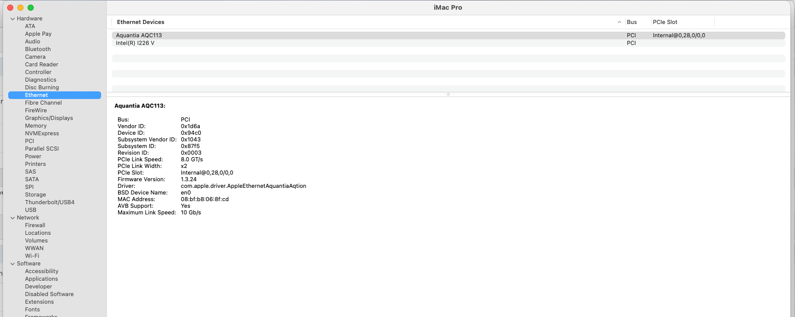

Cyberdevs Posted June 26, 2023 Share Posted June 26, 2023 2 minutes ago, surenmunoo said: Yes, I have that as well, should i turn that off when enabling the patch? What is the device ID on for your 10GB? I'm using the SSDT and only ForceAquantiaEthernet quirk and mine works just fine. My device ID is 94c0 Link to comment Share on other sites More sharing options...

surenmunoo Posted June 27, 2023 Share Posted June 27, 2023 (edited) 4 hours ago, Cyberdevs said: What is the device ID on for your 10GB? I'm using the SSDT and only ForceAquantiaEthernet quirk and mine works just fine. My device ID is 94c0 see below for device ID Edited June 27, 2023 by surenmunoo Link to comment Share on other sites More sharing options...
Cyberdevs Posted June 27, 2023 Share Posted June 27, 2023 6 hours ago, surenmunoo said: Yes, I have that as well, should i turn that off when enabling the patch? The only thing that needs to be enabled is the ForceAquantiaEthernet quirk and the SSDT nothing else needs to be enabled which patch are you talking about? Link to comment Share on other sites More sharing options...
