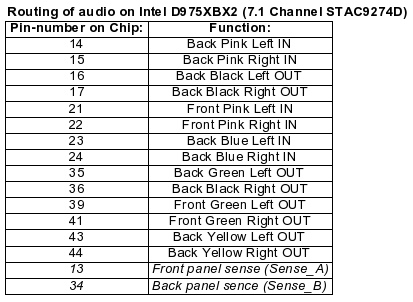

zapro Posted April 5, 2007 Share Posted April 5, 2007 I have made a dump of my STAC9274D codec in Ubuntu, and have used the 1.13 Patcher, all went well, i have: Optical out (Unconfirmed) Line Out (Working on both back and front panel simultaneously) Mic in (NOT working!) As i can see, various motherboards have the plugs routed differently to the sound-chip. I have traced all the connections on my BadAxe2 with the Sigmatel STAC9274D-codec. I attach the pinout here so the driver-wizards hopefully can help me and others, as this will be the next top-mainboard i think. I, personally just want Microphone in, nothing else. Even line-out i could do without as i have connected a HiFi USB-card. Regards, Per. Link to comment https://www.insanelymac.com/forum/topic/32859-applehda-solution-work-in-progress/page/64/#findComment-340180 Share on other sites More sharing options...
