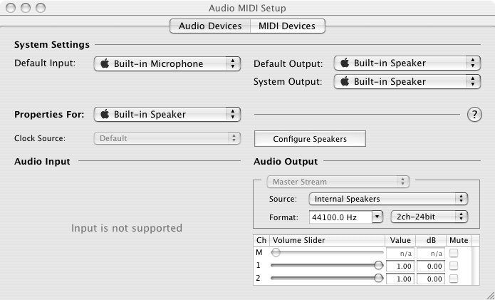

d@mian Posted March 29, 2007 Share Posted March 29, 2007 i tried all versions.The v10, v11, v12, v13 versions resulted the same. Recognized sound card element, but no sound. The itunes play musc, but can't hear a thing... ( i have very clear sound under windows...) any ideas? I read somewhere here, which worked for my D865PERL board before upgrading to my D975XBX2 board , was to adjust the Midi setup in Apps > Utilities (see attached image). Make sure the Output properties are set for Built-in Speaker. You may list more than one entry, so choose the one that enables the Configure Speakers button and the Audio Output source shows Internal Speakers. This should allow you to set the speaker port mappings for your setup using the Configure Speakers. I remember the defaults for my D865PERL board was Left=1 and Right=2, which didn't work. So I tried several combinations and I believe Left=3 and Right=6 worked for me. I think it has something to do with the way the HDAudio maps to the audio ports for the different chips and/or drivers. Hope this helps... d@mian Link to comment https://www.insanelymac.com/forum/topic/32859-applehda-solution-work-in-progress/page/63/#findComment-335197 Share on other sites More sharing options...
