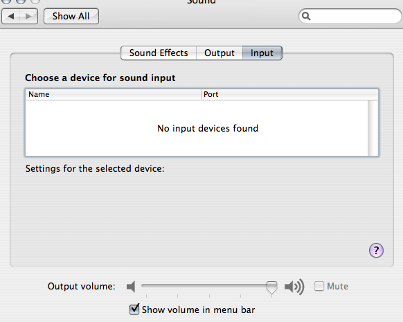

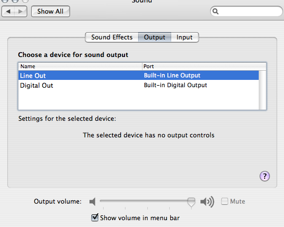

On my asus p5ld2 se i can enable sound with your patch 1.13 & standart dump from psycopat.
after restarting i run systempreferenses->sound & select line-out and i hear my iTunes music ))))
to all - select line out.
But :(
None Line-in
None Mic
None selected sound volume - only max volume
i have mifki/daemon kernel
i eshe - esli zdec ect ruskie - perevedite emu 4to zvuk nemnogo sret i kolbasit, hotia eto moget bit iz-za togo 4to on na maximume rabotaet, no vse ravno perevedite.

Taruga you are great man.
But :tomato:
None Line-in
None Mic

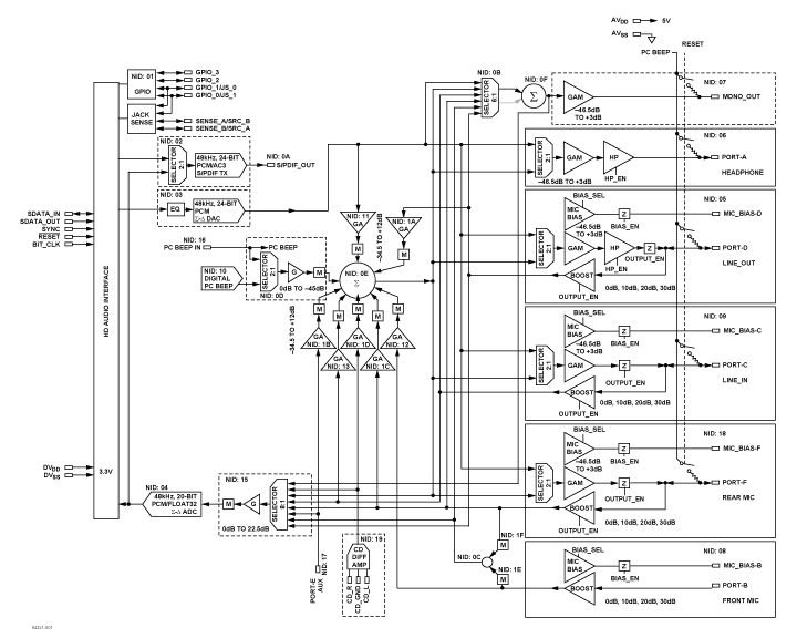

Hi out there.
Well, i studied the image attached, which is the description of the AD1981HD nodes and i conclude the followings:
There are two possible pathmaps:
6 Headphones/LineOut
3 Out
or
14 Mixer
17 Selector
3 Out
The problem is i don't know how to lay out the pathmap. I first tested with the first configuration, that means leaving only node 6 and 3 without any further info but it didn't work.
I don't know how to layout the other pathmap.
Best regards
Juanpepe
ad1981hd.txt

Hi out there. Well, i studied the image attached, which is the description of the AD1981HD nodes
In the docs of the Linux source code, I find
patches.drivers/alsa-ad1981hd-all-hp-laptops: Use model "hp" for
 all HP laptops with AD1981HD.
- patches.drivers/alsa-ad1981hd-thinkpad-x60: Add Thinkpad
 X60/T60/Z60 support.
This probably means that HP and Thinkpad versions of the AD1981HD need to be dealt with separately, and here is the corresponding source. http://www.kernelhq.cc/diff-diff.py?v1=247239&v2=253876 It has quite a couple of lines that deal with the HP mute button (apparently the EAPD bit controls the mute button).
