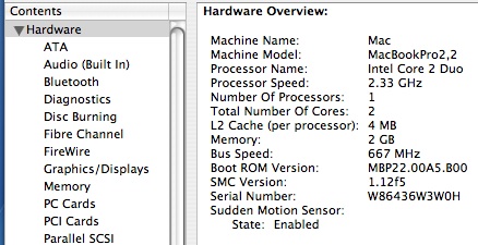

mdg Posted November 14, 2006 Share Posted November 14, 2006 Hey all, good news, I just fixed the Hardware Overview error with 10.4.8 System Profiler New one is linked from my blog now. Worked for me. Now shows Core 2 Duo and even has correct 2.7 (2.705 to be exact, in bios) speed (OC'd E6600 from 2.4 to 2.7). Hardware recognizes 2 CPU's and speed also. The only part that's not recognized is the memory and the speed. It says 2Gb of SDRAM, but I have 2Gb of DDR2 SDRAM. It also gives 0 for speed. I now (also) have a new MacBook Pro with Core 2 Duo 2.33 (a sweet!! machine) and I will tell you that it shows DDR2 SDRAM, and the Hardware overview is different also. It shows total number of CPU's as 1 and total number of Cores as 2. Link to comment https://www.insanelymac.com/forum/topic/32815-about-this-mac-crash-solved-properly/page/3/#findComment-234127 Share on other sites More sharing options...

jaminmc Posted November 15, 2006 Share Posted November 15, 2006 Ok, This has been consuming too much of my time.... I can't get it to work. I have installed the latest AppleSMBIOS.kext and repaired permissions, and put on the latest simteck kernel. I have tried the CPU max enabled and disabled. I have tried the data exclustion enable, and disable. The system profiles seems to be working fine now, but the about this mac crashes finder. Under system profiler, theAppleSMBIOS.kext shows this: AppleSMBIOS: Version: 1.0.1 Last Modified: 11/13/06 9:16 PM Get Info String: 1.0.1, Copyright Apple Computer, Inc. 2003 Location: /System/Library/Extensions/AppleSMBIOS.kext kext Version: 1.0.1 Load Address: 0x1b741000 Valid: Yes Authentic: Yes Dependencies: Incomplete Dependency Errors: com.apple.kernel.iokit: No valid version of this dependency can be found com.apple.kernel.libkern: No valid version of this dependency can be found Integrity: Kext is modified My Hardware overview only shows: Hardware Overview: Machine Name: Mac Machine Model: ACPI Processor Speed: 2.79 GHz Number Of Processors: 1 Total Number Of Cores: 1 Memory: 512 MB Bus Speed: 533 MHz Sales Order Number: 00000 L2 Cache: 1 MB Link to comment https://www.insanelymac.com/forum/topic/32815-about-this-mac-crash-solved-properly/page/3/#findComment-234659 Share on other sites More sharing options...
cardinal Posted November 15, 2006 Share Posted November 15, 2006 Hardware Overview is showing odd info with latest AppleSMBIOS.kext: Hardware Overview: Machine Name: Mac Machine Model: ACPI Processor Name: Intel Core Solo Processor Speed: 3.75 GHz Number Of Processors: 1 Total Number Of Cores: 1 Memory: 2 GB Bus Speed: 1 GHz Serial Number: Number Sales Order Number: tem Serial Number L2 Cache: 2 MB Letter I is missing in Sales Order Number:... Link to comment https://www.insanelymac.com/forum/topic/32815-about-this-mac-crash-solved-properly/page/3/#findComment-234730 Share on other sites More sharing options...

paulicat Posted November 15, 2006 Author Share Posted November 15, 2006 Thanks for all the reports folks. I'll try to address a few issues. Firstly, this kext will only fix About This Mac crash when these conditions are met: 1 - Intel CPU 2 - Enable CPUID Max Limit in your bios - I dont know of any other setting other than Enable or Disable. 3 - Loginwindow.app needs to be from 10.4.8, if you have backdated loginwindow to 10.4.4 it will crash, you will need to manually update your loginwindow back to 10.4.8 version. 4 - Serial number/Sales order numbers are coming from your bios. Often, the data is bogus and doesn't really make sense. Real macs might have this, but clones like ours don't. 5 - I will have to talk to semthex regarding the sleep issue. Thanks Thegn for testing/reporting that it works with old one, and not with mine. Sleep has never worked on my motherboard, so it makes it hard to test. Also, its odd that smbios would have ANY affect on sleep since there is no code in the kext (10.4.3 or 10.4.8) related to sleep. I could use any testers that have a working sleep in any form, to join the channel... 6 - Memory type and speed seem to be read wrong from the bios on non Intel branded motherboards. Apple has tweaked/coded things to be very specific to Intel branded motherboards. 7 - loginwindow.app is responsible for CPU recognition in About This Mac. This sucks because in most cases my smbios can recognize the proper CPU name, but since loginwindow.app doesn't read this data from smbios, we're stuck with Core or Unknown. 8 - I'm not sure why some of you are getting dependency errors on this kext. I suspect it has to do with how you've upgraded to 10.4.8, I've personally manually upgraded from 10.4.4 using the guide I wrote on my blog. Here's what mine says: AppleSMBIOS: Version: 1.0.1 Last Modified: 13/11/06 11:32 PM Get Info String: 1.0.1, Copyright Apple Computer, Inc. 2003 Location: /System/Library/Extensions/AppleSMBIOS.kext kext Version: 1.0.1 Load Address: 0x29003000 Valid: Yes Authentic: Yes Dependencies: Satisfied Integrity: Kext is modified Remember if you want to help out with testing, join #kernel on macspeak irc. I can build debug versions that will spit out more information. If something doesn't work for you, join the channel and help out. I only have one machine to test this on, so my testing is very limited. What else can I say, it works perfect on "my" system. I'll keep this thread going till I run out of ideas. Link to comment https://www.insanelymac.com/forum/topic/32815-about-this-mac-crash-solved-properly/page/3/#findComment-235003 Share on other sites More sharing options...
