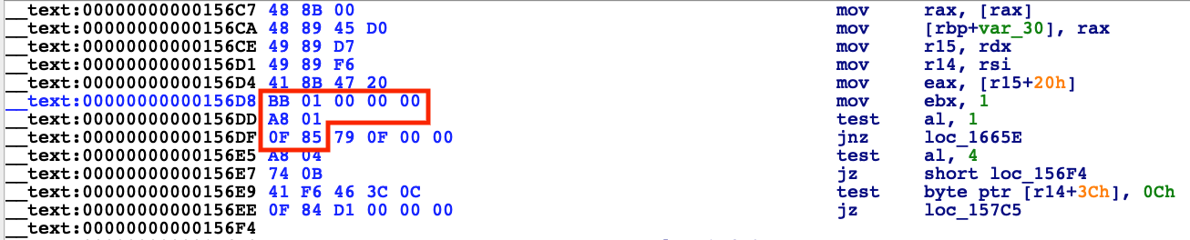

Find: 4D 8B 36 4D 85 F6 0F 85 29 FD FF FF 31 DB EB 47
Replace: 4D 8B 36 48 85 C0 0F 84 29 FD FF FF 31 DB EB 47
WhateverGreen cdf:
Find: BB 01 00 00 00 A8 01 0F 85
Replace: 31 DB 90 90 90 90 90 90 E9
The WEG cdf patch still appears to be valid in macOS (18A389)

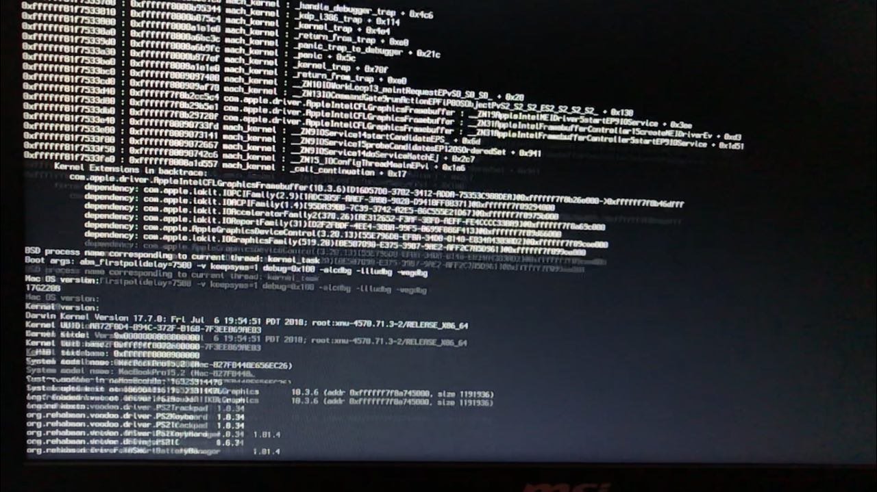

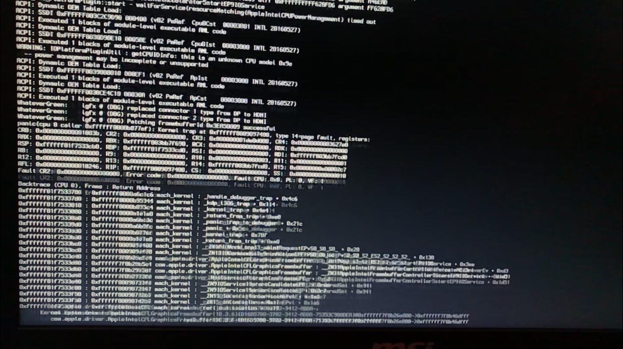

Using latest self compiled debug versions of WhateverGreen and Lilu, getting KP with AppleIntelCFLGraphicsFrameBuffer.kext right after it says "WhateverGreen: igfx @ (DBG) Patching framebufferid 0x3EA50009 sucessful."
Happens with or without Devices/Properties. Attaching the kp photos.
More information(My laptop's hw is almost the same as @headkaze's, the screen seems different however).
MODEL - MSI GV 8RE.
OS - 10.13.6 (special build for CoffeeLake systems with AppleIntelCFLGraphicsFrameBuffer.kext support).
CPU - i7(8750H)
GFX - gtx1060(disabled), UHD630(cant get to work, as getting the KP).
SCREEN - 1920x1080 wide view Display(possibly eDP?), cant find much info about it.

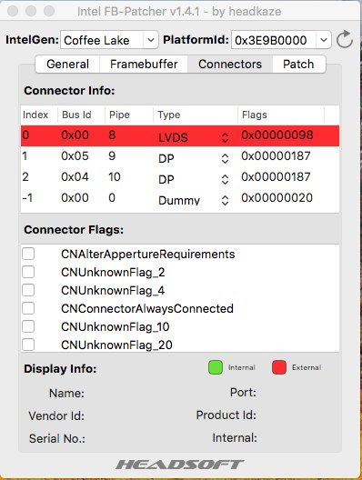

FB-Patcher shows LVDS connected at 0 and as external, shouldn't it be internal for acceleration to work?(pic attached too).
Attached problem reporting files.

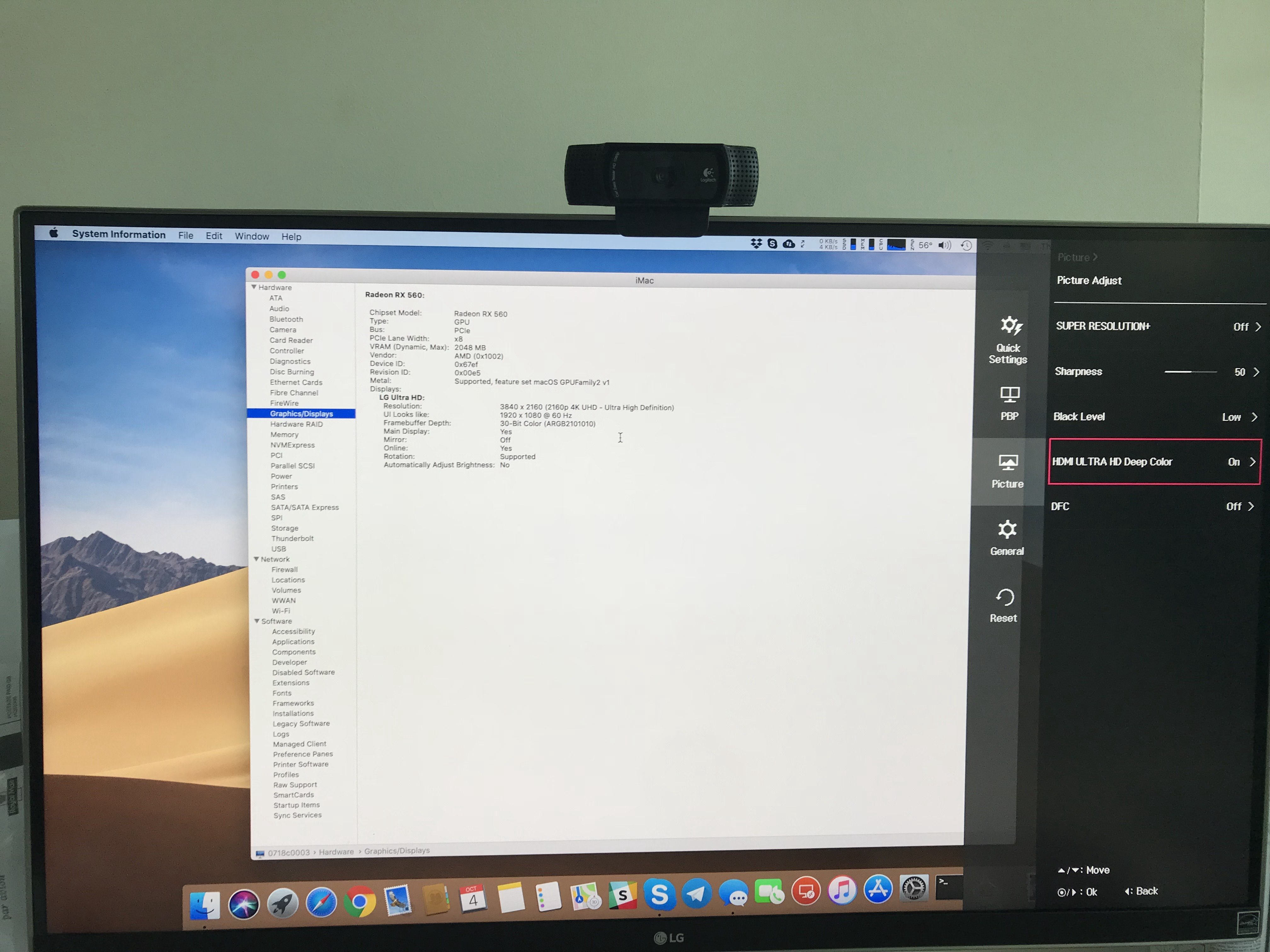

Yes. I have 4K LG 27UD88-W. It works now through DisplayPort and i want to try HDMI 2.0 at 4K @ 60Hz. But i get only 4K @ 30Hz. Same as you i have only Lilu + WhateverGreen. No AMD inject and no named framebuffer.
Until I send the config.plist, let's rule out the following: HDMI cable is High Speed with Ethernet (capable of 10GBps+)?
EDIT: Look at this: http://www.tomshardware.co.uk/forum/id-3629459/60hz-2160p-hdmi-connection.html
At some point it says: I'm sorry everyone. I found my answer quite shortly after posting this thread. On the LG 27UD88-W, there is a menu option called "HDMI ULTRA HD Deep Color".
Edited by Denicio
OMG! Thank you! With this option enabled i get 4K @ 60Hz even without -cdfon bootarg!!!
Thanks!!!
Edited by vandroiy2012
