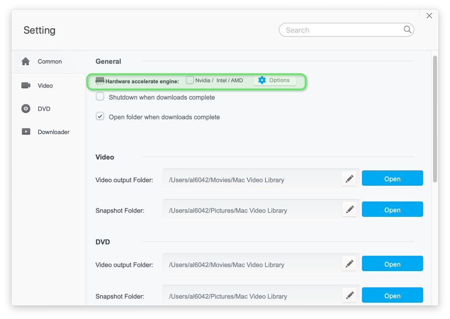

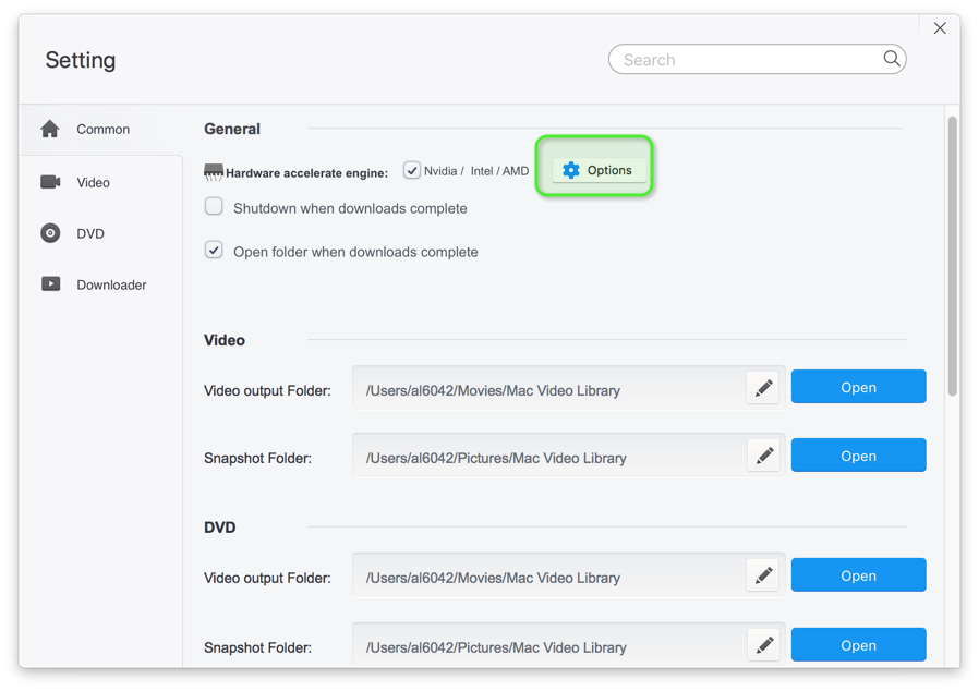

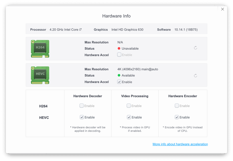

Hi @Andrey1970
A couple of users recognised that in Mojave 10.14.1 the H.264 support seem to be lost, while using a connectorless IGPU together with an RX or Vega card.
That happens also, if the guys are using the AppleGraphicsPowerManagement (AGPD)-KextsToPatch entry instead of WEG (WhateverGreen).
Do you know about this issue and would you might be able to help mitigate the situation?
3 minutes ago, al6042 said:
Hi @Andrey1970

2 minutes ago, al6042 said:
Since your CPU doesn't contain an IPGU and the AMD R9 280X only supports VCE1.0, I guess this is to be expected.
Yeah, but VCE 1.0 allows H264, which is an option in VideoProc - so shouldn't it at least support H264?   Or do you think I have the same issue you mentioned - no H264 support in macOS 10.14.1 ?

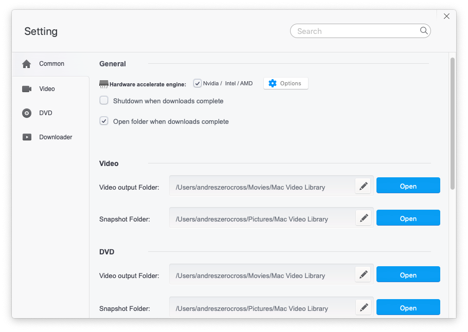

3 hours ago, al6042 said:
Hi @Andrey1970
1409286946_ScreenShot2018-11-11at00_04_56.png.6c7857834662ee754cae12d465e9254b.png1777306401_ScreenShot2018-11-11at00_05_23.png.371ce2f40af111b7077d68ea7b28345b.png
Still working good here,, IGPU = Intel HD 530 and AMD RX580 with latest Lilu.kexts and WhateverGreen.kext. But my system is Mojave 10.14.2 Public Beta
Edited by Andres ZeroCross
