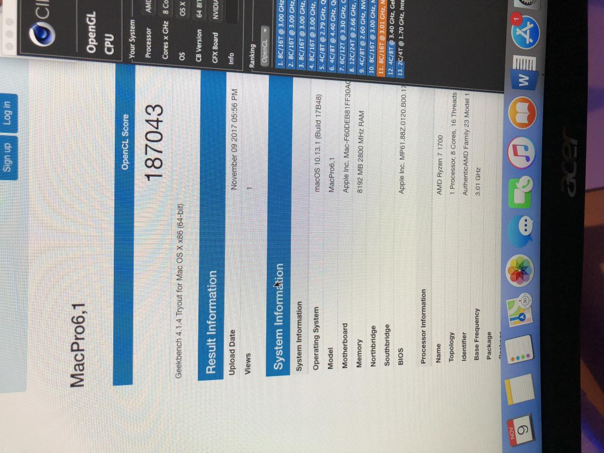

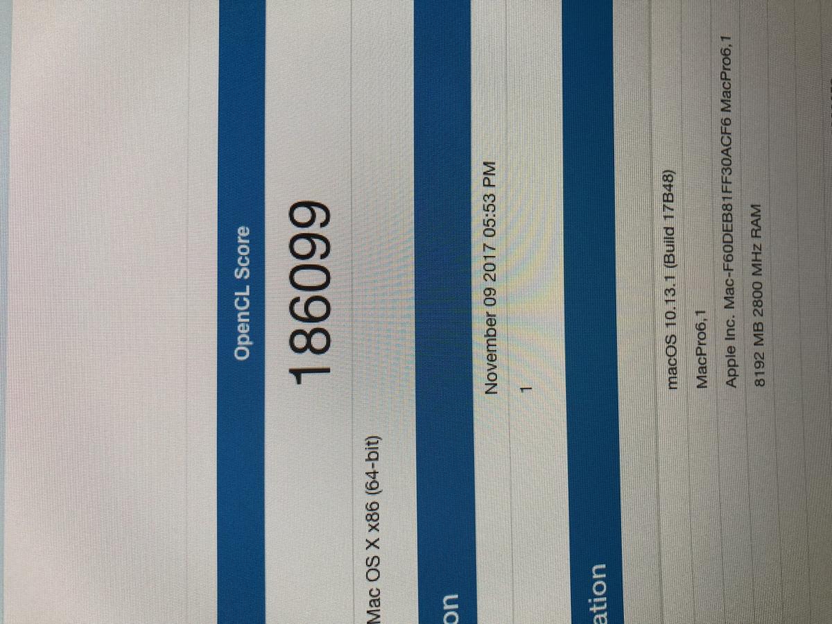

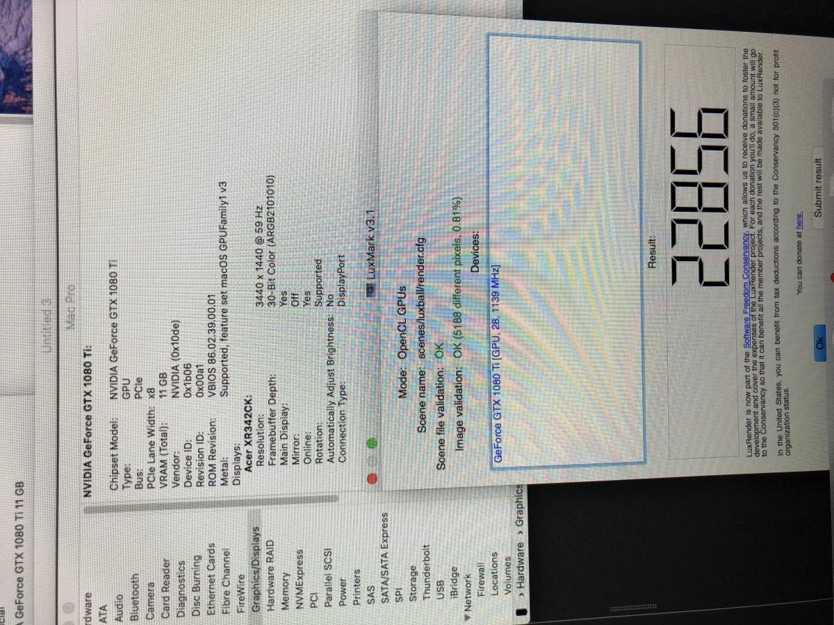

With my latest bios update it disabled x16 for nvidia cards on my mobo it only runs at 8x. I know it ran at 16x before because I made a video.
I was able to update to 10.13.1 on my intel machine i7 4970 with gtx 970 metal 2 was enabled!
I noticed it dropped some FPS in cinebench tho
My worked oob for Sierra but it’s an easy fix no worry
