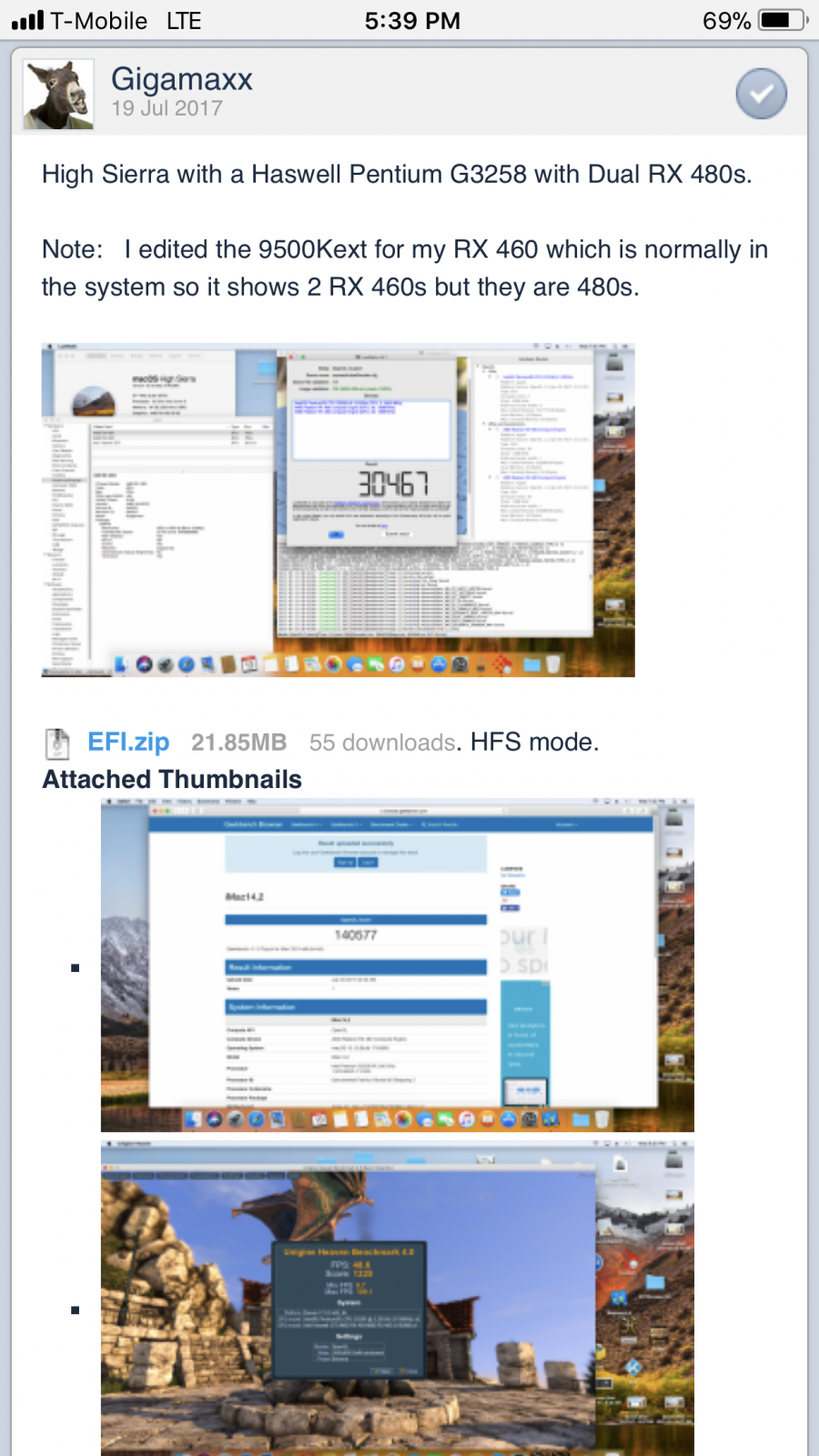

bbmatias3 Posted October 29, 2017 Share Posted October 29, 2017 @GigamaxxI was able to boot via two rx 480 the issue is that it’s only utilizing one not sure how to make both workIn luxmark it only shows one cardUpdate : I got both to work!!!! The only issue I can only use one monitor not two... with my old efi I could use both screens 2nd update full accleration works on both cards had to change to 6,1 sm bios!! it also made both screen work Link to comment https://www.insanelymac.com/forum/topic/324392-ryzen-clover-installation-guide-macos-sierra/page/48/#findComment-2525011 Share on other sites More sharing options...

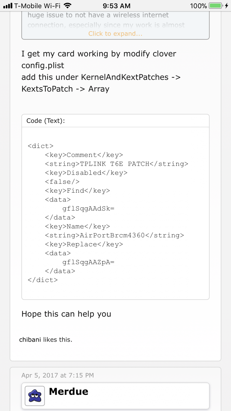

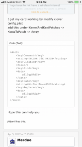

Furiel Posted November 7, 2017 Share Posted November 7, 2017 bbmatias3 can you tell me how did you setup your wifi i have the same card Archer T6E from TPlink but i cannot make it work. Thanks Link to comment https://www.insanelymac.com/forum/topic/324392-ryzen-clover-installation-guide-macos-sierra/page/48/#findComment-2530574 Share on other sites More sharing options...
bbmatias3 Posted November 7, 2017 Share Posted November 7, 2017 bbmatias3 can you tell me how did you setup your wifi i have the same card Archer T6E from TPlink but i cannot make it work. Thanks My worked oob for Sierra but it’s an easy fix no worry <dict> <key>Comment</key> <string>TPLINK T6E PATCH</string> <key>Disabled</key> <false/> <key>Find</key> <data> gflSqgAAdSk= </data> <key>Name</key> <string>AirPortBrcm4360</string> <key>Replace</key> <data> gflSqgAAZpA= </data> </dict> Link to comment https://www.insanelymac.com/forum/topic/324392-ryzen-clover-installation-guide-macos-sierra/page/48/#findComment-2530669 Share on other sites More sharing options...
