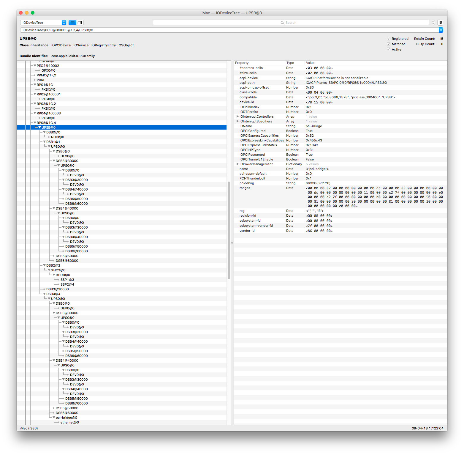

maleorderbride Posted April 7, 2018 Share Posted April 7, 2018 (edited) 1 hour ago, jya said: I see that you've connected your TB3 card to one of the slots using PCH's PCIe lane (SB.PCI0.RP05.PXSX). Any particular reason to use it there rather the the CPU's PCIe lanes? The PCH link is a PCIe x4 only, so that's a lot of PCI lanes sharing you have there... Edit: another question: how did you determine the values such as: Name (_PLD, Package (0x01) // _PLD: Physical Location of Device { Buffer (0x10) { /* 0000 */ 0x81, 0x00, 0x00, 0x00, 0x00, 0x00, 0x00, 0x00, /* 0008 */ 0x31, 0x1C, 0x00, 0x00, 0x00, 0x00, 0x00, 0x00 } }) wondering if this needs to be adapter depending on the TB3 card used The ASRock card is a PCI-e 3.0 x4, and it has to be installed in that slot on my motherboard. (Looks like you found a similar installation requirement) As for the PLD values, those are taken from Piker's blog when he was injecting a USB 3.1 PCI-e card. I think the UPC value of 0x09 is more important (or 0x0a), versus the 0x03 that other methods commonly use. Although, now that I look more closely at the ACPI specifications, perhaps it should be:. It looks like those PLD values don't particularly matter. The bottom first two values are physical orientation, but it looks like they don't have to be hardcoded. See the ACPI 6.0 specifications: http://www.uefi.org/sites/default/files/resources/ACPI_6.0.pdf See pages 524-531. Edited April 7, 2018 by maleorderbride 1 Link to comment https://www.insanelymac.com/forum/topic/323540-thunderbolt-drivers/page/5/#findComment-2608362 Share on other sites More sharing options...

jya Posted April 7, 2018 Share Posted April 7, 2018 Which ASRock board do you have? For the Gigabyte, all x299 boards must use PCIx4_2 and even the Designare has the TB3 chipset hooked up to the PCH Link to comment https://www.insanelymac.com/forum/topic/323540-thunderbolt-drivers/page/5/#findComment-2608380 Share on other sites More sharing options...

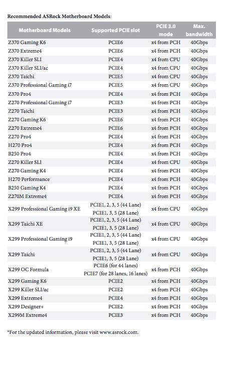

maleorderbride Posted April 7, 2018 Share Posted April 7, 2018 Kiiler SLI/ac Link to comment https://www.insanelymac.com/forum/topic/323540-thunderbolt-drivers/page/5/#findComment-2608381 Share on other sites More sharing options...
jya Posted April 7, 2018 Share Posted April 7, 2018 Kiiler SLI/acThank you.I returned the ASROCK Professional gaming because the last bios 1.40 (and earlier too) is buggy. Can't use per core OC. It's super buggy, and it always set the cores to a 43 ratio, which cause my 7980xe to go way past 100C Link to comment https://www.insanelymac.com/forum/topic/323540-thunderbolt-drivers/page/5/#findComment-2608382 Share on other sites More sharing options...

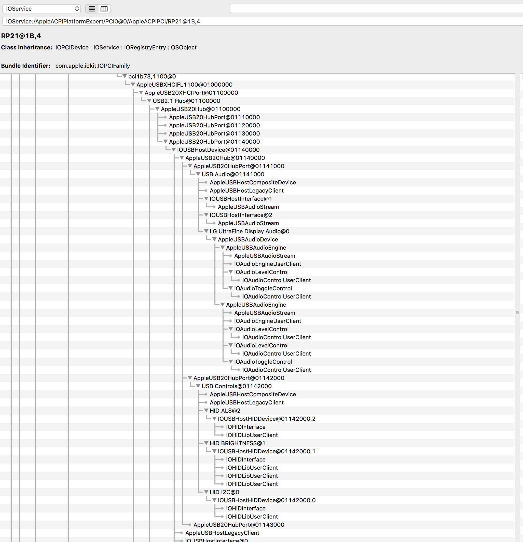

jya Posted April 7, 2018 Share Posted April 7, 2018 I am so glad you made it. I am using LG ultrafine 5K monitor which is using Thunderbolt 3 cable to connect to my Alpine Ridge thunderbolt 3 adaptor. Thunderbolt is working well but no howswap and it makes no peripheral functions like camera, audio, screen brightness controls broken after sleep/wake. [mention=358090]maleorderbride[/mention] said is it issue with USB3.1 but I do not think it is. So I am going to try his SSDT patch method. If you can share your SSDT I will look it up and compare to my device as well, I have difficulty to understand without the example TT my English is so bad. Please help me. And It would be a great appreciation for Gigabyte users as well.As I wrote earlier, the SSDT I used is the one provided by@maleorderbride on the first page of this thread, just look it up! Link to comment https://www.insanelymac.com/forum/topic/323540-thunderbolt-drivers/page/5/#findComment-2608395 Share on other sites More sharing options...

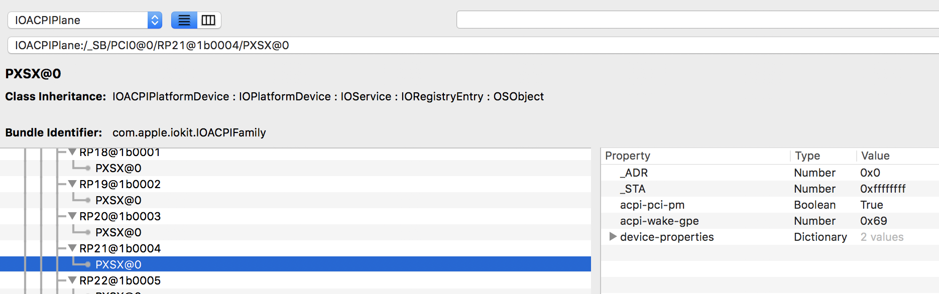

buyjoey Posted April 7, 2018 Share Posted April 7, 2018 45 minutes ago, jya said: As I wrote earlier, the SSDT I used is the one provided by@maleorderbride on the first page of this thread, just look it up! Please help. I tried but not work. Just what I did change the Address from my Original IOReg's to SSDT-TH3.aml If you see my screen capture, My Thunderbolt is PCI0, RP21 as I understood his instruction well. And found the value in IOACPIplaneView is PXSX. So I removed other value, SLT5, in @maleorderbride's SSDT since I do not see that value in my original but not PXSX. And Saved the file, put it in Patched folder. It seems like my MB's LED issue (It does not turned off after sleep or power off) is gone. But not hotswap still working. Can you look at my files and figured out what was wrong I did? Thank you! IOREG_Original.zip SSDT-TB3.aml.zip Link to comment https://www.insanelymac.com/forum/topic/323540-thunderbolt-drivers/page/5/#findComment-2608403 Share on other sites More sharing options...

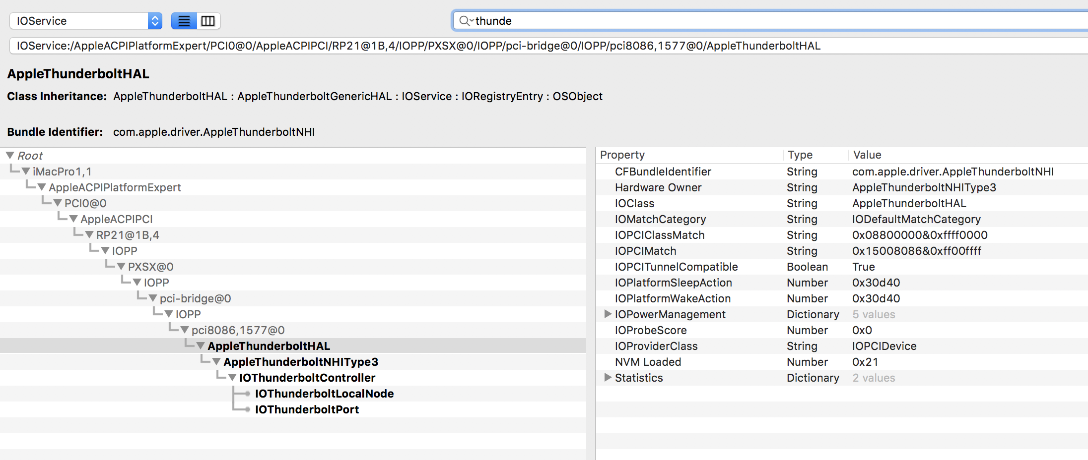

jya Posted April 7, 2018 Share Posted April 7, 2018 26 minutes ago, buyjoey said: Please help. I tried but not work. Just what I did change the Address from my Original IOReg's to SSDT-TH3.aml Is that screen capture, before or after the SSDT? The SSDT you've provided is correct, there's nothing else to change. But if that screen capture is with the SSDT, it hasn't been loaded.. There should be no more any RP21.PXSX device it should now be RP21.UPSB Link to comment https://www.insanelymac.com/forum/topic/323540-thunderbolt-drivers/page/5/#findComment-2608407 Share on other sites More sharing options...
buyjoey Posted April 7, 2018 Share Posted April 7, 2018 2 hours ago, jya said: Is that screen capture, before or after the SSDT? The SSDT you've provided is correct, there's nothing else to change. But if that screen capture is with the SSDT, it hasn't been loaded.. There should be no more any RP21.PXSX device it should now be RP21.UPSB Hi, Again, So If you see my Original IoReg and RP21 has all peripheral functions of LG Ultrafine Display. But all will be gone after sleep. Do you think it is USB problem? I did make SSDT for USBs but in this case, the functions are part of Display Hubs. Do you have any idea for fix this? Link to comment https://www.insanelymac.com/forum/topic/323540-thunderbolt-drivers/page/5/#findComment-2608434 Share on other sites More sharing options...
jya Posted April 8, 2018 Share Posted April 8, 2018 Hi, Again, So If you see my Original IoReg and RP21 has all peripheral functions of LG Ultrafine Display. But all will be gone after sleep. Do you think it is USB problem? I did make SSDT for USBs but in this case, the functions are part of Display Hubs. Do you have any idea for fix this?You want people to help you, but you don't answer the questions asked. Sent from my SM-G950F using Tapatalk Link to comment https://www.insanelymac.com/forum/topic/323540-thunderbolt-drivers/page/5/#findComment-2608473 Share on other sites More sharing options...
