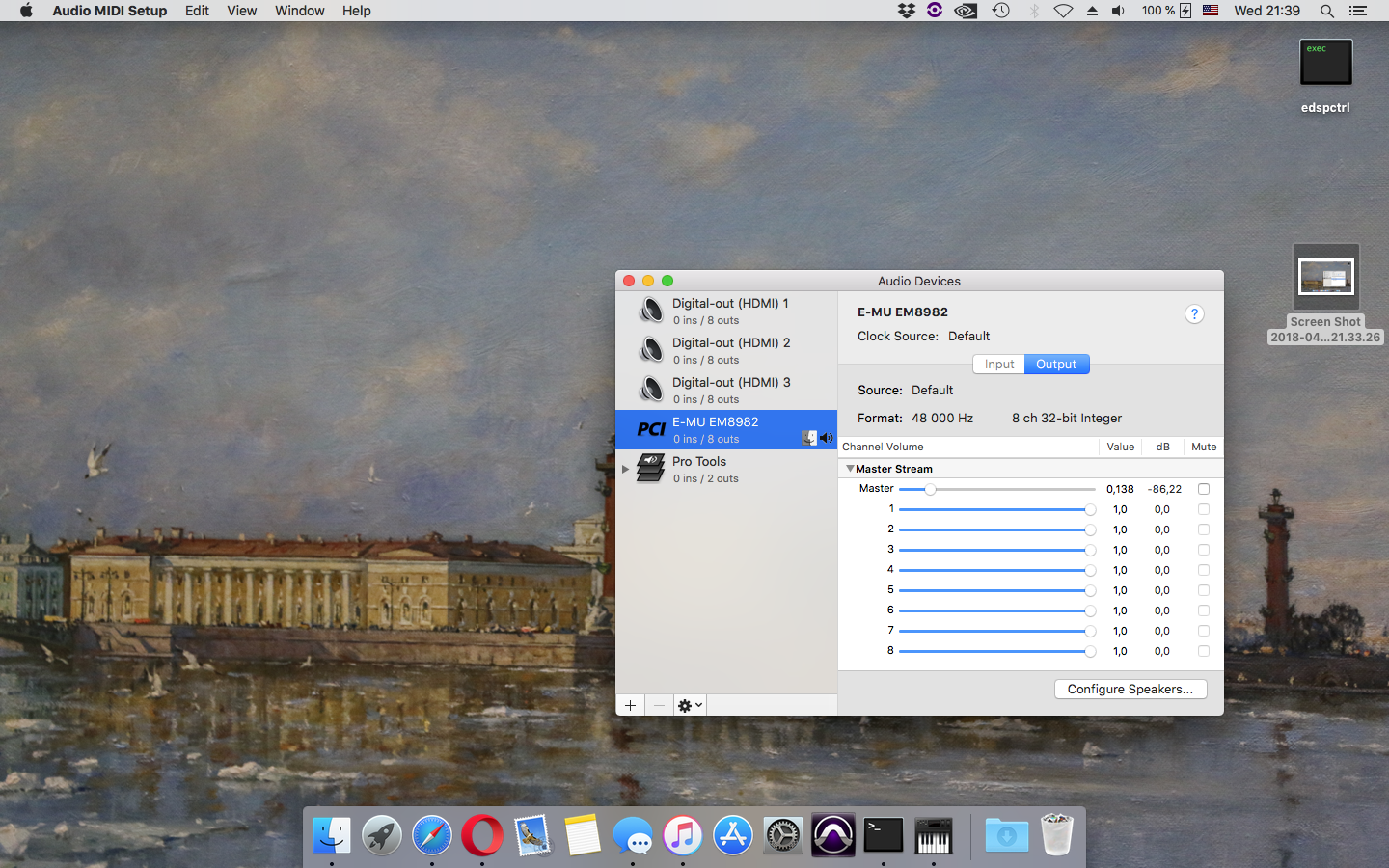

RomichA Posted March 19, 2018 Share Posted March 19, 2018 is it possible to change default sample rate from 48.000? Pro tools says: "Could not create a new document because Pro Tools could not set sample rate to specified value.." This parameter is locked in audio/midi setup. Link to comment https://www.insanelymac.com/forum/topic/321954-kx-audio-driver-mod-sound-blaster-live-audigy-124rx-emu-edsp/page/8/#findComment-2604286 Share on other sites More sharing options...
ITzTravelInTime Posted March 19, 2018 Author Share Posted March 19, 2018 2 minutes ago, RomichA said: is it possible to change default sample rate from 48.000? Pro tools says: "Could not create a new document because Pro Tools could not set sample rate to specified value.." This parameter is locked in audio/midi setup. it's not possible, because the driver is made only for that sample rate, this is a limitation of the original mac kx driver, because multiple sample rates means that i have to redo all the math to let the driver to work, and i do not have time and driver knowlage to do that now. 1 Link to comment https://www.insanelymac.com/forum/topic/321954-kx-audio-driver-mod-sound-blaster-live-audigy-124rx-emu-edsp/page/8/#findComment-2604291 Share on other sites More sharing options...
RomichA Posted March 19, 2018 Share Posted March 19, 2018 Just now, ITzTravelInTime said: it's not possible, because the driver is made only for that sample rate, this is a limitation of the original mac kx driver, because multiple sample rates means that i have to redo all the math to let the driver to work, and i do not have time and driver knowlage to do that now. Thank you for so quick reply! But, may be the solution of this problem will be to create a new spctrl file with different sample rate? or it is not so easy? I ask it because the logic pro works perfectly on different sample rates on your driver!) Link to comment https://www.insanelymac.com/forum/topic/321954-kx-audio-driver-mod-sound-blaster-live-audigy-124rx-emu-edsp/page/8/#findComment-2604293 Share on other sites More sharing options...
ITzTravelInTime Posted March 19, 2018 Author Share Posted March 19, 2018 1 minute ago, RomichA said: Thank you for so quick reply! But, may be the solution of this problem will be to create a new spctrl file with different sample rate? or it is not so easy? I ask it because the logic pro works perfectly on different sample rates on your driver!) that's complex at least for me because i am kind of a beginner driver programmer, my speciality is to do front end software in swift , i have created this mod of the kx audio driver just to let it work better with the audigy rx and also to make it more compatible with the latest mac os versions, but redoing the sample rate stuff it's very complicated, and i am not so expert in driver programming rigth now to do that, but maybe the driver can work at 44,1 khz, but i do not know how to do that now, i am sorry, but that's what i can do now Link to comment https://www.insanelymac.com/forum/topic/321954-kx-audio-driver-mod-sound-blaster-live-audigy-124rx-emu-edsp/page/8/#findComment-2604295 Share on other sites More sharing options...

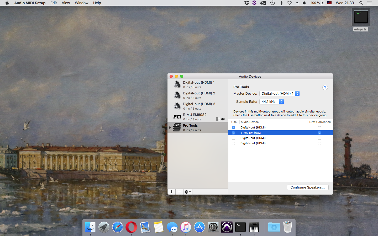

RomichA Posted April 4, 2018 Share Posted April 4, 2018 (edited) On 3/19/2018 at 10:11 PM, ITzTravelInTime said: that's complex at least for me because i am kind of a beginner driver programmer, my speciality is to do front end software in swift , i have created this mod of the kx audio driver just to let it work better with the audigy rx and also to make it more compatible with the latest mac os versions, but redoing the sample rate stuff it's very complicated, and i am not so expert in driver programming rigth now to do that, but maybe the driver can work at 44,1 khz, but i do not know how to do that now, i am sorry, but that's what i can do now I found the solution of this problem with fix 48.000Hz! You can create aggregate Device and as a 1st primary device select your build in device. In this case you can change the sample rate. And the second device in this line should be card e-mu. In this case the sample rate of it will change automatically as in primary device. For me it's work even in pro tools! ITzTravelInTime, Thank you very much for you work!!! Edited April 4, 2018 by RomichA Link to comment https://www.insanelymac.com/forum/topic/321954-kx-audio-driver-mod-sound-blaster-live-audigy-124rx-emu-edsp/page/8/#findComment-2607737 Share on other sites More sharing options...
ITzTravelInTime Posted April 4, 2018 Author Share Posted April 4, 2018 3 minutes ago, RomichA said: I found the solution of this problem with fix 48.000Hz! You can create aggregate Device and as a 1st primary device select your build in device. In this case you can change the sample rate. And the second device in this line should be card e-mu. In this case the sample rate of it will change automatically as in primary device. For me it's work even in pro tools! ITzTravelInTime, Thank you very much for you work!!! this is not a solution, the driver is still locked at 48 khz, and still works at 48 khz, because it has been designed to work only at this frequency, and in this way the audio quality will also be worse, because the system have to convert 44,1 khz to 48 khz so there is a quality loss and more latency this will only make to work some applications which didn't like the 48 khz Link to comment https://www.insanelymac.com/forum/topic/321954-kx-audio-driver-mod-sound-blaster-live-audigy-124rx-emu-edsp/page/8/#findComment-2607743 Share on other sites More sharing options...
RomichA Posted April 4, 2018 Share Posted April 4, 2018 22 minutes ago, ITzTravelInTime said: this is not a solution, the driver is still locked at 48 khz, and still works at 48 khz, because it has been designed to work only at this frequency, and in this way the audio quality will also be worse, because the system have to convert 44,1 khz to 48 khz so there is a quality loss and more latency this will only make to work some applications which didn't like the 48 khz But in this case Pro tools can open session with different sample rate without problem and any latency for me it's good! Hope this will be helpful for someone else Link to comment https://www.insanelymac.com/forum/topic/321954-kx-audio-driver-mod-sound-blaster-live-audigy-124rx-emu-edsp/page/8/#findComment-2607749 Share on other sites More sharing options...
