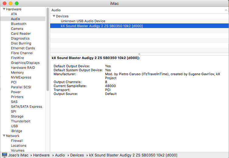

jubarim Posted April 25, 2018 Share Posted April 25, 2018 Hi ITzTravelInTime. My Audigy 2 ZS SB0350 arrived and it is working! On High Sierra and Windows 10! Thanks for the tips! 2 Link to comment https://www.insanelymac.com/forum/topic/321954-kx-audio-driver-mod-sound-blaster-live-audigy-124rx-emu-edsp/page/9/#findComment-2611378 Share on other sites More sharing options...

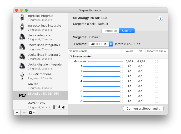

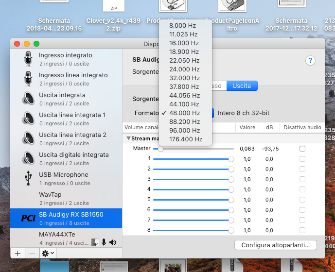

ITzTravelInTime Posted April 25, 2018 Author Share Posted April 25, 2018 i successfully got the switching frequencyes to work, i can't belive it! now i have to test all the frequencyes to work with different cards and see which is the maximun working one for each card, but i can already say that sound blaster live! cards are limited up to 48khz, so the driver will support from 8khz up to 48 khz on this kind of cards, i prefer to keep using official supported sample rates, now i have to test it on the audigy 1st series, 2 series, audigy 2 zs cards and audiigy rx cards to see which is the max frequency thaty can support, but most of them are just limited to 96khz, but we will see in the tests, after the tests i can release both the drivers and the source code for it. 1 Link to comment https://www.insanelymac.com/forum/topic/321954-kx-audio-driver-mod-sound-blaster-live-audigy-124rx-emu-edsp/page/9/#findComment-2611452 Share on other sites More sharing options...
ITzTravelInTime Posted April 25, 2018 Author Share Posted April 25, 2018 (edited) And also when you have to test an audio driver and you have to do it properly . Edited April 27, 2018 by ITzTravelInTime 1 Link to comment https://www.insanelymac.com/forum/topic/321954-kx-audio-driver-mod-sound-blaster-live-audigy-124rx-emu-edsp/page/9/#findComment-2611476 Share on other sites More sharing options...
ITzTravelInTime Posted April 25, 2018 Author Share Posted April 25, 2018 On 4/24/2018 at 7:54 PM, cinek6413 said: but 176.4kHz works well on recompiled kext, but if this is actually a real frequency, I am unable to say as documented here it is a sample rate standard and i have also tested it and i can confirm that it works with my audigy rx at least, i have to test it with other cards https://github.com/audiojs/sample-rate 1 Link to comment https://www.insanelymac.com/forum/topic/321954-kx-audio-driver-mod-sound-blaster-live-audigy-124rx-emu-edsp/page/9/#findComment-2611487 Share on other sites More sharing options...
ITzTravelInTime Posted April 25, 2018 Author Share Posted April 25, 2018 all the possible frequencyes i have added seems to work fine at the moment, i have added a lot of different frequencyes to support better all kinds of professional applications, inclunding strange sampling rates and goes from 8khz up to 176.4 khz, unfortunately 192 khz does not seems to work even on cards which should support it like the audigy rx, but other frequencyes just works fine and at the moment i have tested only the sound blaster audigy rx and the audigy sb0090 (1st gen audigy) and i can confirm that all the frequencyes from 8khz up to 176.4 khz does work on that card, so i think that such frequencyes should work on all the audigy 2, 2sz, 4 cards as well, tomorrow i will test with my sound blaster live! cards and i will let you know, but here are also some photos (pro tip: use cmd + alt/opton + 4 and then press space to make a screenshot of a single window): Link to comment https://www.insanelymac.com/forum/topic/321954-kx-audio-driver-mod-sound-blaster-live-audigy-124rx-emu-edsp/page/9/#findComment-2611493 Share on other sites More sharing options...
