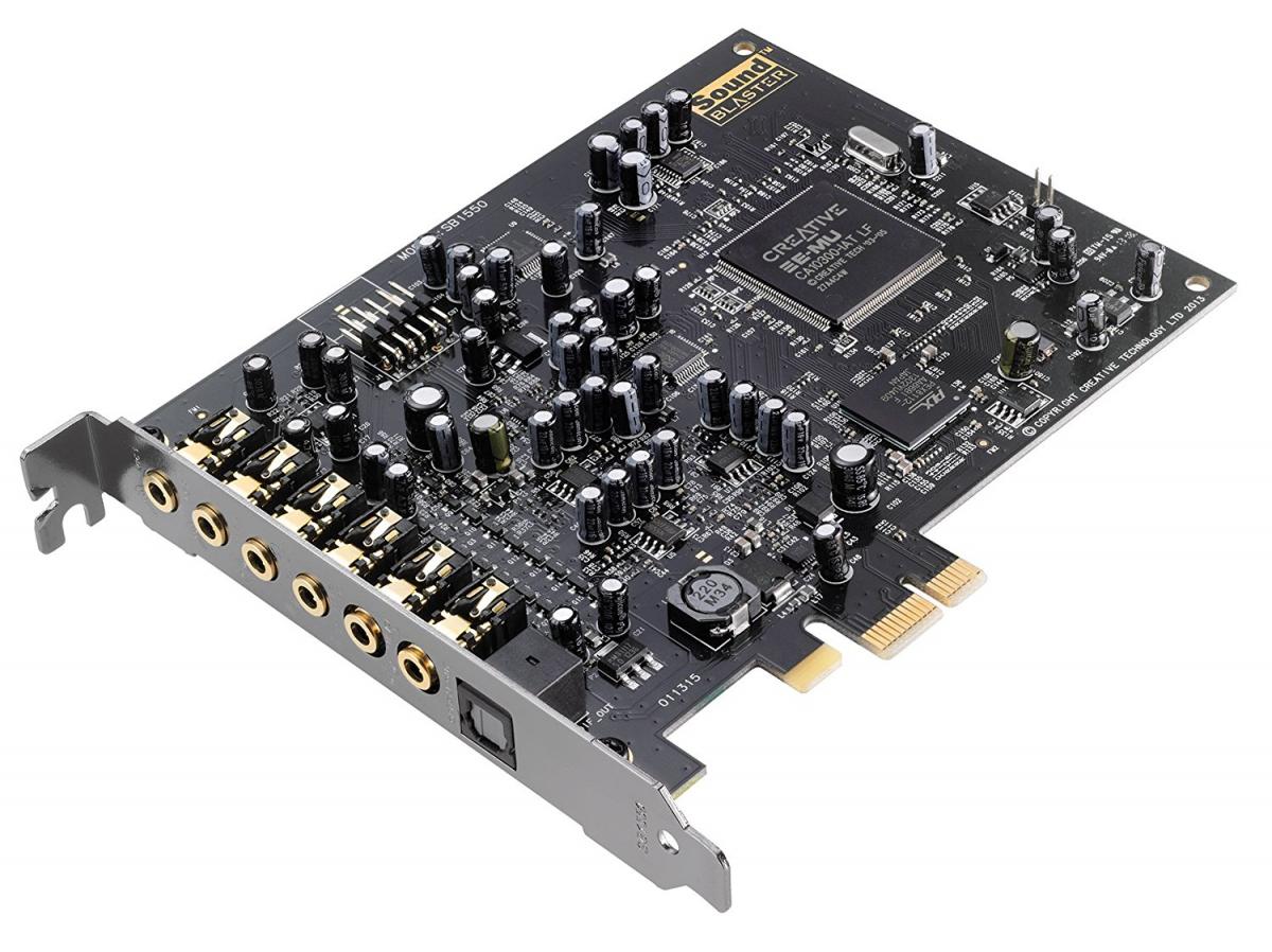

ITzTravelInTime Posted July 13, 2017 Author Share Posted July 13, 2017 What about SB0610? it should work with the driver, just try it For the sound blaster audigy rx guy, i have found a good offer on eBay for it http://www.ebay.com/itm/N-Creative-Sound-Blaster-Audigy-RX-SB1550-7-1-Sound-Card-w-Headphone-Amp/302043849902?_trksid=p2047675.c100005.m1851&_trkparms=aid%3D222007%26algo%3DSIM.MBE%26ao%3D1%26asc%3D20140620091323%26meid%3Dbb7b887761124b62b92d398bb987c617%26pid%3D100005%26rk%3D3%26rkt%3D6%26mehot%3Dpp%26sd%3D391710820047 Link to comment https://www.insanelymac.com/forum/topic/321954-kx-audio-driver-mod-sound-blaster-live-audigy-124rx-emu-edsp/page/5/#findComment-2462182 Share on other sites More sharing options...

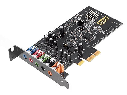

Loloflat6 Posted October 7, 2017 Share Posted October 7, 2017 This topic could be helpful for me, I need a good audio card an I found this one : Creative Sound Blaster FX 5.1 SBX. ProStudio. Link to comment https://www.insanelymac.com/forum/topic/321954-kx-audio-driver-mod-sound-blaster-live-audigy-124rx-emu-edsp/page/5/#findComment-2510972 Share on other sites More sharing options...
ITzTravelInTime Posted October 7, 2017 Author Share Posted October 7, 2017 This topic could be helpful for me, I need a good audio card an I found this one : Creative Sound Blaster FX 5.1 SBX. ProStudio. that card is not supported by this driver, because it uses a different chipset family, this driver does support only cards with emu10kX chipsets, like the sound blaster audigy rx or the sound blaster live/audigy/audigy 2 zs/audigy 4 and many others For pcie I suggest to you an audigy rx, but keep in mind that this is the only driver that gets it to work on Mac and the inputs are currently unsupported 1 Link to comment https://www.insanelymac.com/forum/topic/321954-kx-audio-driver-mod-sound-blaster-live-audigy-124rx-emu-edsp/page/5/#findComment-2511080 Share on other sites More sharing options...
Loloflat6 Posted October 8, 2017 Share Posted October 8, 2017 Should i buy this one , seems to be more compatible ? Creative Sound Blaster Audigy Rx Carte son interne 7.1 SBX ProStudio Link to comment https://www.insanelymac.com/forum/topic/321954-kx-audio-driver-mod-sound-blaster-live-audigy-124rx-emu-edsp/page/5/#findComment-2511305 Share on other sites More sharing options...
ITzTravelInTime Posted October 8, 2017 Author Share Posted October 8, 2017 Should i buy this one , seems to be more compatible ? Creative Sound Blaster Audigy Rx Carte son interne 7.1 SBX ProStudio this one is fine, I won one too, work well in Mac using the driver that you can find in the first post of this thread, only problem is that inputs are currently not supported by this driver, so you can use it only for listening on Mac, but you will have working optical spdf and 7.1/5.1 (for 7.1/5.1 you have to setup them into the midi configuration app that is a system app) 1 Link to comment https://www.insanelymac.com/forum/topic/321954-kx-audio-driver-mod-sound-blaster-live-audigy-124rx-emu-edsp/page/5/#findComment-2511382 Share on other sites More sharing options...
