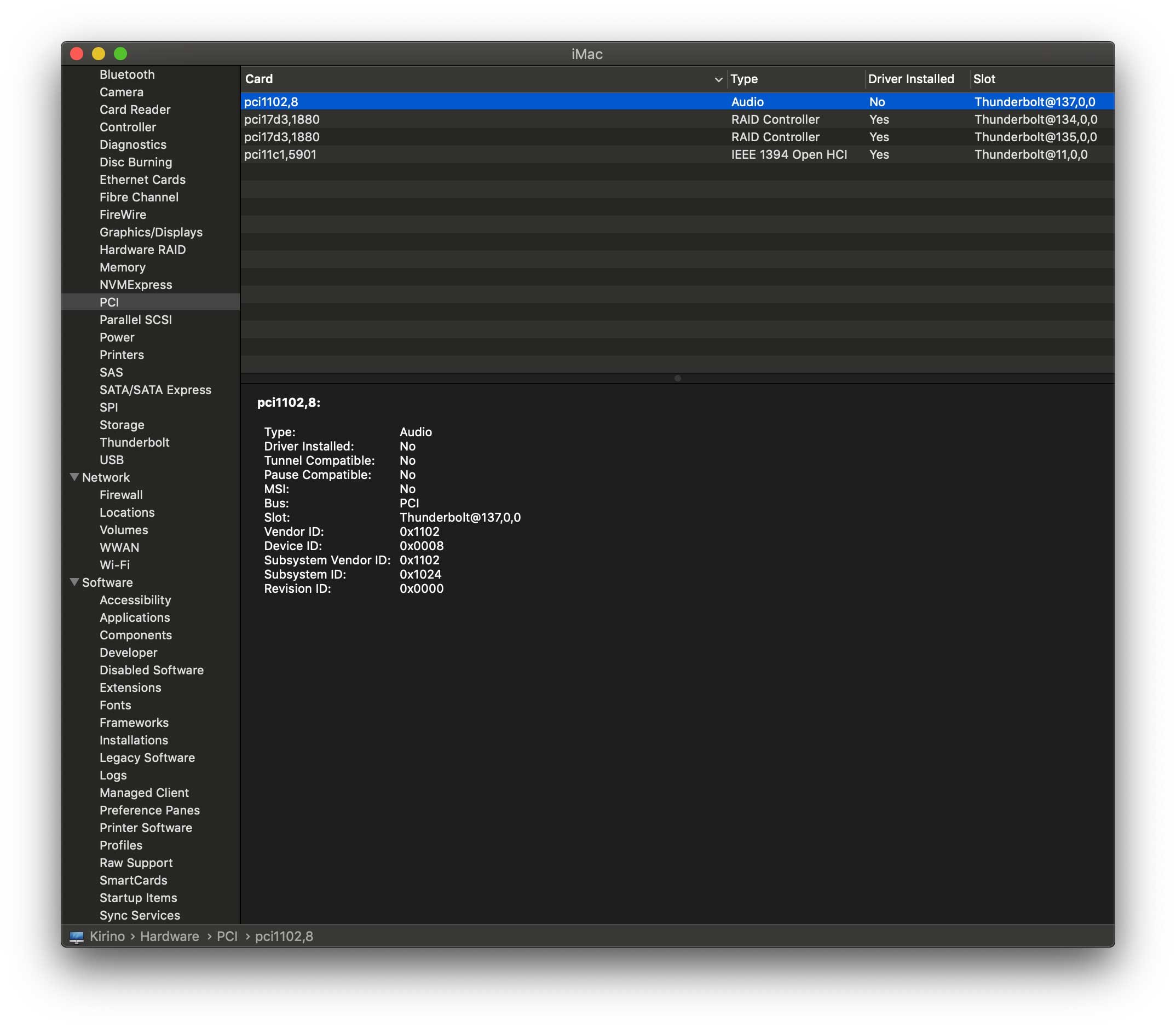

nekonoko Posted October 22, 2018 Share Posted October 22, 2018 (edited) Not sure if anyone has tried to do this before, but I put a Sound Blaster Audigy RX into a Thunderbolt expansion chassis and installed kXAudioDriver.kext. I'm able to manually load via: Kirino:~ neko$ sudo kextutil -v -t /Library/Extensions/kXAudioDriver.kext Password: Defaulting to kernel file '/System/Library/Kernels/kernel' Kext with invalid signatured (-67062) allowed: <OSKext 0x7faf3ed1ef10 [0x7fffa14718e0]> { URL = "file:///Library/Extensions/kXAudioDriver.kext/", ID = "com.kXProject.driver.kXAudioDriver" } Code Signing Failure: not code signed /Library/Extensions/kXAudioDriver.kext appears to be loadable (not including linkage for on-disk libraries). Loading /Library/Extensions/kXAudioDriver.kext. /Library/Extensions/kXAudioDriver.kext successfully loaded (or already loaded). Kirino:~ neko$ The card isn't detected by the driver - it looks like the driver would need some extra steps to initialize PCIe devices over Thunderbolt. Still thought it was interesting though. Edited October 22, 2018 by nekonoko Clarification Link to comment https://www.insanelymac.com/forum/topic/321954-kx-audio-driver-mod-sound-blaster-live-audigy-124rx-emu-edsp/page/12/#findComment-2642288 Share on other sites More sharing options...
ITzTravelInTime Posted October 22, 2018 Author Share Posted October 22, 2018 1 hour ago, nekonoko said: Not sure if anyone has tried to do this before, but I put a Sound Blaster Audigy RX into a Thunderbolt expansion chassis and installed kXAudioDriver.kext. I'm able to manually load via: Kirino:~ neko$ sudo kextutil -v -t /Library/Extensions/kXAudioDriver.kext Password: Defaulting to kernel file '/System/Library/Kernels/kernel' Kext with invalid signatured (-67062) allowed: <OSKext 0x7faf3ed1ef10 [0x7fffa14718e0]> { URL = "file:///Library/Extensions/kXAudioDriver.kext/", ID = "com.kXProject.driver.kXAudioDriver" } Code Signing Failure: not code signed /Library/Extensions/kXAudioDriver.kext appears to be loadable (not including linkage for on-disk libraries). Loading /Library/Extensions/kXAudioDriver.kext. /Library/Extensions/kXAudioDriver.kext successfully loaded (or already loaded). Kirino:~ neko$ The card isn't detected by the driver - it looks like the driver would need some extra steps to initialize PCIe devices over Thunderbolt. Still thought it was interesting though. On original macs you should use the kext-dev-mode=1 boot arg and also the driver does not have the needed implementations to run thunderbolt devices, maye you can get it to work with a reboot, and you have shut down your machine before removing the card. But all the device ids and other propertyes are fine in system info, probably it's the driver itself that needs some extra thunderbolt 3 implementation. Link to comment https://www.insanelymac.com/forum/topic/321954-kx-audio-driver-mod-sound-blaster-live-audigy-124rx-emu-edsp/page/12/#findComment-2642301 Share on other sites More sharing options...
