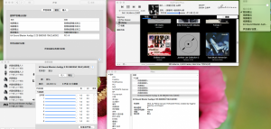

My PC has sound now,but the setting are strange. Look at the pic please.
settings seems to be as they are supposed to be, you do not have the slider because it's an 8 channels device and not 2 channel, only devices with 2 channels have sliders in the settings
