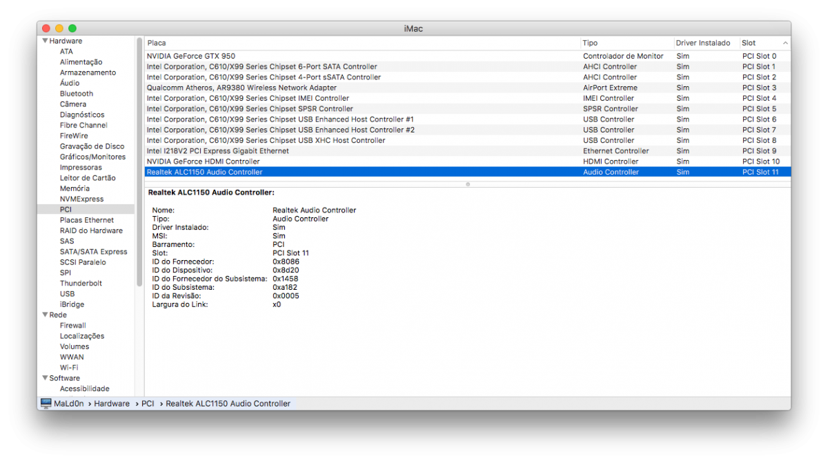

MaLd0n Posted June 10, 2017 Author Share Posted June 10, 2017 Device (ARPT) { Name (_ADR, Zero) // _ADR: Address Name (_SUN, 0x03) // _SUN: Slot User Number Method (_DSM, 4, NotSerialized) // _DSM: Device-Specific Method { If (LEqual (Arg2, Zero)) { Return (Buffer () { 0x03 }) } Return (Package () { "built-in", Buffer () { 0x00 }, "model", Buffer () { "Qualcomm Atheros, AR9380 Wireless Network Adapter" }, "name", Buffer () { "AirPort Extreme" }, }) } } 1 Link to comment https://www.insanelymac.com/forum/topic/320288-guide-sierra-high-sierra-on-asus-z170m-plus-dsdt/page/11/#findComment-2441010 Share on other sites More sharing options...
swede420 Posted June 10, 2017 Share Posted June 10, 2017 Device (ARPT) { Name (_ADR, Zero) // _ADR: Address Name (_SUN, 0x03) // _SUN: Slot User Number Method (_DSM, 4, NotSerialized) // _DSM: Device-Specific Method { If (LEqual (Arg2, Zero)) { Return (Buffer () { 0x03 }) } Return (Package () { "built-in", Buffer () { 0x00 }, "model", Buffer () { "Qualcomm Atheros, AR9380 Wireless Network Adapter" }, "name", Buffer () { "AirPort Extreme" }, }) } } MaLd0n 2017-06-10 às 10.08.05.png Where do I put this? 1 Link to comment https://www.insanelymac.com/forum/topic/320288-guide-sierra-high-sierra-on-asus-z170m-plus-dsdt/page/11/#findComment-2441478 Share on other sites More sharing options...
MaLd0n Posted June 11, 2017 Author Share Posted June 11, 2017 check ioreg post one ioreg here 1 Link to comment https://www.insanelymac.com/forum/topic/320288-guide-sierra-high-sierra-on-asus-z170m-plus-dsdt/page/11/#findComment-2441522 Share on other sites More sharing options...
swede420 Posted June 11, 2017 Share Posted June 11, 2017 check ioreg post one ioreg here Never mind, I figured it out myself. But I can't do the same with my SD card reader. It is an Alcor usb card reader which I have connected to one of the USB ports on the motherboard. Although it is working OOB, I want it to show as native in about this mac. 1 Link to comment https://www.insanelymac.com/forum/topic/320288-guide-sierra-high-sierra-on-asus-z170m-plus-dsdt/page/11/#findComment-2442183 Share on other sites More sharing options...
