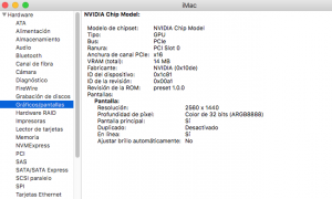

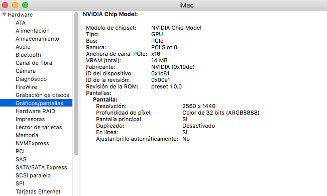

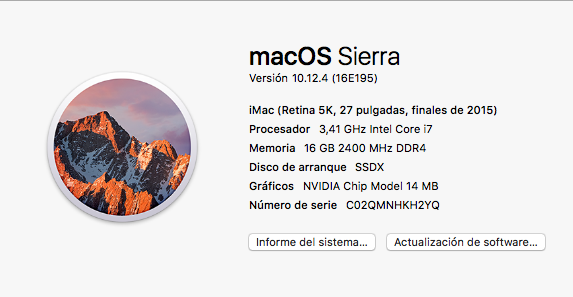

Ikerox Posted May 8, 2017 Share Posted May 8, 2017 test it CLOVER.zip Let me know if work Works ok, except graphics... I think I have no full acceleration, some strange lines at startup, fan is not blowing and the system says I have 14 Mb.. 1 Link to comment https://www.insanelymac.com/forum/topic/320288-guide-sierra-high-sierra-on-asus-z170m-plus-dsdt/page/7/#findComment-2420000 Share on other sites More sharing options...
MaLd0n Posted May 8, 2017 Author Share Posted May 8, 2017 U install webdriver? Link to comment https://www.insanelymac.com/forum/topic/320288-guide-sierra-high-sierra-on-asus-z170m-plus-dsdt/page/7/#findComment-2420133 Share on other sites More sharing options...
Ikerox Posted May 8, 2017 Share Posted May 8, 2017 U install webdriver? Yes, last version... From here: http://www.insanelymac.com/forum/topic/312525-nvidia-web-driver-updates-for-macos-sierra-update-04192017/ 1 Link to comment https://www.insanelymac.com/forum/topic/320288-guide-sierra-high-sierra-on-asus-z170m-plus-dsdt/page/7/#findComment-2420154 Share on other sites More sharing options...
Ikerox Posted May 8, 2017 Share Posted May 8, 2017 Issue solved... I removed: kext-dev-mode=1 nv_disable=1 Thank you MaLd0n and duffs for your advices.... 1 Link to comment https://www.insanelymac.com/forum/topic/320288-guide-sierra-high-sierra-on-asus-z170m-plus-dsdt/page/7/#findComment-2420184 Share on other sites More sharing options...
MaLd0n Posted May 8, 2017 Author Share Posted May 8, 2017 Kext-dev-mode=1 nv_disable=1 Thank you MaLd0n and duffs for your advices.... only nv_disable=1, the other in Sierra = no diff Welcome! 1 Link to comment https://www.insanelymac.com/forum/topic/320288-guide-sierra-high-sierra-on-asus-z170m-plus-dsdt/page/7/#findComment-2420205 Share on other sites More sharing options...
