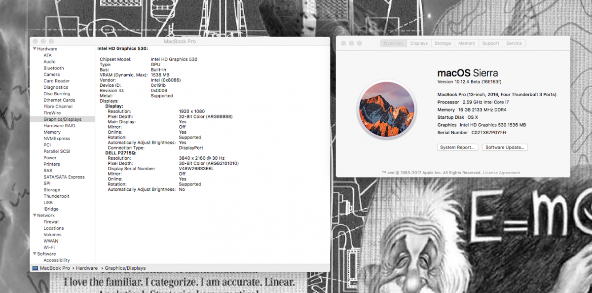

Technotronsky Posted March 15, 2017 Share Posted March 15, 2017 A little update: was on 13,3 and switched to SMBIOS 9,1 and screen is recognised. Funny thing is screen stayed black, so I figured it must be resolution. Unfortunately, only mirroring works at my screen's native resolution (2560x1440). Is this a limitation of the Intel HD 530 and are there any workaround or alternative resolutions/ways to use the extra real estate of my second monitor? Link to comment https://www.insanelymac.com/forum/topic/319764-guide-dell-xps-15-9550-mojave-1014-1015-quick-installation/page/16/#findComment-2384805 Share on other sites More sharing options...

Deniryer Posted March 15, 2017 Share Posted March 15, 2017 Yep, using DP for sure, works perfectly in Windows 10. Like I said, it works now, must have been switching to 9,1 then :-). Any way to make native DP work? Just out of curiosity. Like I said, I am a big noob You can try switch the smbios to 13,2. I'm using it currently and HDMI and all of the display outputs (vga, mini dp & hdmi) at the Dell USB type C dock works, however if you connect more than a one monitor to the thunderbolt port/usb c only mirroring options is available and they are detected at the system information as one single monitor. I can confirm that you will be able to connect Dell 2715 via HDMI port build in the laptop at 4k resolution but only with 30hz refresh rate. I still can get to work the minidp build in the dell dock unfortunately. I've attached clover folder to the post. CLOVER.zip Link to comment https://www.insanelymac.com/forum/topic/319764-guide-dell-xps-15-9550-mojave-1014-1015-quick-installation/page/16/#findComment-2385080 Share on other sites More sharing options...

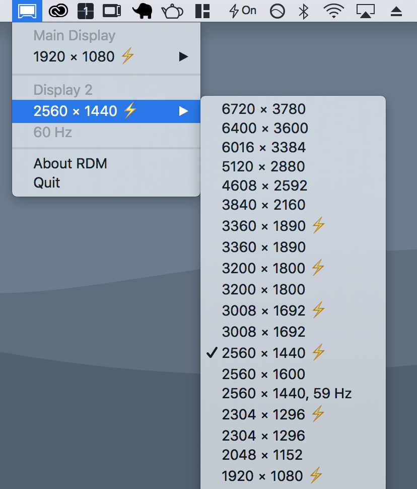

Technotronsky Posted March 16, 2017 Share Posted March 16, 2017 One last question: I can also go up to 4K 30Hz on my P2715Q, but a lot of 'lo-res' resolutions are missing. For example, I would lprefer to run the lower QHD but at 60Hz, but it's not there. Is there a way to add custom resolutions in Sierra? If only we had Pascal support haha... Link to comment https://www.insanelymac.com/forum/topic/319764-guide-dell-xps-15-9550-mojave-1014-1015-quick-installation/page/16/#findComment-2385305 Share on other sites More sharing options...
Krim404 Posted March 16, 2017 Author Share Posted March 16, 2017 One last question: I can also go up to 4K 30Hz on my P2715Q, but a lot of 'lo-res' resolutions are missing. For example, I would lprefer to run the lower QHD but at 60Hz, but it's not there. Is there a way to add custom resolutions in Sierra? If only we had Pascal support haha... yes it's possible but has nothing to do with the XPS15 and can be easily answered by using google. Link to comment https://www.insanelymac.com/forum/topic/319764-guide-dell-xps-15-9550-mojave-1014-1015-quick-installation/page/16/#findComment-2385323 Share on other sites More sharing options...
Technotronsky Posted March 16, 2017 Share Posted March 16, 2017 Sorry, you are right. Kinda drifting off here, but I honestly couldn't find anything specific for Sierra via Google... Link to comment https://www.insanelymac.com/forum/topic/319764-guide-dell-xps-15-9550-mojave-1014-1015-quick-installation/page/16/#findComment-2385359 Share on other sites More sharing options...
Deniryer Posted March 16, 2017 Share Posted March 16, 2017 Sorry, you are right. Kinda drifting off here, but I honestly couldn't find anything specific for Sierra via Google... There you go -> SwitchResX. I believe that @wmchris attached this link somewhere at the first page of this topic. From now on let's just stick to the question about Dell XPS. Link to comment https://www.insanelymac.com/forum/topic/319764-guide-dell-xps-15-9550-mojave-1014-1015-quick-installation/page/16/#findComment-2385528 Share on other sites More sharing options...

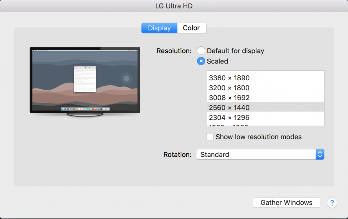

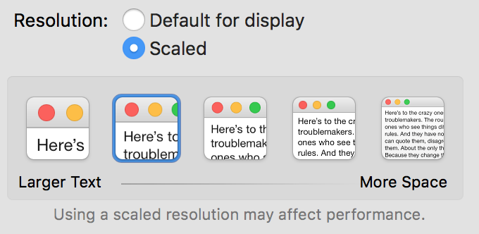

golimpio Posted March 19, 2017 Share Posted March 19, 2017 First of all, thanks wmchris and all people here for creating this incredible helpful topic. I've setup my XPS15 9550 4K using this guide a few months ago and it saved me a lot of time.Now I've replaced my old monitor by a 4K monitor (LG UHD 27UD58) and noticed that the max HiDPI resolution I could get was 1920 x 1080 (which I is too big for a 27" monitor). I was expecting to have an option for 2560 x 1440 (HiDPI) and it simply wasn't there (I could have it in low resolution, but fonts look terrible).I've tried SwitchResX and similar solutions, but they didn't work on Sierra (to add a custom HiDPI 2560 x 1440, I would have to add a second entry doubling this resolution, which is not accepted by Sierra).When testing my monitor with the latest Macbook Pro 13" (cheapest less expensive model), I've noticed that the HiDPI resolution was there. I could set my display to 2560 x 1440 without issues. I guess the main difference is that it's running under the Iris Graphics 540 and mine is HD 530.So I came across this thread:- https://www.tonymacx86.com/threads/thinkcentre-m800-and-4k-display-port-issue.217210/Where the guy have switched the ig-platform-id from 0x19120000 to 0x19260002.I decided to try the same hack and it worked so far... replacing the ig-platform-id by the Iris Graphics 540, have enabled all the HiDPI resolutions for my laptop (in my case I've used: 0x19260004 as it was easier to fix the wake up issue - someone have done it already).I just had to fix the sleep issue (black screen after sleeping):- http://www.insanelymac.com/forum/topic/317993-fix-enable-lid-wake-from-sleep-for-skylake-iris-graphics/It's still too early to say if it will cause any issue as I've been using this hack for a day only.Sorry by the long post, hopefully this will help some one with the same issue. 1 Link to comment https://www.insanelymac.com/forum/topic/319764-guide-dell-xps-15-9550-mojave-1014-1015-quick-installation/page/16/#findComment-2387094 Share on other sites More sharing options...
Krim404 Posted March 19, 2017 Author Share Posted March 19, 2017 Where the guy have switched the ig-platform-id from 0x19120000 to 0x19260002. I decided to try the same hack and it worked so far... replacing the ig-platform-id by the Iris Graphics 540, have enabled all the HiDPI resolutions for my laptop (in my case I've used: 0x19260004 as it was easier to fix the wake up issue - someone have done it already). both GPUs use the same driver, but i'm not sure if its really a good idea to make the system believe it has a faster GPU than available. Please report back after a few days (and please do some stress testing) - if this works fine i'll update the repository and add your changes :-) Link to comment https://www.insanelymac.com/forum/topic/319764-guide-dell-xps-15-9550-mojave-1014-1015-quick-installation/page/16/#findComment-2387123 Share on other sites More sharing options...
abz0 Posted March 20, 2017 Share Posted March 20, 2017 you can change smbios after installation, so as long as it boots up, everything is fine. Please share your experience how you got it booting. I just used the setup of older sierra build 1a* . It installed and booted without any problems. The only problem i had during installation was the setup refused to recognize the enter key but space bar worked as substitute. I was having problems with windows 10 drivers so i just installed macos on a drive with multiboot and left it to try later. Will join you guys later on this. Link to comment https://www.insanelymac.com/forum/topic/319764-guide-dell-xps-15-9550-mojave-1014-1015-quick-installation/page/16/#findComment-2388093 Share on other sites More sharing options...
golimpio Posted March 22, 2017 Share Posted March 22, 2017 both GPUs use the same driver, but i'm not sure if its really a good idea to make the system believe it has a faster GPU than available. Please report back after a few days (and please do some stress testing) - if this works fine i'll update the repository and add your changes :-) It's running stable for a few days now (using ig-platform-id = 0x19260004) - I haven't rebooted my computer since my last post (19 Mar 2017 - 6:29 PM). I don't use any application that uses graphics intensely (no games or video editing). I pretty much use IDE's for software development and photo related tools: Capture One and Adobe Lightroom. I don't know any tool that I could use for doing some stress testing. External display is connected through an usb-c to display port adaptor. I could also ran HDMI 4K 60hz, but only through an adapter (usb-c to HDMI adapter). The HDMI port didn't support 4K 60hz in my case. Link to comment https://www.insanelymac.com/forum/topic/319764-guide-dell-xps-15-9550-mojave-1014-1015-quick-installation/page/16/#findComment-2389214 Share on other sites More sharing options...
