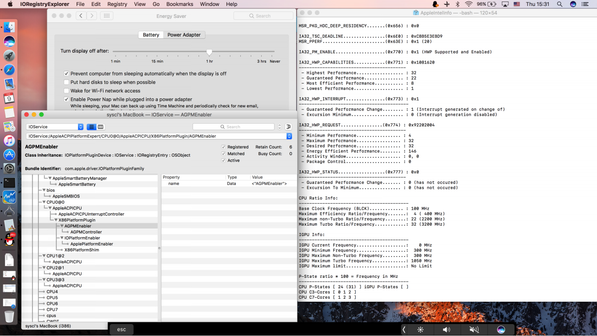

syscl Posted February 9, 2017 Share Posted February 9, 2017 Hi guys how are you? For those who experience incomplete power management, please try this solution http://www.insanelymac.com/forum/topic/321021-guide-hwpintel-speed-shift-enable-with-full-power-management/?do=findComment&comment=2365608 Here's the proof on my XPS 13 9350(Iris 540) hwp with full power management Good luck, syscl 2 Link to comment https://www.insanelymac.com/forum/topic/319764-guide-dell-xps-15-9550-mojave-1014-1015-quick-installation/page/12/#findComment-2365610 Share on other sites More sharing options...
webhappyboy070 Posted February 9, 2017 Share Posted February 9, 2017 Hi guys how are you? For those who experience incomplete power management, please try this solution http://www.insanelymac.com/forum/topic/321021-guide-hwpintel-speed-shift-enable-with-full-power-management/?do=findComment&comment=2365608 Here's the proof on my XPS 13 9350(Iris 540) hwp with full power management Snip20170209_5.png Good luck, syscl thank you for your hard work! Link to comment https://www.insanelymac.com/forum/topic/319764-guide-dell-xps-15-9550-mojave-1014-1015-quick-installation/page/12/#findComment-2365616 Share on other sites More sharing options...

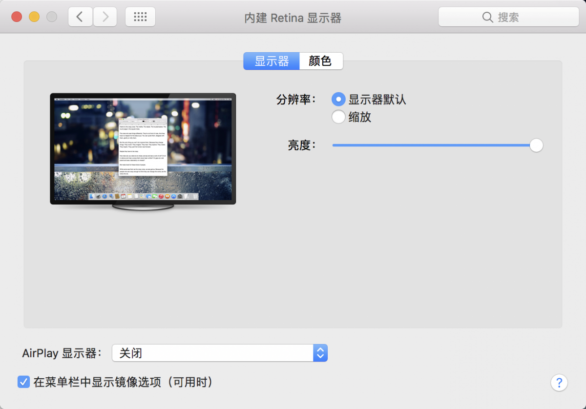

ssbb Posted February 10, 2017 Share Posted February 10, 2017 The 4K screen will appear to under-perform until you complete the optional step in the tutorial. If you check again, there's a bit that says, "OPTIONAL If you have a 4k screen..." and some instructions. I missed this on my first install too. When the OS is first installed, everything is tiny, right? I saw it an went, "Oh, I must have to adjust the display settings" which is wrong. Once you perform the 4K patch, you get proper "retina" scaled screen, and the graphics speed is increased and the tearing completely disappears. The "genie" effect is suddenly silky smooth when it's working properly Just wanted to post here again to say, Thank You, Thank You, Thank You! I'm loving my new Dell Mac! So far it's been near flawless for me, with my Killer WiFi working out of the box, 4K Touchscreen fully functional and even dual-booting with Windows (just for gaming) too! Only my audio jack seems to be not working, and I don't have any USB-C devices or SD cards to test those yet. I think I did a bad thing, but without consequences. I wanted my calendar to be working, so I tried adding my apple account for that app. OS X "helpfully" applied the iCloud account system-wide, which I was not expecting. This happened before I changed my BIOS, serials, or made any other tweaks. Now my hand-off and Facetime seem to be working too... But 2 days later I haven't been banned by Apple. Will I get hit by the ban hammer? Is there anything I can do to prevent this? Or am I just truly lucky and my new "iMac" is okay? I am applied this 4k patches of course I am followed guide very carefully. Now I even tried re-try install step-by-step again. I am really not sure if it's about GPU - minimize effects works great and smooth (and Launchpad now too, can't re-produce it). Of course it is not like on first boot (before Post-Installation section, when Launchpad opens 3-5 secs every time). Also I am changed SMBIOS to Macbook13,3. I am noticed that some errors appears during boot: `Failed to initialize graphics firmware. Falling back to host-side scheduling` Link to comment https://www.insanelymac.com/forum/topic/319764-guide-dell-xps-15-9550-mojave-1014-1015-quick-installation/page/12/#findComment-2365796 Share on other sites More sharing options...

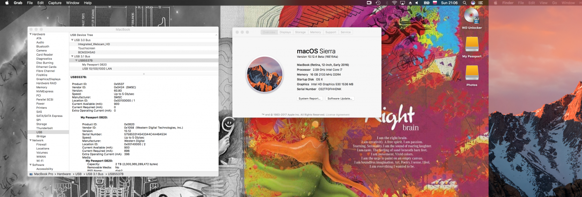

Deniryer Posted February 12, 2017 Share Posted February 12, 2017 When i update to 10.12.3 the USB-C hotplug patch become no use. Have any new patch for USB-C hotplug in 10.12.3? Hot plug (as far the device uses usb 3.1 interface) is working just fine under 10.12.4 public beta 2 and it was working fine under 10.12.3. Are you sure that you have set everything correctly? 1 Link to comment https://www.insanelymac.com/forum/topic/319764-guide-dell-xps-15-9550-mojave-1014-1015-quick-installation/page/12/#findComment-2367273 Share on other sites More sharing options...
