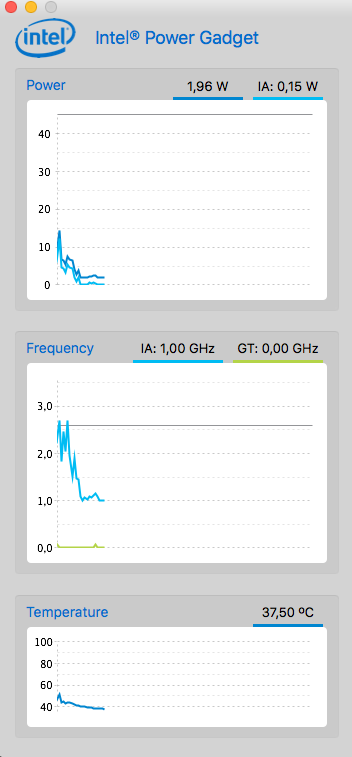

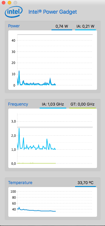

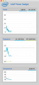

Krim404 Posted March 7, 2017 Author Share Posted March 7, 2017 Micro Tutorial: how to reduce the power consumption in one easy step: disable the SD Card Reader in the EFI. Power consumption with enabled SD Card Reader: 3W in minimum on my machine Power consumption with disabled SD Card Reader: 0.9W in minimum on my machine this can be improved even more if you disable HWP and use more power efficient frequency vectors. EDIT: some screenshots of my 2nd machine. Screen 1: disabled SD Card Reader, Screen 2: enabled SD Card Reader. Link to comment https://www.insanelymac.com/forum/topic/319764-guide-dell-xps-15-9550-mojave-1014-1015-quick-installation/page/15/#findComment-2379825 Share on other sites More sharing options...

KYBOSH Posted March 7, 2017 Share Posted March 7, 2017 This is what my battery consumption looks like: When using internet at full brightness, about 16-17 watts (using my mobile connected via USB for tethering) When fully idle, mobile detached, all windows CLOSED/QUIT: 9-10watts Using intel software its 2.5-4watts watts either way. With that said, could you possibly tell me how to disable that SD card reader in EFI. Is cool if you can't. Thanks. See screenshots In the BIOS (hit F2 upon startup) there is an option under the power saving tab to turn it on/off. 1 Link to comment https://www.insanelymac.com/forum/topic/319764-guide-dell-xps-15-9550-mojave-1014-1015-quick-installation/page/15/#findComment-2379869 Share on other sites More sharing options...

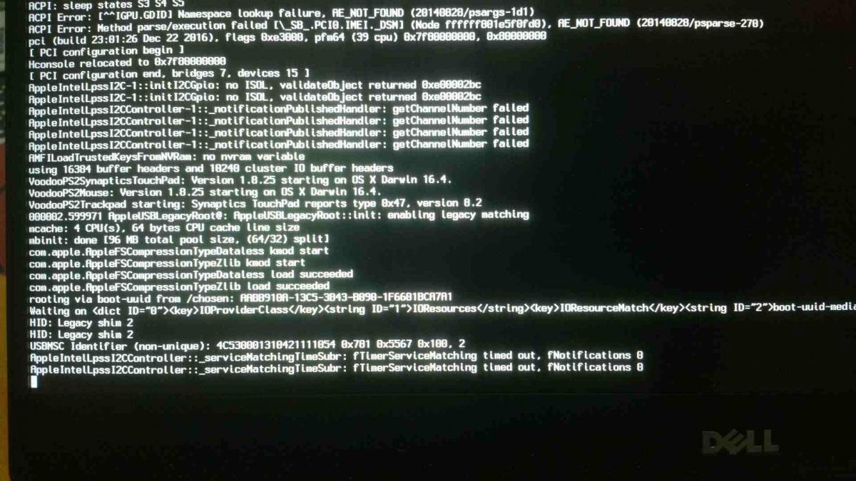

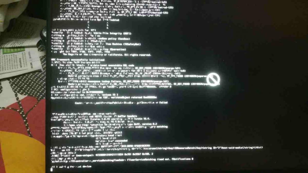

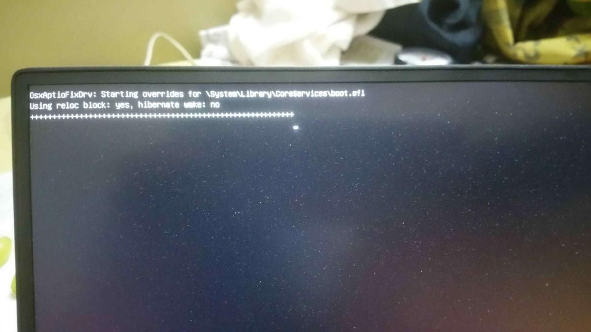

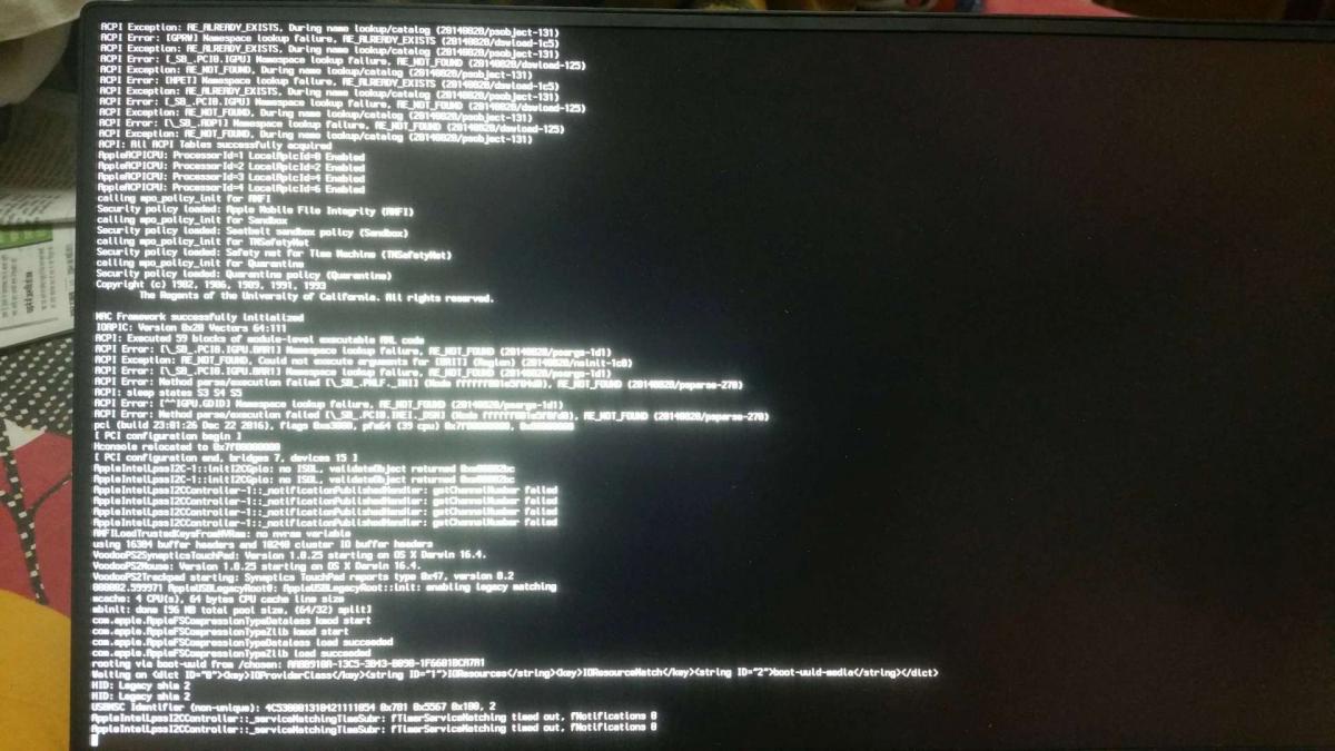

abz0 Posted March 10, 2017 Share Posted March 10, 2017 I am getting a problem with garbled screen . I created an EFI bootable drive with BDU , macOS_10.12.3_(16D32) on 16gb flash disk. I used the suggested BIOS settings and tried changing a few options here and there according to @wmchris post but it didn't work. Config : 9560 , i5 7300HQ , FHD , 1TB HDD with 32gb m2 cache drive. Is there a SMBIOS change that i should make? Link to comment https://www.insanelymac.com/forum/topic/319764-guide-dell-xps-15-9550-mojave-1014-1015-quick-installation/page/15/#findComment-2381955 Share on other sites More sharing options...
Krim404 Posted March 12, 2017 Author Share Posted March 12, 2017 I am getting a problem with garbled screen . I created an EFI bootable drive with BDU , macOS_10.12.3_(16D32) on 16gb flash disk. I used the suggested BIOS settings and tried changing a few options here and there according to @wmchris post but it didn't work. Config : 9560 , i5 7300HQ , FHD , 1TB HDD with 32gb m2 cache drive. Is there a SMBIOS change that i should make? the supplied files are for 9550, its possible the 9560 requires more in detail tweaking of the SSDTs. Link to comment https://www.insanelymac.com/forum/topic/319764-guide-dell-xps-15-9550-mojave-1014-1015-quick-installation/page/15/#findComment-2382891 Share on other sites More sharing options...
abz0 Posted March 12, 2017 Share Posted March 12, 2017 the supplied files are for 9550, its possible the 9560 requires more in detail tweaking of the SSDTs. I managed to find a solution and the flash successfully boots to a setup . Before going ahead i want to confirm if i should go ahead with the default SMBIOS configuration in clover ? It mentions macbook air Link to comment https://www.insanelymac.com/forum/topic/319764-guide-dell-xps-15-9550-mojave-1014-1015-quick-installation/page/15/#findComment-2382971 Share on other sites More sharing options...
Krim404 Posted March 12, 2017 Author Share Posted March 12, 2017 I managed to find a solution and the flash successfully boots to a setup . Before going ahead i want to confirm if i should go ahead with the default SMBIOS configuration in clover ? It mentions macbook air you can change smbios after installation, so as long as it boots up, everything is fine. Please share your experience how you got it booting. Link to comment https://www.insanelymac.com/forum/topic/319764-guide-dell-xps-15-9550-mojave-1014-1015-quick-installation/page/15/#findComment-2382980 Share on other sites More sharing options...
