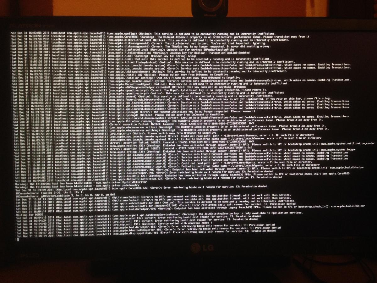

Can someone please tell me why I'm seeing this? My specs in my signature.
Your USB ports are not assigned correctly. ... This can either be corrected by dsdt patch or via USB drivers from rehabman (in part). Read some of the threads dealing with the problem under El Capitan respectively under Sierra.
I don't understand 10.12 again.
I've made install partition on my hd (restoring basesystem.dmg with added packages from appstore dmg), put Shaneee 10.12.3 kernel, replaced system.kext, renamed applecpupm, appletymcedriver and pmtelemetry to kext.bak, installed carlo67 usb fix and recreate caches with kext wizard).
Boot takes time, and shows timeout on AppleACPI and USB 2.0 240s.
After that I have white screen with rainbow circle and nothing. Is that NVidia bug or what?
Update: just tested with nv_disable=1 in boot arguments - the same effect: endless white screen after graphics start...

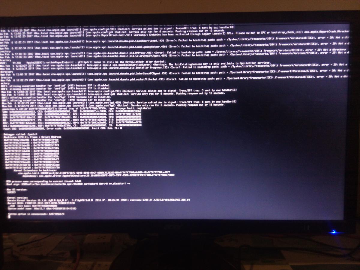

Hi guys, I did this:
-use a Pandora's Box for create the usb installer from 10.12
- use Disk Utility for create 10GB partition, restore it usb installer created with pandora
- copy Bronya kernel on /System/Library/Kernels
- merge IOKit.framework, System.framework and Kernel.framework in /System/Library/Frameworks
- delete AppleIntelCPUPowerManagment.kext, pmtelemetry.kext and AppleTyMCEdriver.kext from /System/Library/Extentions
- copy System.kext from Bronya kernel tarball to /System/Library/Extentions
- copy latest versions of FakeSMC, NullCPUPowerManagment and GeneralUSBXHCI to /System/Library/Extentions
- copy all kext in USBFix v3 (Shaneee version - look in amd development) tarball to /System/Library/Extentions
- copy PlatformSupport.plist in System/Library/CoreServices
- install and configure Clover on HDD
- repair permission and regenerate cache
- reboot and choose Sierra Installer partition on Clover
The installation has shown some xpc loop but has properly started.
But I get KP when I try to boot into the installer.
HW: Asrock 990fx Fatal1ty 3.0 FX 8320E and RX480
Boot args: USBBusFix=Yes npci=0x3000 dartwake=0 dart=0 -v
Can anyone explain me why i get this KP, thanks !

Can it be that you have installed two iousbfamily.kext? Check the contents of Extra/Extensions as well as S/L/E.

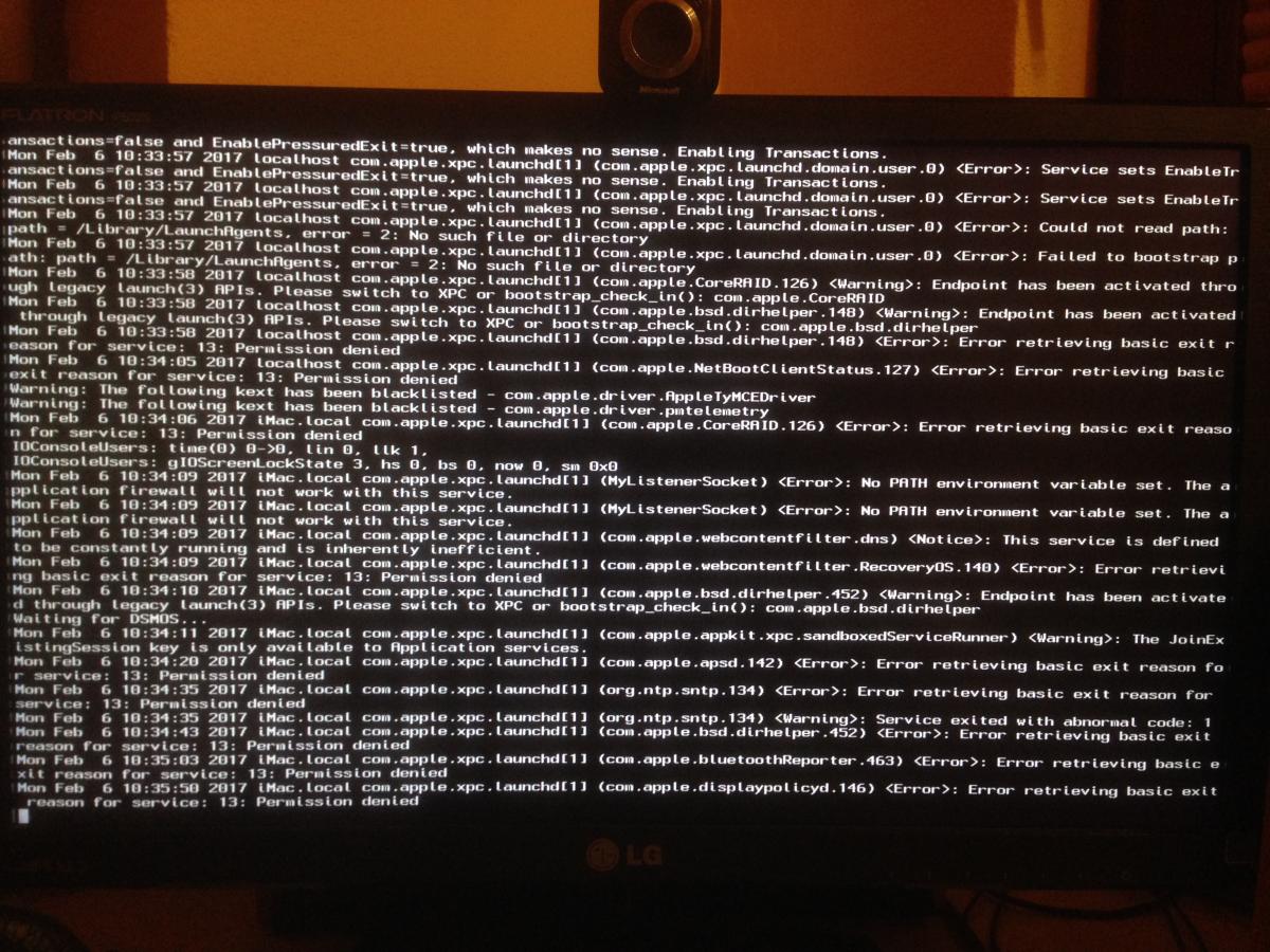

Hello,
Im stuck at screen in attached files. Im using Shanees kernel, Enoch bootloader (rev.2839) and Sierra 10.12.
I restored OS X Base system to USB
copied Packages folder
installed Enoch
copied kernel to S/L/Kernels and system.kext to S/L/E
replaced Extra folder (with only FakeSMC and NullCPUPowerManegement kexts)

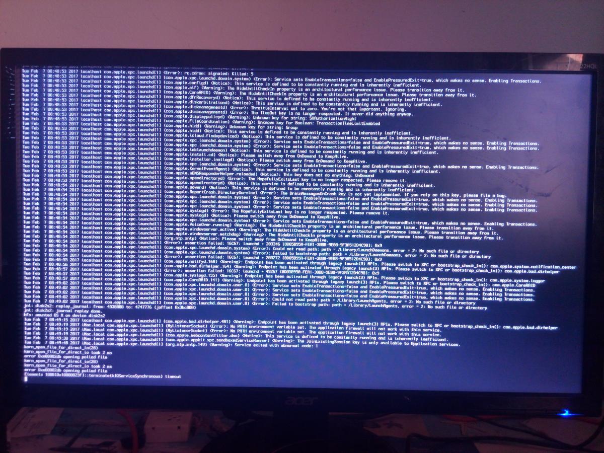

Hi, I have made a new Installer with 10.12.2
- restore BaseSystem.dmg ecc...
- install Enoch
- copy Bronya 10.12.1 kernel in S/L/K and install System.kext (I didn't install frameworks because they cause other errors)
- Shanee V3 USB Fix
- rebuild cache and fix permissions
When I try to start it, after 1 minute my system goes in sleep mode during the boot, but it haven't a KP
I put my extra folder and the error screen in attached files

@D4sh3r, use the Extra folder in the attachment

try to boot with: -v npci=0x3000 UseKernelCache=NO nv_disable=1

A funny loop, I have not seen so far. Do not use many USB drivers at the same time. Test it step by step
1. without patched USB FIX drivers only with Rehabman "GenericUSBXHCI.kext" in Extra/Extensions/ ... check now the behavior of the boot
2. with patched USB-FIX_V3 and with Rehabman "GenericUSBXHCI.kext" in Extra/Extensions/ ... check now the behavior of the booting
FakeSMC and NullPowerManagement.kext must always be installed in Extra / Extensions

ok i want to install sierra but i have an invalid kernel op code 64bit its because my cpu is too old?
No, that must be other cause of the invalid opcode error because your CPU contains all the necessary CPU instructions. Possibly driver's caused the problem? ....probably you are using an incorrect kernel? you should use FX kernel for your cpu

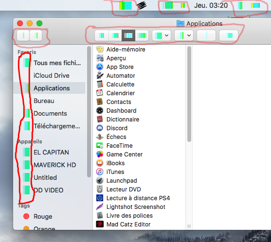

i everyone , i installed el capitan for installing sierra , but i have a problem any icon is green and i dont know why you have an idea for fix that?
http://prnt.sc/e6cns5
Please write El Capitan questions in the El Capitan help topic, the glitchy icons problem under FX CPUSs and some APUs was discussed a thousand times. Please read the appropriate lines
My kernels seem to have an issue showing the opcode error when the prelinkedkenrel isn't present. If it's there then it doesn't have this error.
