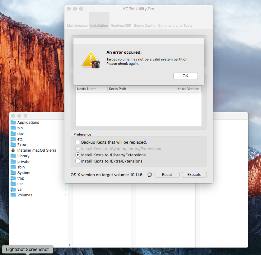

railledingue Posted February 10, 2017 Share Posted February 10, 2017 Generate the prelinked kernel by means of terminal code from El capitan to your USB stick, or use this tool: Http://www.insanelymac.com/forum/topic/317619-help-topic-amd-macos-sierra-amd-cpu-1012x/page-15#entry2357615 ok so i dl your tool but i have an error , i click on my usb stick and i click choose but a i have this message , any ideas? http://prnt.sc/e76x1v Link to comment Share on other sites More sharing options...
spakk Posted February 11, 2017 Author Share Posted February 11, 2017 I forgot to mention that: It can only be applied to an installed version not applicable to a usb installer. Use eg. Pacifist.app to expand / install the data from the installer app to a free partition. Then you can apply the app. Link to comment Share on other sites More sharing options...

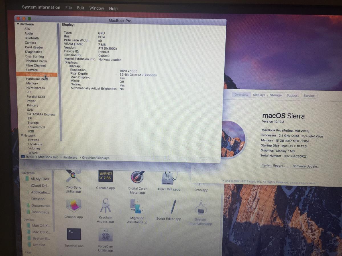

Mundane1026 Posted February 16, 2017 Share Posted February 16, 2017 Thanks shaneee, ur kernels have work great with my system. I'm new to hackintosh and I wanted to test and please my curiosity. Everything works fine and didn't ran into any issues. I know I have to wait but my video card won't work correctly.(Getting icon glitch )and WiFi don't work. My specs: Acer Laptop CPU: A12-9700P VC: AMD R7 series integrated not sure of the model and it has a dedicated GPU R8 445dx HD: 128GB SSD m.2 + 1TB HD. RAM: 16GB OS: Win10, MacOS X 10.10.5, MacOS X 10.11.6, MacOS X 10.12.3. Link to comment Share on other sites More sharing options...
spakk Posted February 17, 2017 Author Share Posted February 17, 2017 Thanks shaneee, ur kernels have work great with my system. I'm new to hackintosh and I wanted to test and please my curiosity. Everything works fine and didn't ran into any issues. I know I have to wait but my video card won't work correctly.(Getting icon glitch )and WiFi don't work. My specs: Acer Laptop CPU: A12-9700P VC: AMD R7 series integrated not sure of the model and it has a dedicated GPU R8 445dx HD: 128GB SSD m.2 + 1TB HD. RAM: 16GB OS: Win10, MacOS X 10.10.5, MacOS X 10.11.6, MacOS X 10.12.3. Use systeminfo.app tool and post the image with all vendor-id's and device-id's Link to comment Share on other sites More sharing options...
Mundane1026 Posted February 17, 2017 Share Posted February 17, 2017 Use systeminfo.app tool and post the image with all vendor-id's and device-id'sHey Spakk, System only reads/detects the dedicated GPU. also, the sysinfo won't detect the wifi. But wireless card installed on the system is a Atheros QCA9377. I tried looking for driver but to no avail. Link to comment Share on other sites More sharing options...
spakk Posted February 18, 2017 Author Share Posted February 18, 2017 It is advisable to install/change a wireless half-mini wifi card, see README.md of Toleda, here are some Wifi cards listed and also the appropriate driver Https://github.com/toleda/wireless_half-mini For your AMD graphics card write the question in the thread for graphics cards list of AMD Dev-ID/Vendor-ID (MD Radeon R7 Graphics card, Device-id 9874 Vendor-id 00C9 ) : http://developer.amd.com/resources/ati-catalyst-pc-vendor-id-1002-li/ No idea, if your graphics card can work with graphics acceleration using dsdt or driver patch. You have to ask for or research and/or try it out for yourself. or read here, maybe it can help: Http://www.insanelymac.com/forum/topic/291117-how-to-make-radeon-desktop-or-mobility-be-working-by-using-clover/ Link to comment Share on other sites More sharing options...
Mundane1026 Posted February 18, 2017 Share Posted February 18, 2017 It is advisable to install/change a wireless half-mini wifi card, see README.md of Toleda, here are some Wifi cards listed and also the appropriate driver Https://github.com/toleda/wireless_half-mini For your AMD graphics card write the question in the thread for graphics cards list of AMD Dev-ID/Vendor-ID (MD Radeon R7 Graphics card, Device-id 9874 Vendor-id 00C9 ) : http://developer.amd.com/resources/ati-catalyst-pc-vendor-id-1002-li/ No idea, if your graphics card can work with graphics acceleration using dsdt or driver patch. You have to ask for or research and/or try it out for yourself. or read here, maybe it can help: Http://www.insanelymac.com/forum/topic/291117-how-to-make-radeon-desktop-or-mobility-be-working-by-using-clover/ Thanks for the info spakk, For the wifi, it doesn't bug me. I found a work around. At home I use Ethernet and when I'm out side I use an external wifi that is compatible. Just glad I got my USB 3.0 to work. Also, I've was looking oh how to edit the kext before with the link you provided but I still need to learn and use clover, at the moment I'm not running EFI. I do have the updated version of clover app on my system, I have not yet uploaded the boot loader for EFI. I need to learn a little more before making those changes. Link to comment Share on other sites More sharing options...

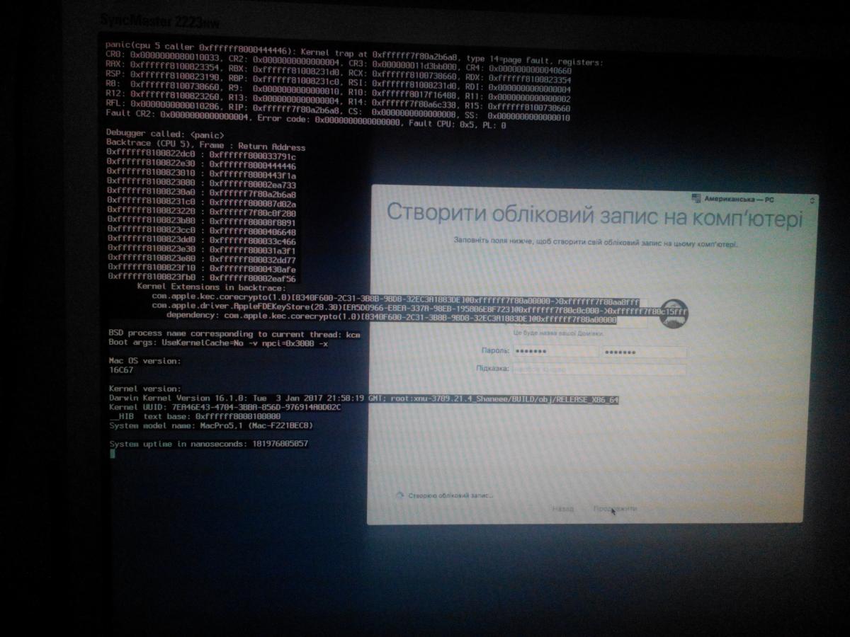

bennington111 Posted February 20, 2017 Share Posted February 20, 2017 Hi all. help me please fix kernel panic, after create user account. I install Sierra like this guide: https://www.youtube.com/watch?v=8TbByEQFdFg And this: https://www.youtube.com/watch?v=Bak5MHgK0Jk and this step: http://forum.amd-osx.com/viewtopic.php?f=24&t=76 But kernel panic on account creation. 1 Link to comment Share on other sites More sharing options...
