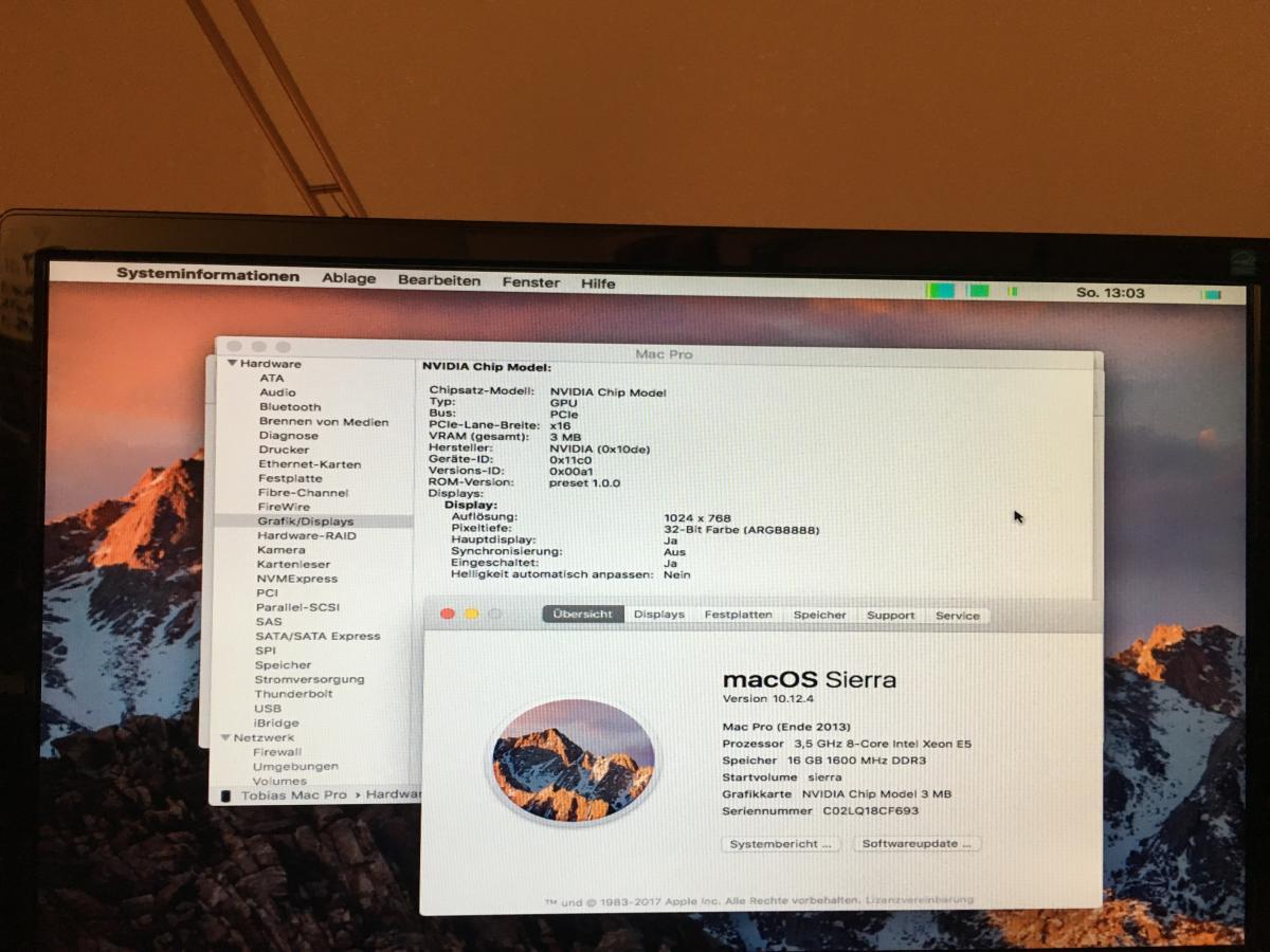

chip100 Posted May 7, 2017 Share Posted May 7, 2017 I have some problems with my NvidiaWebdrivers (see picture). My hackintosh doesn't use my web divers, only the mac os x default graphics driver. When I will use the web drivers I reboot and then nothing happens. Link to comment Share on other sites More sharing options...
Shaneee Posted May 7, 2017 Share Posted May 7, 2017 I have some problems with my NvidiaWebdrivers (see picture). My hackintosh doesn't use my web divers, only the mac os x default graphics driver. When I will use the web drivers I reboot and then nothing happens. What bootloader? Sent from my SM-G920F using Tapatalk Link to comment Share on other sites More sharing options...
chip100 Posted May 7, 2017 Share Posted May 7, 2017 It's the enoch 2877 Bootloader. Link to comment Share on other sites More sharing options...
Shaneee Posted May 7, 2017 Share Posted May 7, 2017 It's the enoch 2877 Bootloader. Boot with NVIDIAWebDrv=Yes Sent from my SM-G920F using Tapatalk 2 Link to comment Share on other sites More sharing options...

chip100 Posted May 8, 2017 Share Posted May 8, 2017 Ok I tried booting with this bootflag but I get a black screen. I also tried to boot with different bootflags: nv_disable=1 and GraphicsEnabler=Yes but I always get a black screen when I'm not booting with nv_disable=1. And only the dvi output works. For the gtx 660 I don't need to install the webdrivers? Does this graphics card run oob? Link to comment Share on other sites More sharing options...
ArgenLant Posted May 8, 2017 Share Posted May 8, 2017 Ok I tried booting with this bootflag but I get a black screen. I also tried to boot with different bootflags: nv_disable=1 and GraphicsEnabler=Yes but I always get a black screen when I'm not booting with nv_disable=1. And only the dvi output works. For the gtx 660 I don't need to install the webdrivers? Does this graphics card run oob? As I know all graphics cards with GK1xx gpus should work oob, but in some cases you need to patch AGPM or use Lilu+NvidiaGraphicsFixup kexts Link to comment Share on other sites More sharing options...
chip100 Posted May 8, 2017 Share Posted May 8, 2017 Do you have any link or so for me? I just found this: http://www.insanelymac.com/forum/files/file/645-applegraphicspowermanagementkext/ . Link to comment Share on other sites More sharing options...
ArgenLant Posted May 8, 2017 Share Posted May 8, 2017 Do you have any link or so for me? I just found this: http://www.insanelymac.com/forum/files/file/645-applegraphicspowermanagementkext/ . https://github.com/vit9696/Lilu/releases- for lilu.kext https://sourceforge.net/projects/nvidiagraphicsfixup/- for NvidiaGraphicsFixup.kext (plugin for Lilu) http://www.insanelymac.com/forum/topic/321371-lilu-—-kext-and-process-patcher/- discussion on this forum both Lilu.kext and NvidiaGraphicsFixup.kext should be placed in /Extra/Extensions for Enoch/Chameleon or in EFI/Clover/kexts/10.12/ for Clover 1 Link to comment Share on other sites More sharing options...
chip100 Posted May 8, 2017 Share Posted May 8, 2017 Thank you very very much! Now all monitors are working. But I also have a problem with my sound chip it's the Realtek alc892 and I didn't find any driver for it only for alc1220 or alc887. Link to comment Share on other sites More sharing options...
