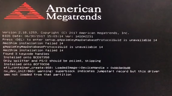

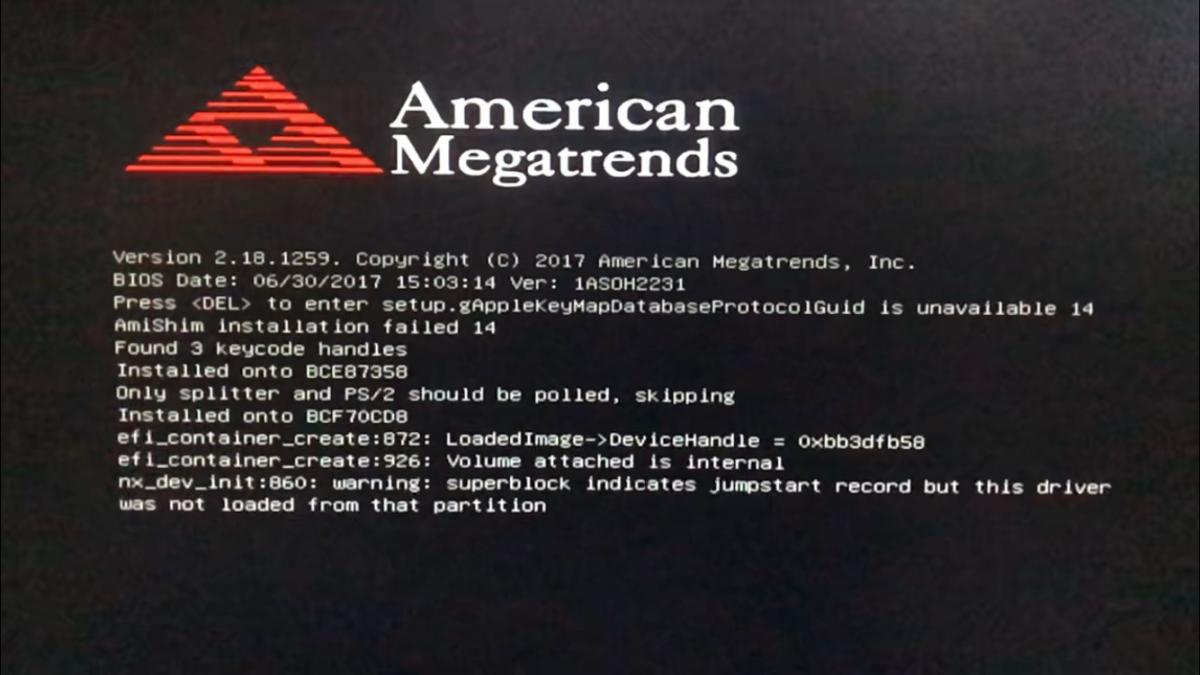

PMheart Posted October 31, 2017 Share Posted October 31, 2017 I still get the same errors... Maybe the patch was not for my specific issue. Anyway, I still get: gAppleKeyMapDatabaseProtocolGuid is unavailable 14 AmiShim installation failed 14... Also, something about "Found 3 keycode handles", something about splitter and PS/2 that should be polled....whatever that means... And some other things that might actually belong to APFS. Anyway, here's another screenshot. Image-1.jpg Hi. Indeed. And it's quite weird though: gAppleKeyMapDatabaseProtocolGuid is unavailable 14 AmiShim installation failed 14 With my patched version of AsAmiShim above, these two error lines should just be gone. I'll check other entries and send you another patched efi. EDIT: Oops. I've somehow started doubting if you're using my patched efi above. Are you sure? From the searches here I can't even trace any log which you got. And I did see *"AmiShim"* logs in your picture... Maybe not the place to ask this question, but can clover patch those *.efi files in memory? apfs has debug messaging on also. Sorry. I'm not sure. Not a Clover developer. *STARTING OFF-TOPIC* In my opinion, will it be better to properly import apfsjumpstart protocol instead of patching apfs.efi itself? Link to comment https://www.insanelymac.com/forum/topic/317290-filevault-2/page/9/#findComment-2525791 Share on other sites More sharing options...

arsradu Posted November 1, 2017 Share Posted November 1, 2017 Hi. Indeed. And it's quite weird though: gAppleKeyMapDatabaseProtocolGuid is unavailable 14 AmiShim installation failed 14 With my patched version of AsAmiShim above, these two error lines should just be gone. I'll check other entries and send you another patched efi. EDIT: Oops. I've somehow started doubting if you're using my patched efi above. Are you sure? From the searches here I can't even trace any log which you got. And I did see *"AmiShim"* logs in your picture... Well, I am using it, yes. But...maybe there's another driver causing this issue? Attached is the content of my drivers64UEFI folder. Maybe I missed something. drivers64UEFI.zip Link to comment https://www.insanelymac.com/forum/topic/317290-filevault-2/page/9/#findComment-2526676 Share on other sites More sharing options...
PMheart Posted November 2, 2017 Share Posted November 2, 2017 Well, I am using it, yes. But...maybe there's another driver causing this issue? Attached is the content of my drivers64UEFI folder. Maybe I missed something. First of all, sorry for my late reply. I've been kind of busy these days. I guess AptioInputFixB2.efi and AsAmiShim.efi are identical. (They might be supposed to do the same thing) Now with my patched AsAmiShim.efi you do not need AptioInputFixB2.efi anymore. Simply get to remove it. By the way. As for apfs.efi log elimination, you can also try this one: #45 1 Link to comment https://www.insanelymac.com/forum/topic/317290-filevault-2/page/9/#findComment-2527517 Share on other sites More sharing options...
arsradu Posted November 2, 2017 Share Posted November 2, 2017 First of all, sorry for my late reply. I've been kind of busy these days. I guess AptioInputFixB2.efi and AsAmiShim.efi are identical. (They might be supposed to do the same thing) Now with my patched AsAmiShim.efi you do not need AptioInputFixB2.efi anymore. Simply get to remove it. By the way. As for apfs.efi log elimination, you can also try this one: #45 Looks like that was the culprit. Thank you very much for your help. 1 Link to comment https://www.insanelymac.com/forum/topic/317290-filevault-2/page/9/#findComment-2527526 Share on other sites More sharing options...
