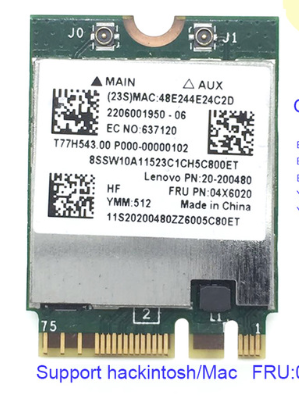

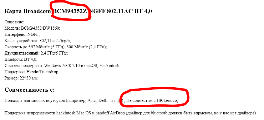

poison44rus Posted June 20, 2020 Share Posted June 20, 2020 (edited) Hello!! is the BCM94352Z module compatible with Lenovo??the aliexpress website says that it is not compatible. Where can I buy such a cheaper module??Are there any other compatible modules?? Spoiler Edited June 20, 2020 by poison44rus Link to comment https://www.insanelymac.com/forum/topic/315451-guide-lenovo-t460t470-macos-with-clover-and-opencore/page/50/#findComment-2726137 Share on other sites More sharing options...

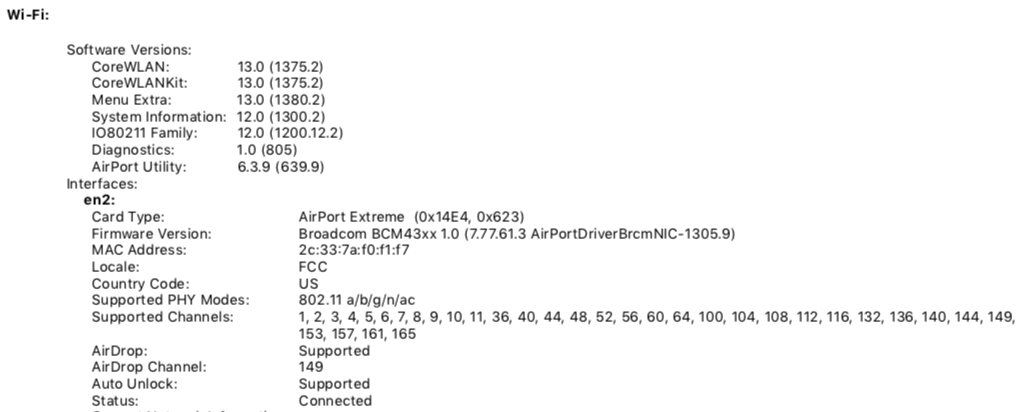

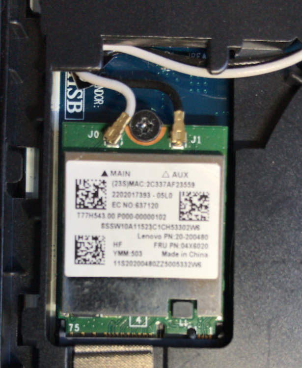

verleihnix Posted June 23, 2020 Share Posted June 23, 2020 (edited) 7 hours ago, jmj662 said: verleihnix, Thank you! Fun thing, I used your EFI and my i5-7300U T470s worked on OC right out of the gate! All I had to do was move my serial numbers over from my Clover build and Vola. I am however not getting the WiFi to fire off. Do you have an internal one on your T470, or did you use a USB dongle? I added AirportBrcmFixup.kext (ver 2.0.4) to your kext folder (as well as the 3 Bluetooth fix kexts), but it didn't get things going. That is what my WiFi uses on my Clover build. I have retrofitted a Broadcom BCM43xx into my T470s. Any suggestions what to do next to get built in WiFi going? (oh and the T470s touch pad on OC acts a bit wonky too, I had to cross that bridge with Clover before, but can't remember exactly what I did to fix) did you enabled the kext in OC config.plist? I am using an original Apple wifi module. Edited June 23, 2020 by verleihnix Link to comment https://www.insanelymac.com/forum/topic/315451-guide-lenovo-t460t470-macos-with-clover-and-opencore/page/50/#findComment-2726378 Share on other sites More sharing options...
jmj662 Posted June 25, 2020 Share Posted June 25, 2020 (edited) On 6/20/2020 at 2:40 AM, poison44rus said: Hello!! is the BCM94352Z module compatible with Lenovo??the aliexpress website says that it is not compatible. Where can I buy such a cheaper module??Are there any other compatible modules?? Reveal hidden contents Per the suggestion from verleihnix I am going to try this combo in my T470 and it won't require injected kexts because it is native apple OS supported (adapter and card): https://www.amazon.com/bcm94360cs2-bcm943224pciebt2-tarjeta-inalámbrica-M-2-clave-adaptador-Macbook/dp/B073W8VKMB/ref=asc_df_B073W8VKMB/?tag=hyprod-20&linkCode=df0&hvadid=309839904427&hvpos=&hvnetw=g&hvrand=11069449132966046989&hvpone=&hvptwo=&hvqmt=&hvdev=c&hvdvcmdl=&hvlocint=&hvlocphy=9032917&hvtargid=pla-589256732612&psc=1&tag=&ref=&adgrpid=65358806527&hvpone=&hvptwo=&hvadid=309839904427&hvpos=&hvnetw=g&hvrand=11069449132966046989&hvqmt=&hvdev=c&hvdvcmdl=&hvlocint=&hvlocphy=9032917&hvtargid=pla-589256732612 https://www.amazon.com/gp/product/B07BQ976CR/ref=ox_sc_saved_title_2?smid=A3DC58VE7Y4F0H&psc=1 Edited June 28, 2020 by jmj662 Link to comment https://www.insanelymac.com/forum/topic/315451-guide-lenovo-t460t470-macos-with-clover-and-opencore/page/50/#findComment-2726747 Share on other sites More sharing options...
Max.1974 Posted June 25, 2020 Share Posted June 25, 2020 Im use this card on my E470 and works fine!!! 2 Link to comment https://www.insanelymac.com/forum/topic/315451-guide-lenovo-t460t470-macos-with-clover-and-opencore/page/50/#findComment-2726750 Share on other sites More sharing options...
verleihnix Posted June 25, 2020 Share Posted June 25, 2020 7 hours ago, jmj662 said: Per the suggestion from verleihnix I am going to try this combo in my T470 and it won't require injected kexts because it is native apple OS supported (adapter and card): Be careful, your link shows a CSAX which is longer than CS2 and uses 3 antennas Link to comment https://www.insanelymac.com/forum/topic/315451-guide-lenovo-t460t470-macos-with-clover-and-opencore/page/50/#findComment-2726782 Share on other sites More sharing options...
jmj662 Posted June 28, 2020 Share Posted June 28, 2020 (edited) On 6/25/2020 at 12:06 AM, verleihnix said: Be careful, your link shows a CSAX which is longer than CS2 and uses 3 antennas Thanks for the heads up. I updated the link to the correct $30 Apple BCM94360CS2 WiFi Bluetooth Airport Wireless Card. Thanks also for the realization that a $17 adapter existed for going from the Apple native BCM94360CS2 Card to a NGFF(M.2) Key A/E Adapter for native Mac OS Hackintosh. It works really well. The only other thing that wonky in your OC build continues to be the clickpad and it's upper buttons on the T470s. Have you been seeing the same thing? My Clover build works great, giving me full functionality. I tried to put in my VoodPS2Controller kext (1.9.2) from my clover build into your OC build, but it didn't help. It has to be in the SSDT's? I am still learning that topic and certainly not to the point that I can edit the ones you have. So, how does your T470 touchpad work? Fully functional with left and right button menus or a bit goofy? I am now reading back into last September of 2019 in this tread and this was a topic. Edited June 28, 2020 by jmj662 1 Link to comment https://www.insanelymac.com/forum/topic/315451-guide-lenovo-t460t470-macos-with-clover-and-opencore/page/50/#findComment-2727660 Share on other sites More sharing options...
