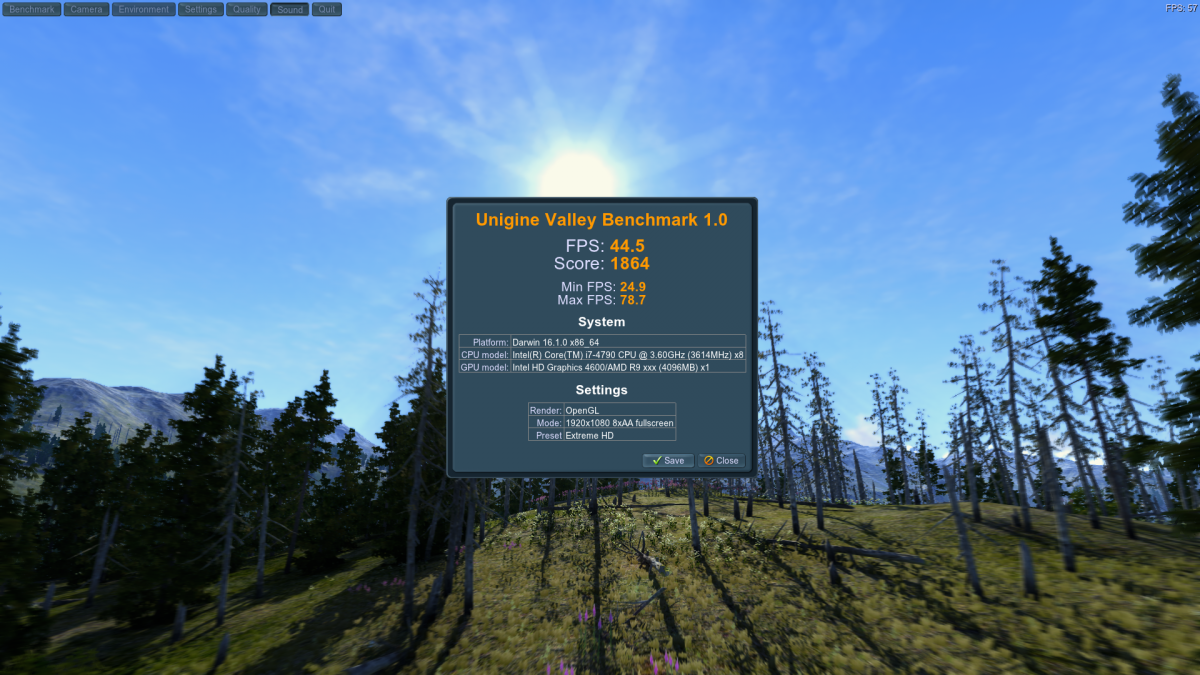

Pavo Posted October 3, 2016 Share Posted October 3, 2016 10.12.1 beta 3 results: 1 Link to comment https://www.insanelymac.com/forum/topic/312582-amd-polaris-ids-on-sierra-high-sierra/page/8/#findComment-2292022 Share on other sites More sharing options...
Tusskan Posted October 3, 2016 Share Posted October 3, 2016 10.12.1 beta 3 results: That's cool, i wonder if i still need igpu enabled to run my R9 290X with hackintosh. Link to comment https://www.insanelymac.com/forum/topic/312582-amd-polaris-ids-on-sierra-high-sierra/page/8/#findComment-2292039 Share on other sites More sharing options...
Pavo Posted October 3, 2016 Share Posted October 3, 2016 That's cool, i wonder if i still need igpu enabled to run my R9 290X with hackintosh. For the last time, this is not an Apple issue, this is a boot loader issue. 2 Link to comment https://www.insanelymac.com/forum/topic/312582-amd-polaris-ids-on-sierra-high-sierra/page/8/#findComment-2292141 Share on other sites More sharing options...
stehor Posted October 3, 2016 Share Posted October 3, 2016 valley results from sapphire nitro+oc rx480 4GB beta3 Link to comment https://www.insanelymac.com/forum/topic/312582-amd-polaris-ids-on-sierra-high-sierra/page/8/#findComment-2292232 Share on other sites More sharing options...

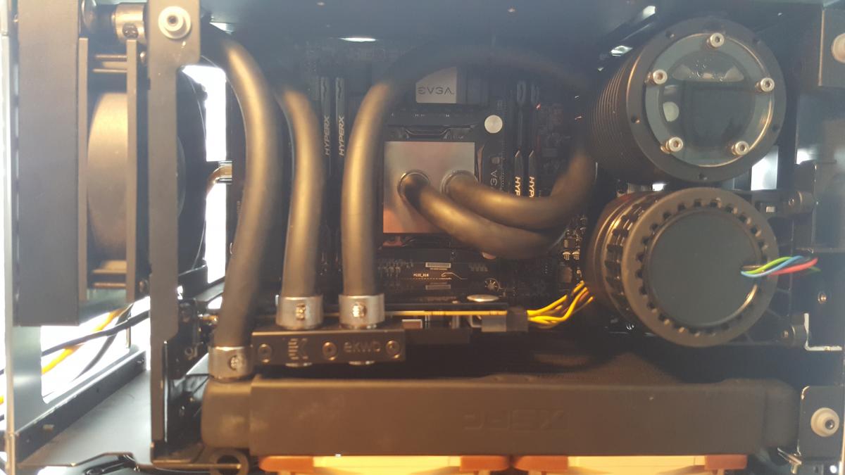

MattsCreative Posted October 15, 2016 Share Posted October 15, 2016 x99 isn't recommended for os x by any sane hack users and until apple finishes the rx480 or clover issues are fixed you need the igpu to use this card 20160812_144825.jpg The Fury and nano won't accelerate without starting from integrated graphics, it seems. The X99 doesn't have this. By other graphics I meant integrated. Also I've made my PC so that it only fits a single tiny watercooled card Link to comment https://www.insanelymac.com/forum/topic/312582-amd-polaris-ids-on-sierra-high-sierra/page/8/#findComment-2300143 Share on other sites More sharing options...
