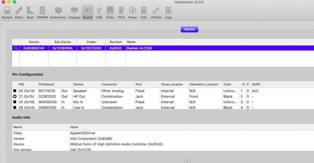

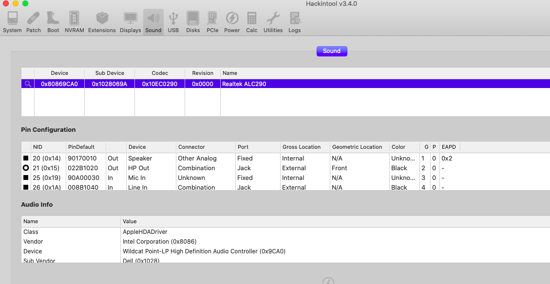

deryrochiman Posted June 29, 2020 Share Posted June 29, 2020 (edited) Hello guys, ive been trying in hackintosh 1 week later. the problem had to resolve now only about audio. I use AppleALC Audio described as guide with ALC290 codec on my dell vostro 5480, been trying all supported layout id 3,4,28 for that device but problem still same. internal speaker volume is low, compare to windows i think about 20%. It also happen to low volume input mic too. i think is only affect on internal speaker, cause when i use headphone, volume and clarity is good enough. AppleALC.kext + lilu install to /L/E folder, with essential kext in clover/kext/other. can anybody helps me with that ? i hope my laptop subwoofer would work to.. sorry for my bad grammar in english . i attach codec_dump from linux ubuntu and some debug file codec_dump_2.txt debug_23539.zip debug_23539.zip Edited July 7, 2020 by deryrochiman Link to comment Share on other sites More sharing options...

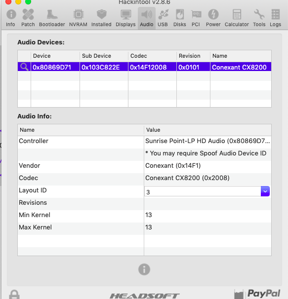

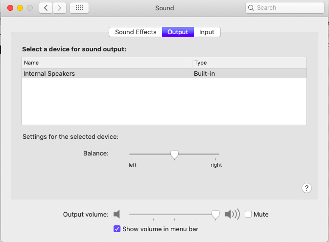

robi62 Posted July 6, 2020 Share Posted July 6, 2020 (edited) hi guys I can't seem to get headphone working on my hp 440 g4 Mojave .conexant cx8200 I tried all different alc posted here but same result. When I plug in iphone headphones not recognised but the mic from it works from it. I use stock applehda lilu alc and codec commander all loaded . I use rehabman hot patch for clover .Every thing works but no headphones Im going crazy trying to make it work but no luck Should something be in clover config??? I have this in Rehabman config Don't know what to try anymore I enclose audio device id <key>Devices</key> <dict> <key>Audio</key> <dict> <key>Inject</key> <integer>0</integer> </dict> <key>Properties</key> <dict> <key>PciRoot(0)/Pci(0x02,0)</key> <dict> <key>framebuffer-con1-alldata</key> <data> AQUKAAAIAACHAQAAAgQKAAAIAACHAQAA </data> <key>framebuffer-con1-enable</key> <integer>1</integer> <key>framebuffer-patch-enable</key> <integer>1</integer> </dict> Edited July 6, 2020 by robi62 Link to comment Share on other sites More sharing options...

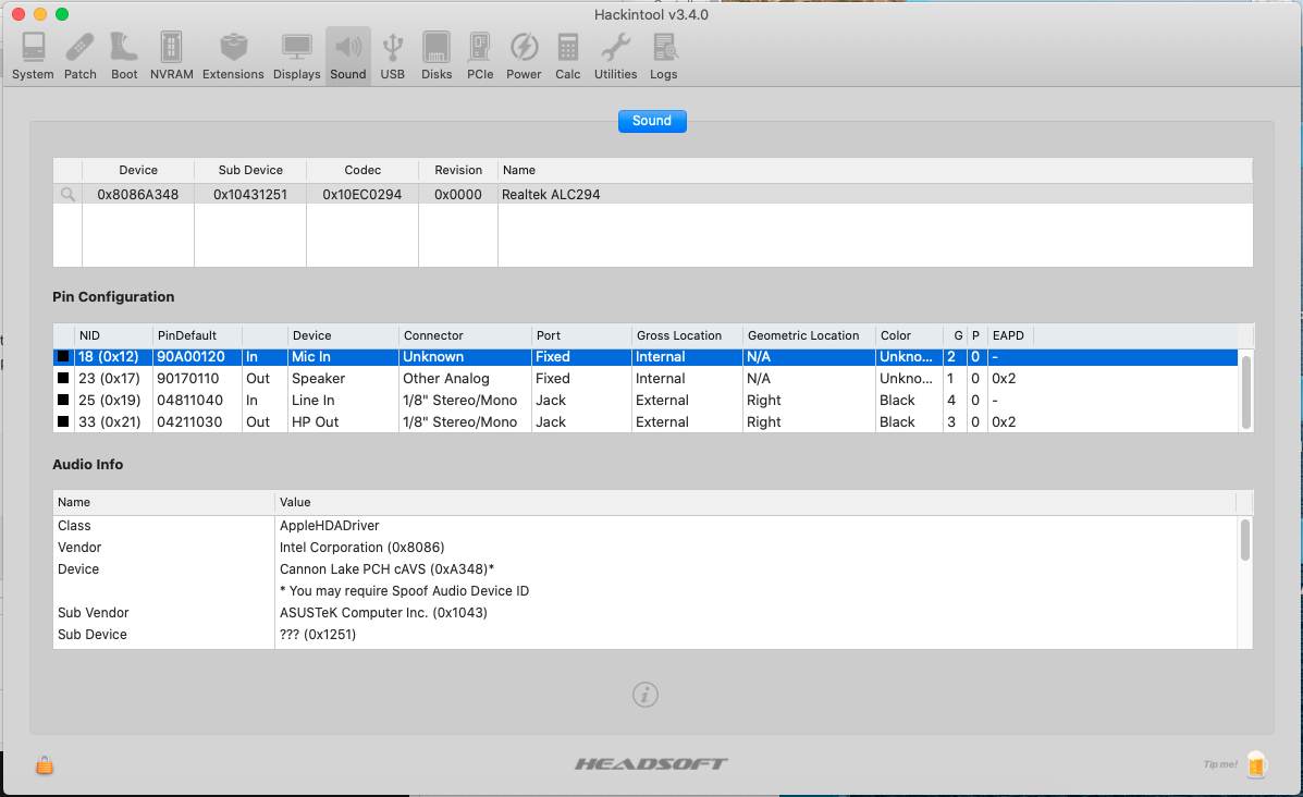

Sh1m3oN Posted July 6, 2020 Share Posted July 6, 2020 Helllo, thanks in advance to anyone who would like to help me not to become more crazy than I'm Problem: No output sound from speaker and headphones Laptop -- Asus ROG Strix II GL504GW: i7-8750H UHD630 32GB 2667 RAM (2x16) Realtek ALC294 All layout-ids tried without success Bootloader and OS info: OpenCore 0.5.9 macOS Catalina Version 10.15.5 (Build 19F101) A user called cowpod released a codec for the same laptop (layout-id: 22) but I haven't success to use it. I can turn the volume up and down, when I insert the headphones they are recognized and even the microphone works. The problem is that I can't hear any sound in any way. What I can do? I attach the files to my laptop! Thanks codec_dump.txt Info.plist Link to comment Share on other sites More sharing options...
robi62 Posted July 6, 2020 Share Posted July 6, 2020 On 5/28/2020 at 3:46 PM, MacPeet said: @seri Your computer has other nodes for HP (node 22). ID 3, ID15, ... (node 29 for HP) try this with layoutID 3: trial_cx8200_layoutID3.zip @MacPeet I just tried your alc and now I have headphone but speaker sound not working Pluging headphone in works automatic switch to headphones but I lost speakers output although its showingudio This is my DSDT for audio device Method (_SB.PCI0.HDEF._DSM, 4, NotSerialized) // _DSM: Device-Specific Method { If (LNot (Arg2)) { Return (Buffer (One) { 0x03 }) } Return (Package (0x08) { "layout-id", Buffer (0x04) { 0x03, 0x00, 0x00, 0x00 }, "hda-gfx", Buffer (0x0A) { "onboard-1" }, "PinConfigurations", Buffer (Zero){}, "RM,disable_FakePCIID", One }) } Name (_SB.PCI0.HDEF.RMCF, Package (0x02) { "CodecCommander", Package (0x04) { "Version", 0x00020600, "14f1_2008", Package (0x02) { "Custom Commands", Package (0x02) { Package (0x00){}, Package (0x08) { "Command", Buffer (0x04) { 0x01, 0x97, 0x07, 0x24 }, "On Init", ">y", "On Sleep", ">n", "On Wake", ">y" } } } } }) Link to comment Share on other sites More sharing options...

robi62 Posted July 7, 2020 Share Posted July 7, 2020 Eureka got my headphone working on my hp 440 g4 I just edited my hdef audio from layout 3 to 15 on my DSDT and now with stock lilu and alc everything works So happy Method (_SB.PCI0.HDEF._DSM, 4, NotSerialized) // _DSM: Device-Specific Method { If (LNot (Arg2)) { Return (Buffer (One) { 0x03 }) } Return (Package (0x08) { "layout-id", Buffer (0x04) { 0x15, 0x00, 0x00, 0x00 }, Link to comment Share on other sites More sharing options...
deryrochiman Posted July 7, 2020 Share Posted July 7, 2020 On 6/29/2020 at 12:45 PM, deryrochiman said: Hello guys, ive been trying in hackintosh 1 week later. the problem had to resolve now only about audio. I use AppleALC Audio described as guide with ALC290 codec on my dell vostro 5480, been trying all supported layout id 3,4,28 for that device but problem still same. internal speaker volume is low, compare to windows i think about 20%. It also happen to low volume input mic too. i think is only affect on internal speaker, cause when i use headphone, volume and clarity is good enough. AppleALC.kext + lilu install to /L/E folder, with essential kext in clover/kext/other. can anybody helps me with that ? i hope my laptop subwoofer would work to.. sorry for my bad grammar in english . i attach codec_dump from linux ubuntu and some debug file codec_dump_2.txt debug_23539.zip debug_23539.zip Anybody can help ? Link to comment Share on other sites More sharing options...

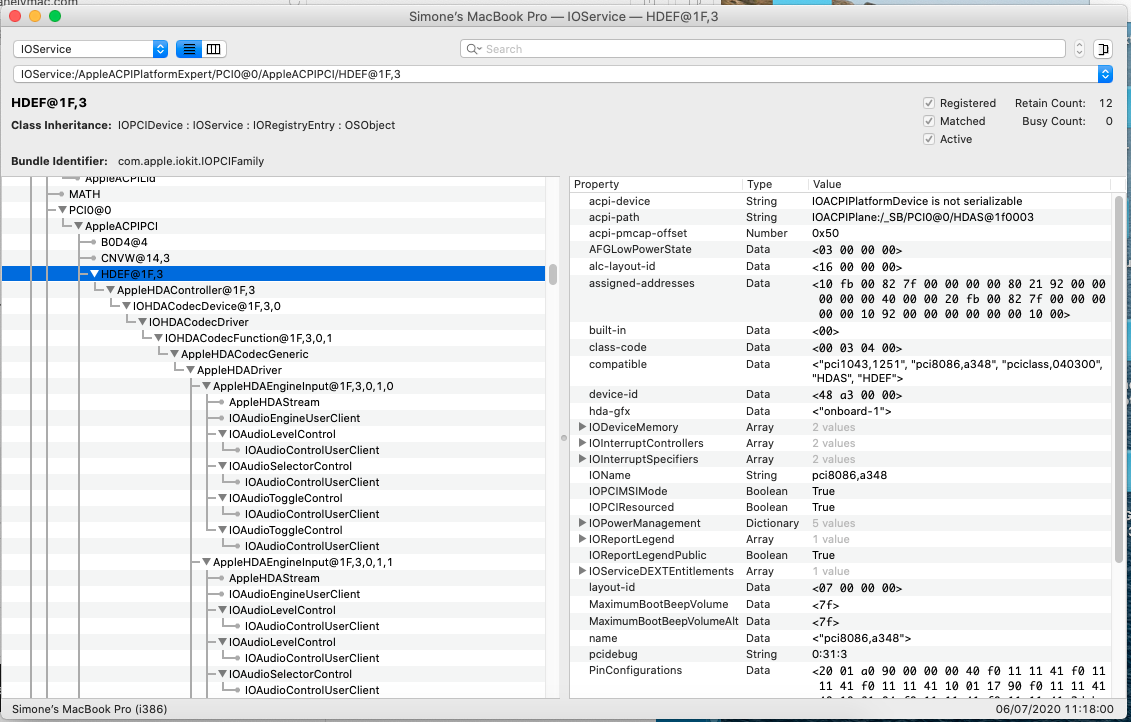

serpinu Posted July 30, 2020 Share Posted July 30, 2020 (edited) hi, let me write here because I would like to report a compatibility problem between my realtek alc294 sound card and appleALC.kext.I tried everything possible with the help of other more competent guys on appleALC configuration, using the various compatible layouts: 11,12,13,21,22,28,66, using them both with bootargs, and setting it through the section clover devices.With all the layouts I am recognized the speaker and the microphone, (unlike the port for the jack that does not appear), but nobody can hear anything coming from the speaker. I am attaching the debug created and my efi. Thank you! My laptop is: Asus Rog strix g512lv debug.mio.zip Edited July 30, 2020 by serpinu Link to comment Share on other sites More sharing options...
