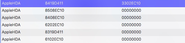

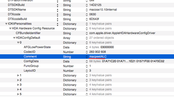

vandroiy2012 Posted May 23, 2016 Share Posted May 23, 2016 Hi everyone. Could anyone compile the AppleALC kext with the ALC3241 codec, a variation of the ALC290? I don't have the skills for that. The codec is found on the HP Envy 15K series and on my HP Presario 14-v065br, there is already an patched AppleHDA.kext (sorry, don't remember the credits) that works with them. I've included the patched AppleHDA kext file, along with the ALC3241 codec text for the AppleALC compilation. Regards, Hi. Ask author of this patched kext what binpatches he applied to AppleHDA. Link to comment https://www.insanelymac.com/forum/topic/311293-applealc-%E2%80%94-dynamic-applehda-patching/page/20/#findComment-2239868 Share on other sites More sharing options...
biscate Posted May 23, 2016 Share Posted May 23, 2016 Hi. Ask author of this patched kext what binpatches he applied to AppleHDA. Hi vandroiy2012, thank you for answering. I tried to find the patch author's using google and found suppose to be RehabMan / Mirone (ALC290). RehabMan answer follows: "The ALC290 files in this repo came from Mirone's collection. The binpatches are in the config.plist in the respective github repo." The github repo may be here. Sorry, I don't know if it can help. Link to comment https://www.insanelymac.com/forum/topic/311293-applealc-%E2%80%94-dynamic-applehda-patching/page/20/#findComment-2239886 Share on other sites More sharing options...
vandroiy2012 Posted May 23, 2016 Share Posted May 23, 2016 Sorry, I don't know if it can help. Probably the author of this kext is MacPeet. Ask him what binpatches he applied to your AppleHDA Link to comment https://www.insanelymac.com/forum/topic/311293-applealc-%E2%80%94-dynamic-applehda-patching/page/20/#findComment-2239887 Share on other sites More sharing options...
buyjoey Posted May 23, 2016 Share Posted May 23, 2016 Are you using CodecCommander.kext in/S/L/E/ ? Yes, I am using easyKext for install that Codeccommander.kext And I checked Red dotted CodecCommander.kext in SLE Now the sound is gone often...more... I tried ResetHDA, but no effective still gone when after turn off and turn on the computer. Overtime the sound is gone I should boot on Windows and then reboot to Mac and the sound is back. Joe. Link to comment https://www.insanelymac.com/forum/topic/311293-applealc-%E2%80%94-dynamic-applehda-patching/page/20/#findComment-2239932 Share on other sites More sharing options...
biscate Posted May 23, 2016 Share Posted May 23, 2016 Probably the author of this kext is MacPeet. Ask him what binpatches he applied to your AppleHDA Снимок экрана 2016-05-23 в 18.16.53.png Ok, got some information from MacPeet, as follows: "mmh, is not mine. It probably parts were used by me. Is ALC3241 = ALC290? The HDA is patched for 290. binpatches then: Find 8B19D411 Replace 9002EC10 Find 8319D411 Replace 00000000 Find 8508EC10 Replace 00000000" (credits: MacPeet) Trying to keep it clear, I've tested some versions of the ALC290 patch from toleda, insanelydeepak and others, but only the speakers/headphone out worked, with no microfone input at all. That happens with a lot of people. The first time I dumped the ALC3241 codec, RehabMan suggested it could be an ALC290, as its vendor_id is something "0290". Actually, I downloaded it before as a working version for the HP Envy K Series, for testing, from a RehabMan repo, I guess. Thank you all Link to comment https://www.insanelymac.com/forum/topic/311293-applealc-%E2%80%94-dynamic-applehda-patching/page/20/#findComment-2239940 Share on other sites More sharing options...
