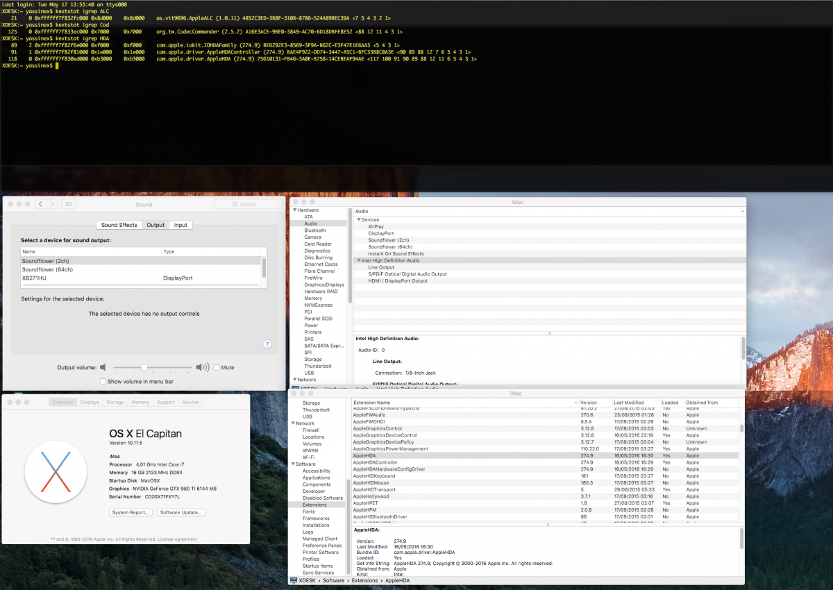

Thank you vadroiy, I've tested these 2 kext ( with no HDA patch in Clover, untouched AppleHDA, No extra Kext in Clover modifying the pins ) :
Layout 9 and 11 are showing devices. Same result :
Main Out - OK
Headphone (rear ) - OK
Rear Out - OK
C/Sub - Ko
Front Headphone - Ko
Volume Control - Ko
Layout 12 not showing any device.

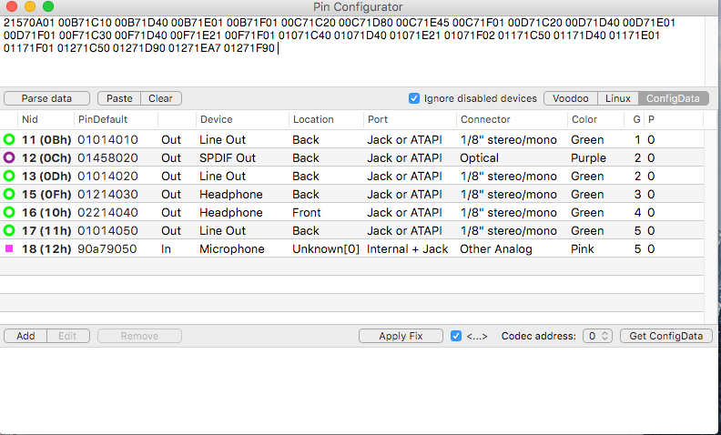

I saw that u used ConfigData that matches the card specs as you can see in Pin Configurator.

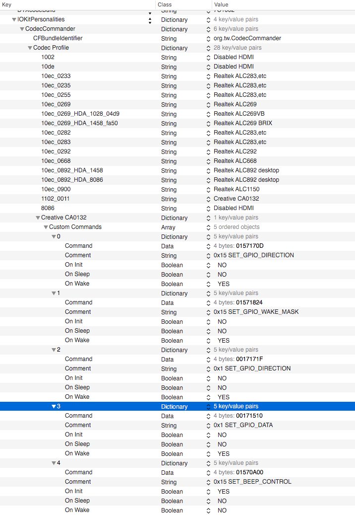

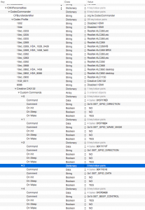

I think the problems are not just ConfigData, I suspect Codec.Commander.kext that I found inside the AppleHDA.kext patched by  wern apfel (thanx Mikey). You can fing inside this kext a file named SSDT-ALC668.dsl (ACPI ? )  + in the info.plist I can see some commands impacting Pins.... look at the second screenshot
BTW : I was trying to grap my  Pins from Windows (  with PinConfigOverride Tools ). This is what I got from my audio interface :
HDA Verb Converter
<00B71CF0 00B71D40 00B71E01 00B71F01 00C71CF0 00C71D20 00C71E45 00C71F01 00D71CF0 00D71D70 00D71E45 00D71F41 00E71CF0 00E71D10 00E71EC5 00E71F41 00F71CF0 00F71D70 00F71E21 00F71F41 01071CF0 01071D40 01071E21 01071F02 01171CF0 01171D10 01171E81 01171F01 01271CF0 01271D90 01271EA1 01271F01 01371CF0 01371D00 01371ED0 01371F50 01871CF0 01871D00 01871E00 01871F50>
CodecCommander.kext.zip
OK. I don't know what is it inside CC.kext... And why .dsl file placed in resouces folder... Author of resources i used in layout-id 9 have the SAME board as you. GA-Z170x Gaming 7 and he said that everything works great with this resources.
If there is no progress for you with this resources i suggest you to make a clean install of 10.11.4 and try it again. Also try to apply CodecCommander.kext you attached. Put it in S/L/E folder (it didn't work from EFI/Clover/Kexts). For volume control you can use SoundFlower. Report your progress...
If it didn't work after this i'll delete CA0132 resources from project and from compatibility list at all... Half-working support for this codec is a bad idea...

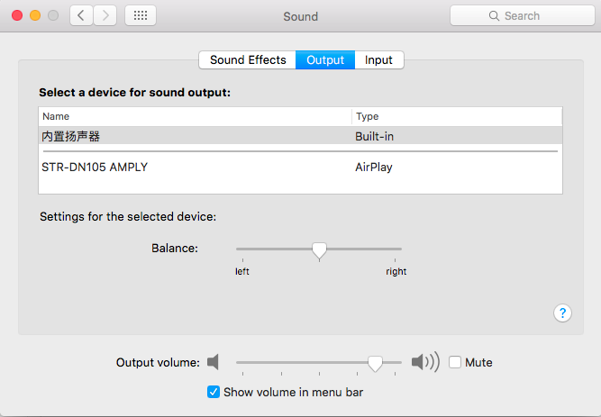

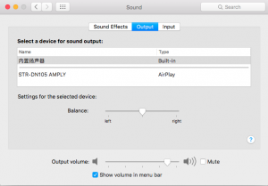

Still no love from your last kext ans you cazn see in the screenshot.
You said you are using a patch for Controller ? can you please post more information on this ? or at least the Clover Config.plist string ?
Thanks

Hi wern,
For both files only layout-id 1 = 2.0 + line-in is working ( Main out and HeadPhone ) Volume Control is Ok
For layout-id 0 = 5,1, no device found !
