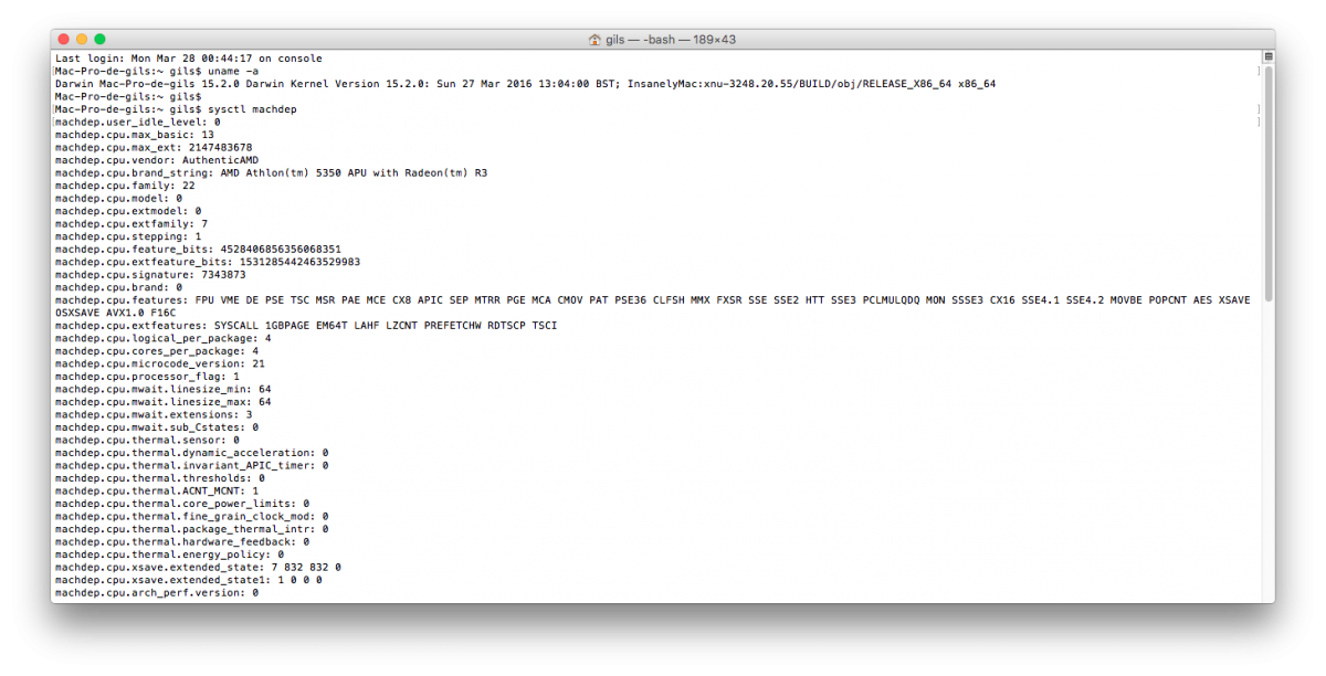

@gils83, your sysctl also doesn't have FMA in cpu.features, Same as Spakk's APU which also doesn't have graphical issues.

Intel FMA & AMD FMA are different.
https://en.wikipedia.org/wiki/FMA_instruction_set

Now the thing with the above quote is that both Spakks & your APU do have AVX but do not have FMA and your machdep.cpu.xsave.extended_state is 7 832 832 0
However I do think that AVX and FMA are related.

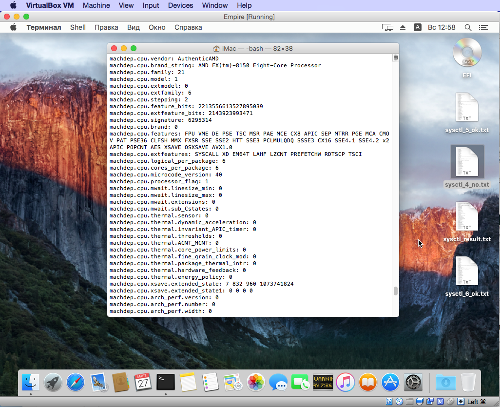

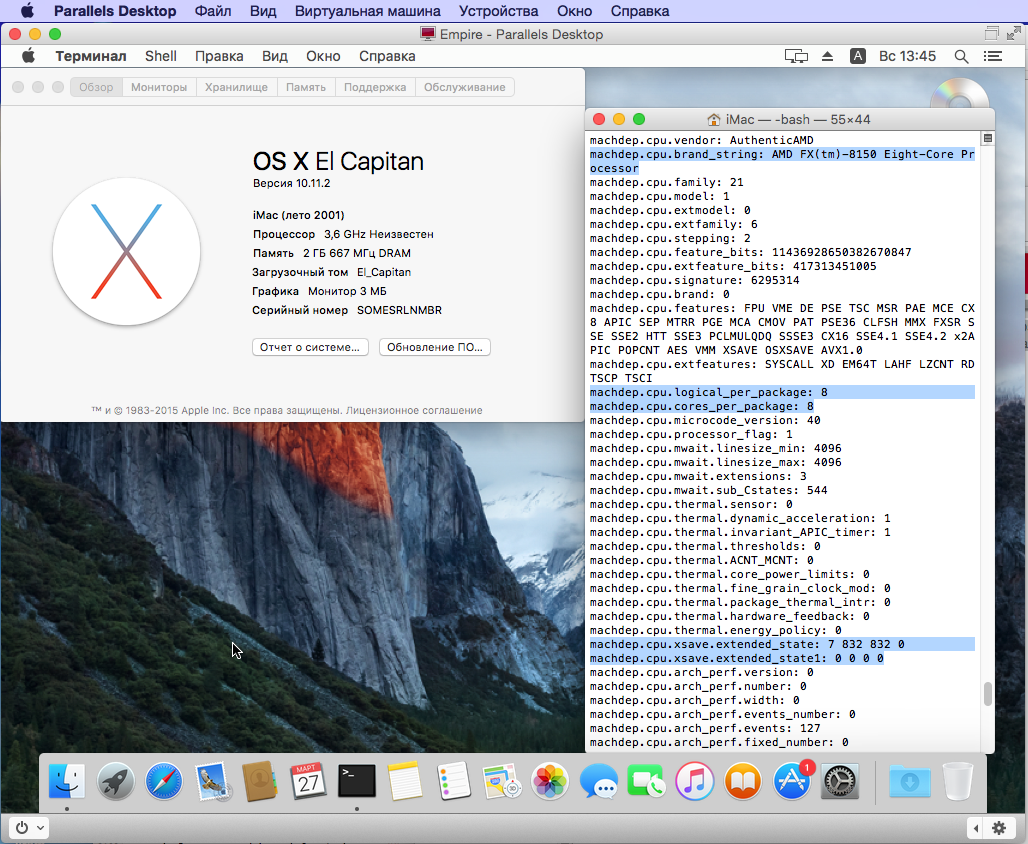

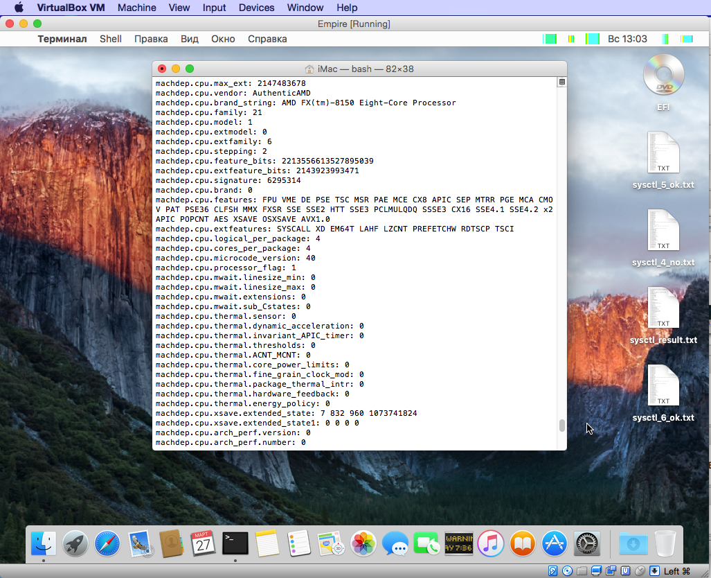

Hi !
I tested 10.11.2 on vmware , virtualbox and parallel desktop !
If in virtualbox use 6 cores , then i get normal icons without green icons ! But xsave have 832 and 960 !
If use 8 cores , then i get green icons !
In vmware same method !
In Parallel Desktop all with 1 - 8 cores -- no greens icons and xsave have 832 and 832 !
What problem and why green icons ? ))
See pictures and sysctl !
sysctl_4_no.txt
sysctl_5_ok.txt
sysctl_pdesktop_8_cores.txt
  • Like 7
Hi !
Nice find Bronya, really interesting! Maybe the way Virtualbox & Parrallel passthrough xsave is different? Or is xsave emulated in Parrallel?
In parallel desktop emulated xsave !
