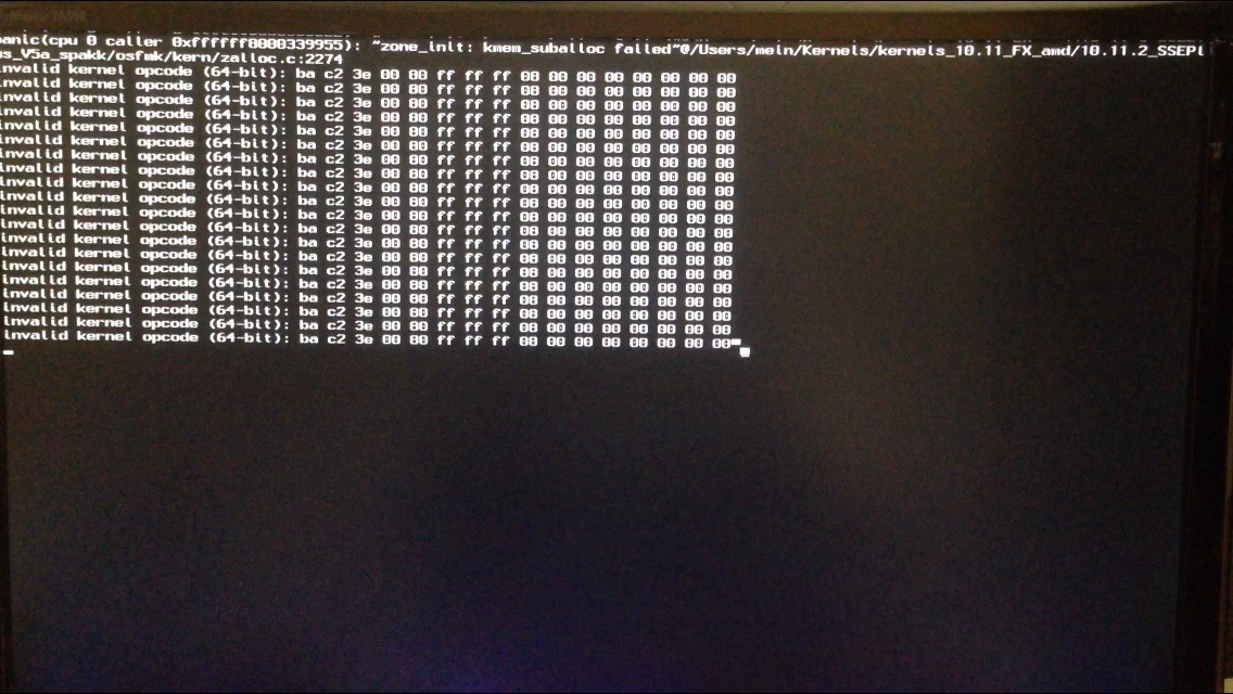

Armageddon_BR Posted February 24, 2016 Share Posted February 24, 2016 Testing 10.11.2_SSEPlus_V5a on clean install, just having this error and reboot Link to comment https://www.insanelymac.com/forum/topic/310796-amd-os-x-el-capitan-1011-fx-kernel-task-force/page/13/#findComment-2218082 Share on other sites More sharing options...

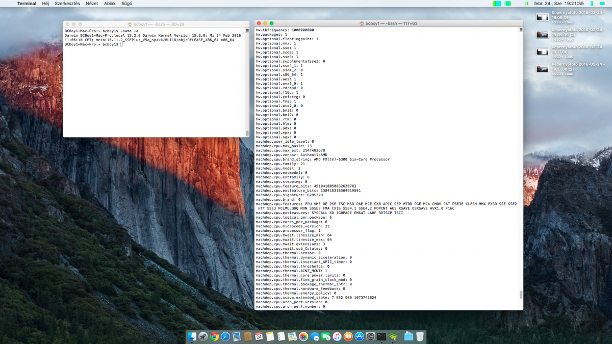

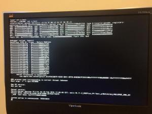

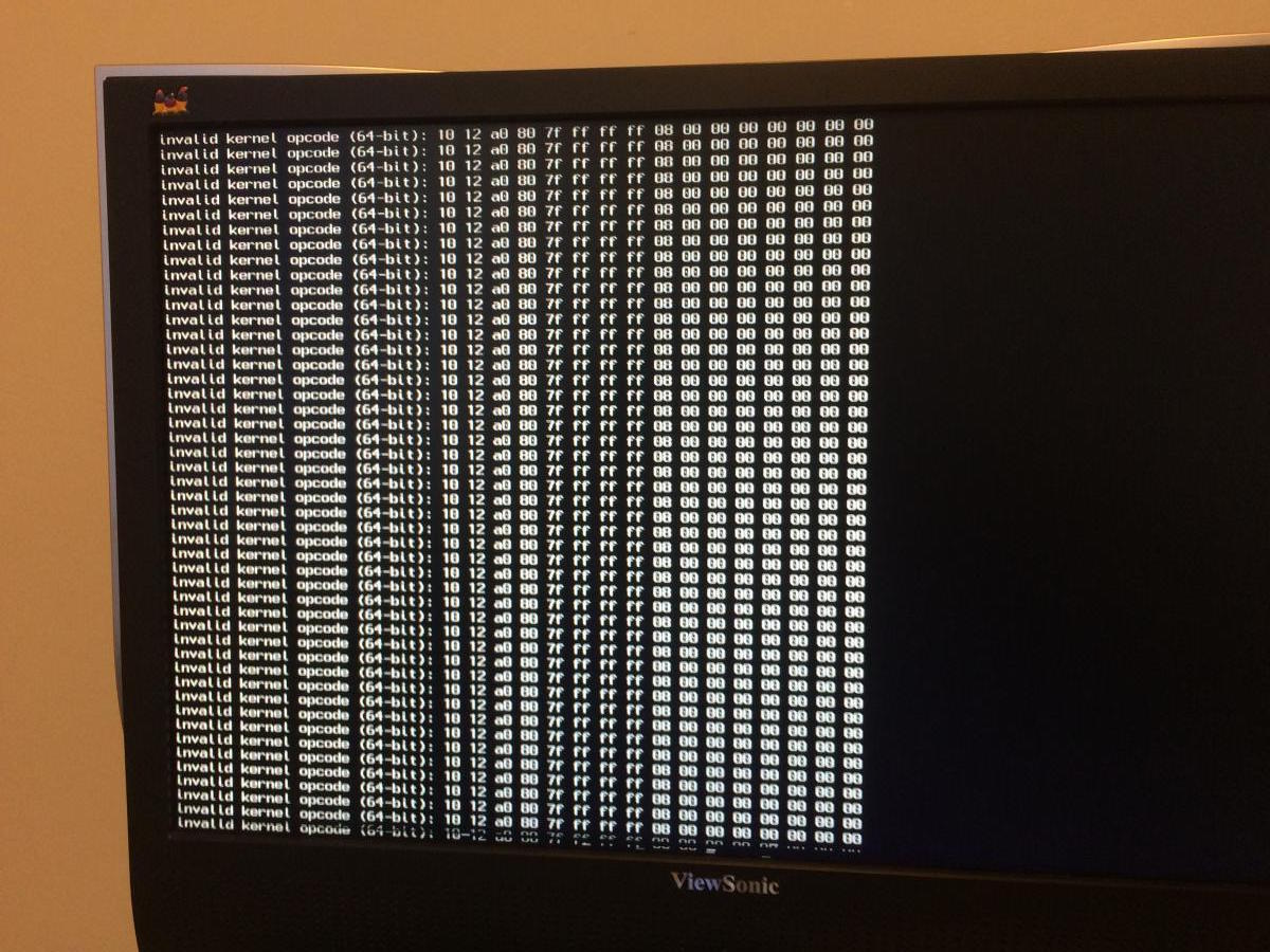

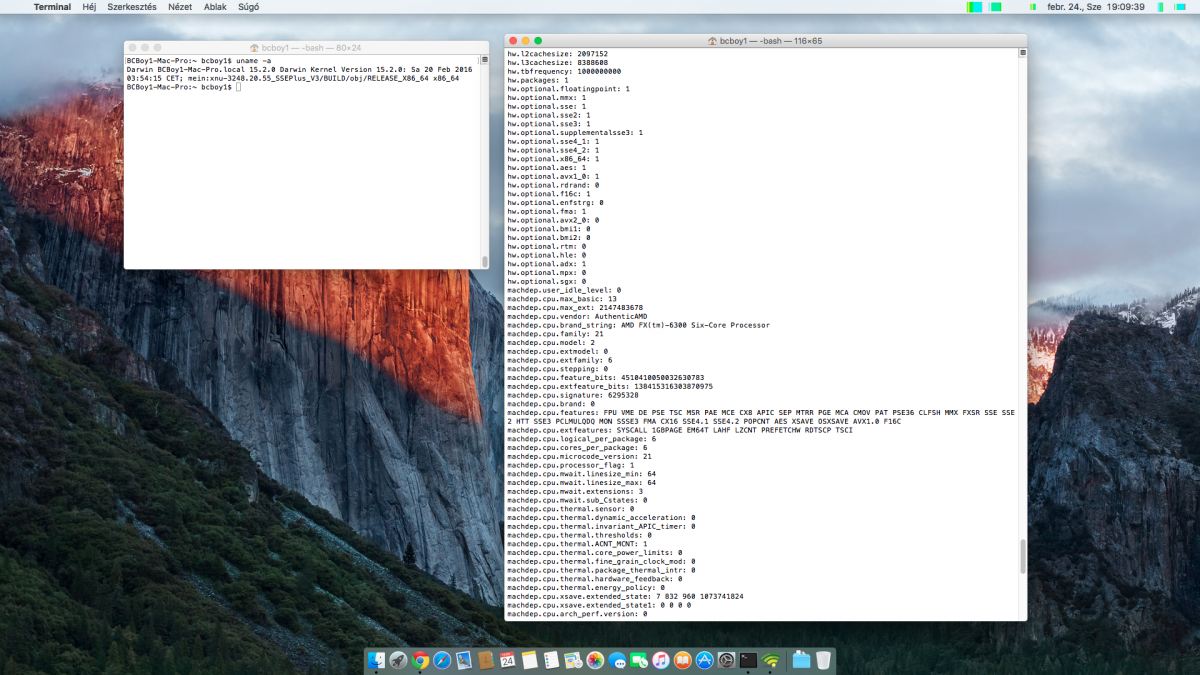

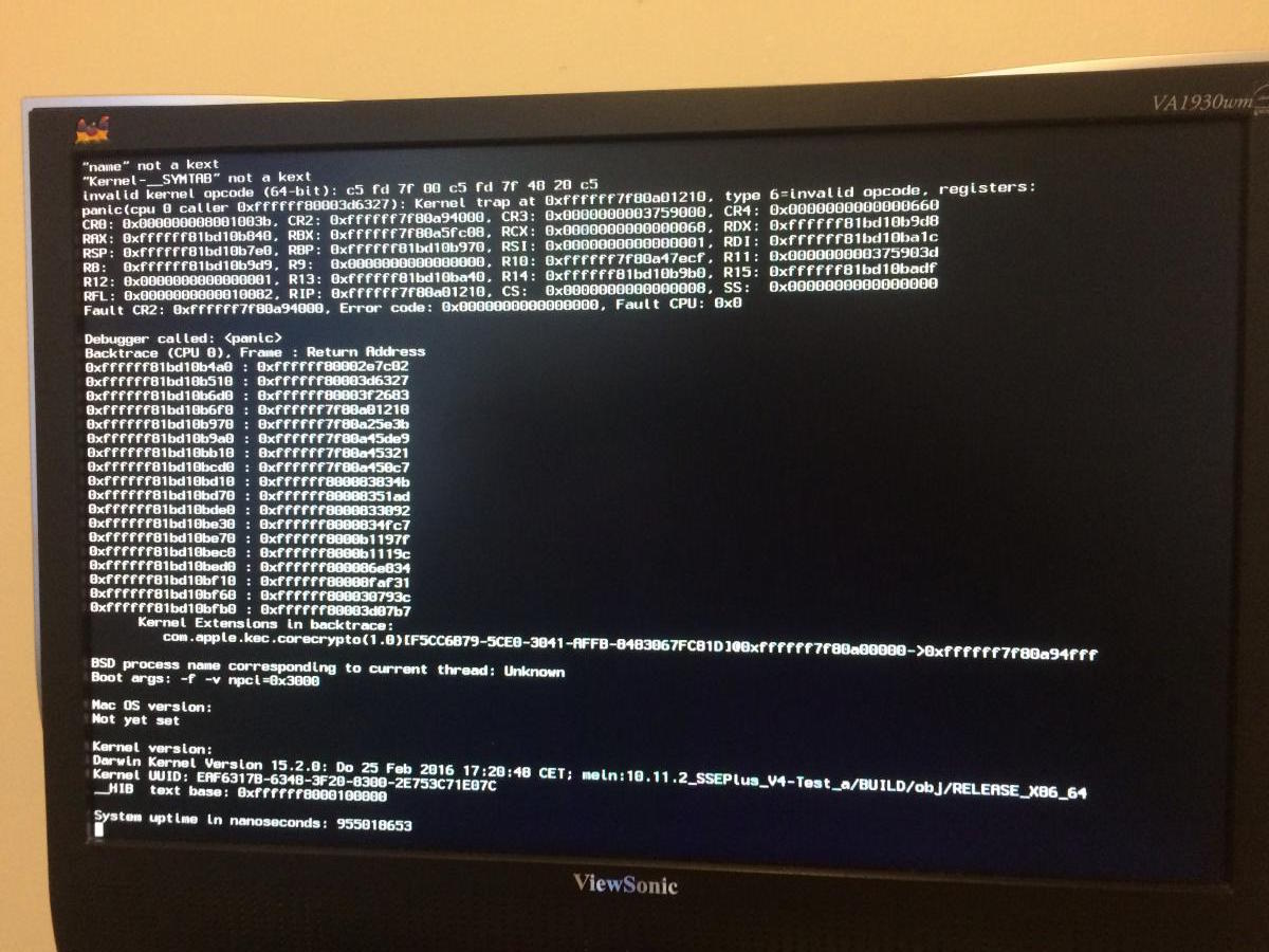

spakk Posted February 25, 2016 Author Share Posted February 25, 2016 please test and post : sysctl machdep.cpu.xsave.extended_state machdep.cpu.xsave.extended_state1 Edit: please test only on a second partition. 10.11.2-AMD_6_xsave.zip 10.11.2_SSEPlus_V4-Test_a.zip 10.11.2_SSEPlus_V5a.zip 1 Link to comment https://www.insanelymac.com/forum/topic/310796-amd-os-x-el-capitan-1011-fx-kernel-task-force/page/13/#findComment-2218317 Share on other sites More sharing options...
itisme754 Posted February 25, 2016 Share Posted February 25, 2016 please test and post : sysctl machdep.cpu.xsave.extended_state machdep.cpu.xsave.extended_state1 V4 and v5 got this: V6, this: Link to comment https://www.insanelymac.com/forum/topic/310796-amd-os-x-el-capitan-1011-fx-kernel-task-force/page/13/#findComment-2218326 Share on other sites More sharing options...
spakk Posted February 25, 2016 Author Share Posted February 25, 2016 (edited) V4 and v5 got this: post-1593919-0-04984700-1456424302.jpeg V6, this: post-1593919-0-76300900-1456424266.jpeg hmmm, AMD_6_xsave boots on my system, the others too.. kern.osrevision: 199506 kern.version: Darwin Kernel Version 15.2.0: Do 25 Feb 2016 18:25:10 CET; mein:10.11.2-AMD_6_xsave/BUILD/obj/RELEASE_X86_64 kern.maxvnodes: 132057 kern.maxproc: 1064 kern.maxfiles: 12288 kern.argmax: 262144 kern.securelevel: 0 kern.hostname: spakks-mac-pro kern.hostid: 0 now i'll test the kernel on my APU system and report. Edit: I can also confirm, opcode error on my APU system with AMD_6_xsave I will revise the value and build a new Edited February 25, 2016 by spakk Link to comment https://www.insanelymac.com/forum/topic/310796-amd-os-x-el-capitan-1011-fx-kernel-task-force/page/13/#findComment-2218337 Share on other sites More sharing options...
