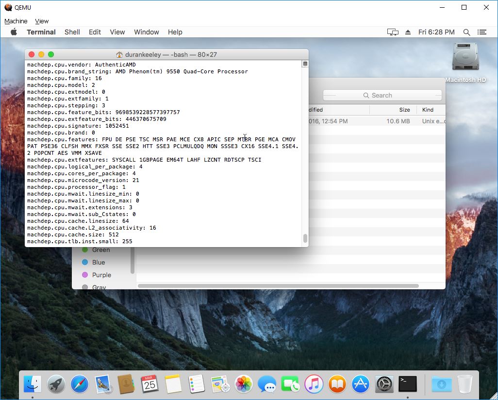

There are 2 AMD made instructions in the Mac sysctl that show up on the AMD FX users outputs
FMA & PREFETCHW
Now FMA only recently started getting implemented in Intel chipsets in 2014 but besides the point I looked at Spakk's APU screenshot and it was missing.
On my Macbook I have FMA (Intel FMA is different to AMD's) but I don't have PREFETCHW.
I have been sitting for the past day emulating the AMD FX processor in QEMU as best as I could on my desktop.
Using a Phenom profile, yes I know that the Phenom's don't have the problem to start with with a few more instructions it would pretty much be a FX processor.
MISSING INSTRUCTIONS
VME OSXSAVE AUX1.0 F16C PREFETCHW FMA
