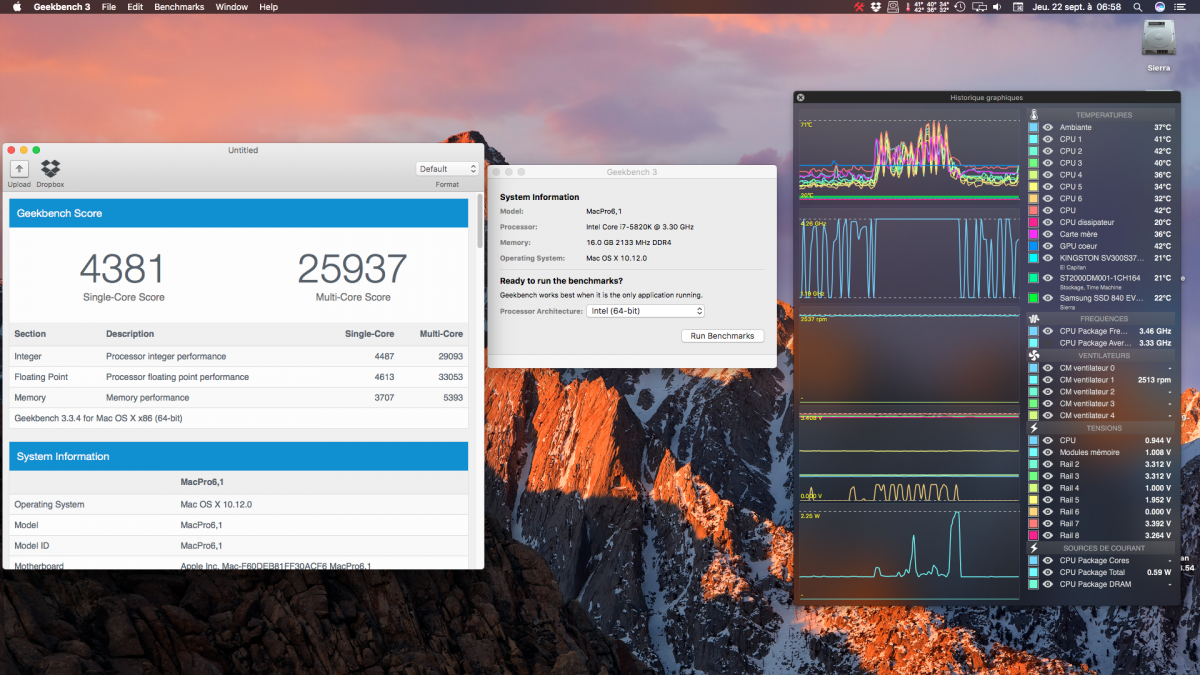

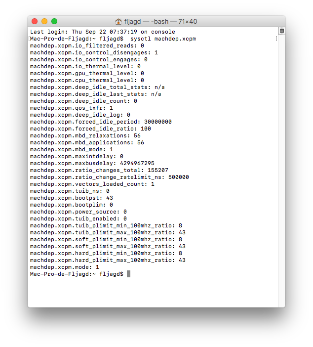

Fljagd Posted September 22, 2016 Share Posted September 22, 2016 Hi all, Just to say that everything rolls on my X99 with Sierra Methode en Français 3 Link to comment https://www.insanelymac.com/forum/topic/309717-haswell-e-5820k-5930k-installation-guide-with-full-speedstep-working/page/13/#findComment-2281950 Share on other sites More sharing options...

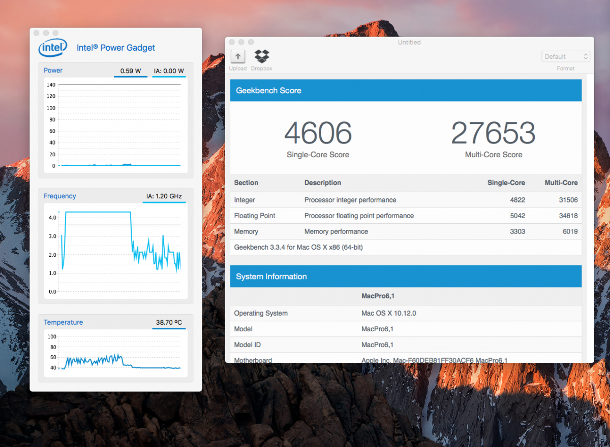

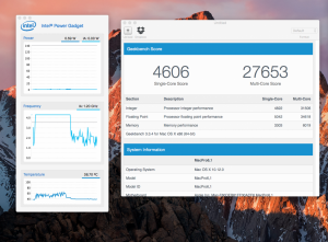

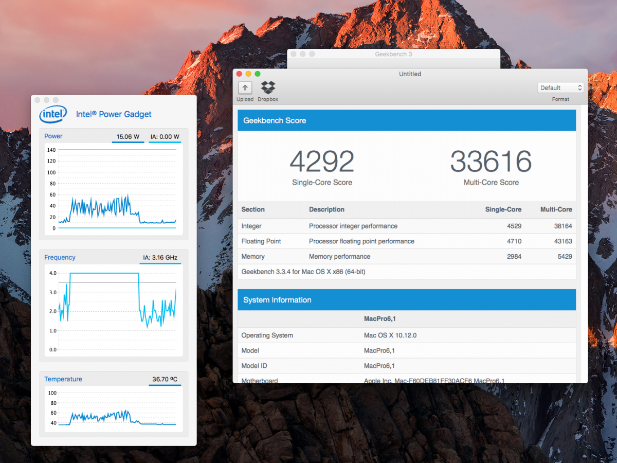

maleorderbride Posted September 22, 2016 Share Posted September 22, 2016 Yes, mine is also fine with Sierra. This is an i7-6850K @ 4.3GHz. The second picture is an i7-6900K @ 4.0GHz. 4 Link to comment https://www.insanelymac.com/forum/topic/309717-haswell-e-5820k-5930k-installation-guide-with-full-speedstep-working/page/13/#findComment-2281969 Share on other sites More sharing options...

Fljagd Posted September 22, 2016 Share Posted September 22, 2016 Yes, mine is also fine with Sierra. This is an i7-6850K @ 4.3GHz. 5820K =>25937, 6850K =>27653 : 6850K => +6,60% 5820K => 409€ , 6850K => 690€ : 6850K => +68,7% a gain of 6.6% in performance for a higher price of 68.7%. it's expensive 6.6% Link to comment https://www.insanelymac.com/forum/topic/309717-haswell-e-5820k-5930k-installation-guide-with-full-speedstep-working/page/13/#findComment-2281989 Share on other sites More sharing options...
maleorderbride Posted September 22, 2016 Share Posted September 22, 2016 5820K =>25937, 6850K =>27653 : 6850K => +6,60% 5820K => 409€ , 6850K => 690€ : 6850K => +68,7% a gain of 6.6% in performance for a higher price of 68.7%. it's expensive 6.6% It is ;p But I also need the PCI-e lanes. Thanks Intel ;( Link to comment https://www.insanelymac.com/forum/topic/309717-haswell-e-5820k-5930k-installation-guide-with-full-speedstep-working/page/13/#findComment-2282466 Share on other sites More sharing options...
Fljagd Posted September 22, 2016 Share Posted September 22, 2016 It is ;p But I also need the PCI-e lanes. Thanks Intel ;( 5820K => 28 lanes, is more than enough, even for 2 CG Link to comment https://www.insanelymac.com/forum/topic/309717-haswell-e-5820k-5930k-installation-guide-with-full-speedstep-working/page/13/#findComment-2282475 Share on other sites More sharing options...
