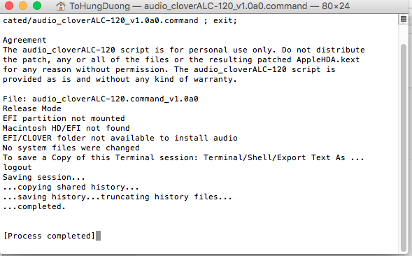

DuongTHVN Posted August 28, 2016 Share Posted August 28, 2016 some worng. on my system ALC892 EL catpitan 10.11.6 UEFI clover Link to comment https://www.insanelymac.com/forum/topic/308387-el-capitan-realtek-alc-applehda-audio/page/14/#findComment-2270772 Share on other sites More sharing options...
gengik84 Posted August 28, 2016 Share Posted August 28, 2016 some worng. on my system ALC892 EL catpitan 10.11.6 UEFI clover EFI partition not mounted.... Link to comment https://www.insanelymac.com/forum/topic/308387-el-capitan-realtek-alc-applehda-audio/page/14/#findComment-2270797 Share on other sites More sharing options...

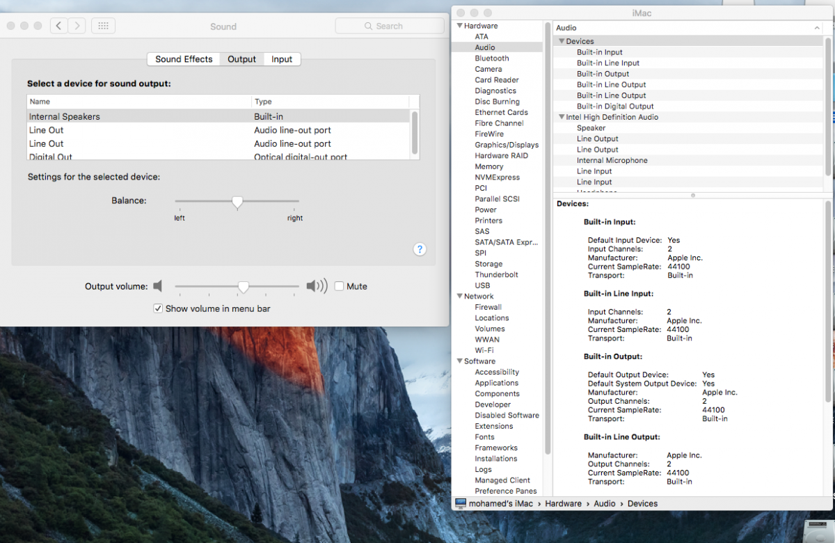

llamafilm Posted August 31, 2016 Share Posted August 31, 2016 The installation script is stalling when I run it — both versions 110 and 120. I was using VoodooHDA, but the sound quality wasn't great, so I'm trying to switch to this method. I fully removed VoodooHDA and HDAEnabler. I coped the vanilla AppleHDA.kext from another machine. I'm using Clover to rename ALZA to HDEF, and SSDT to inject layout-id 1. When I run the script, it stalls like this for several minutes and never finishes. File: audio_cloverALC-120.command_v1.0b0 Release Mode EFI partition is mounted Boot/Arguments = kext-dev-mode=1 found Confirm Realtek ALC1150 (y/n): y Clover Audio ID Injection (y/n): y Use Audio ID: 1 (y/n): y Download ALC1150 files ... % Total % Received % Xferd Average Speed Time Time Time Current Dload Upload Total Spent Left Speed 100 23555 100 23555 0 0 29532 0 --:--:-- --:--:-- --:--:-- 29517 Edit config.plist/Devices/Audio/Inject/1 Edit config.plist/SystemParameters/InjectKexts/YES Download kext patches % Total % Received % Xferd Average Speed Time Time Time Current Dload Upload Total Spent Left Speed 100 1418 100 1418 0 0 5328 0 --:--:-- --:--:-- --:--:-- 5330 Link to comment https://www.insanelymac.com/forum/topic/308387-el-capitan-realtek-alc-applehda-audio/page/14/#findComment-2272209 Share on other sites More sharing options...

llamafilm Posted September 1, 2016 Share Posted September 1, 2016 Here are the files you requested. The script stalls while downloading kext patches. I can see the devices in System Information, but they don't appear in System Preferences. toleda troubleshooting 1.zip Link to comment https://www.insanelymac.com/forum/topic/308387-el-capitan-realtek-alc-applehda-audio/page/14/#findComment-2272318 Share on other sites More sharing options...
toleda Posted September 2, 2016 Author Share Posted September 2, 2016 The script stalls while downloading kext patches. Attach IOReg SSDT-HDEF-1 is not correct, remove See Post #1, Unsupported/Non-working Realtek ALC AppleHDA.kext 2. X99/Intel High Definition Audio Use either config.plist edit or ssdt. Link to comment https://www.insanelymac.com/forum/topic/308387-el-capitan-realtek-alc-applehda-audio/page/14/#findComment-2272701 Share on other sites More sharing options...

llamafilm Posted September 3, 2016 Share Posted September 3, 2016 The SSDT that you told me to remove was injecting the layout-id 1. Now I've deleted it, and I have config.plist injecting number 1, but it isn't working. System Info shows ID 0. Now the script won't run of course, because it says no codec detected. I'm using the x99 patch for AppleHDAController, and the ALZA > HDEF patch. toleda troubleshooting 2.zip Link to comment https://www.insanelymac.com/forum/topic/308387-el-capitan-realtek-alc-applehda-audio/page/14/#findComment-2273112 Share on other sites More sharing options...
toleda Posted September 5, 2016 Author Share Posted September 5, 2016 i use UNOFFICIAL_audio_realtekALC-100_v1.0.5.command Not supported, see Post #1. I'm using the x99 patch for AppleHDAController, and the ALZA > HDEF patch. Remove ALZA > HDEF patch, install ssdt_hdef-1-x99-alza.zip. Restart, run script. Link to comment https://www.insanelymac.com/forum/topic/308387-el-capitan-realtek-alc-applehda-audio/page/14/#findComment-2274040 Share on other sites More sharing options...
llamafilm Posted September 7, 2016 Share Posted September 7, 2016 Remove ALZA > HDEF patch, install ssdt_hdef-1-x99-alza.zip. Restart, run script. Done. But now it's worse — I don't get any codec detected at all. File: audio_codecdetect.command_v1.7a No audio codec detected Verify BIOS, hardware, etc. toleda troubleshooting 4.zip Link to comment https://www.insanelymac.com/forum/topic/308387-el-capitan-realtek-alc-applehda-audio/page/14/#findComment-2274640 Share on other sites More sharing options...

toleda Posted September 8, 2016 Author Share Posted September 8, 2016 It's disabled in config.plist My mistake. Run cloverALC, restart Attach installed S/L/E/AppleHDA.kext Attach new files Link to comment https://www.insanelymac.com/forum/topic/308387-el-capitan-realtek-alc-applehda-audio/page/14/#findComment-2275084 Share on other sites More sharing options...

llamafilm Posted September 9, 2016 Share Posted September 9, 2016 As I said, it does not detect any audio codec, and therefore, the cloverALC script does nothing. So all the attachments I sent in the last post are still relevant. Here is the kext. I believe the problem is related to the SSDT. I'm using the one you suggested, SSDT-HDEF-ALZA-1, which is attached in my last post. And it's working to some extent — ioreg shows the device renamed from ALZA to HDEF. But the layout-id is not being applied. Hackintosh:~ elliott$ ioreg -rn HDEF +-o HDEF@1B <class IOPCIDevice, id 0x100000487, registered, matched, active, b$ { "assigned-addresses" = <10d8008200000000000013cf0000000000400000> "IOInterruptSpecifiers" = (<1600000007000000>,<0400000000000100>) "class-code" = <00030400> "IODeviceMemory" = (({"address"=3474128896,"length"=16384})) "IOPowerManagement" = {"CapabilityFlags"=2,"CurrentPowerState"=2,"ChildPr$ "subsystem-vendor-id" = <58140000> "built-in" = <00> "pci-aspm-default" = 0 "acpi-device" = "IOACPIPlatformDevice is not serializable" "IOInterruptControllers" = ("io-apic-0","IOPCIMessagedInterruptController$ "name" = <"pci8086,8d20"> "vendor-id" = <86800000> "device-id" = <208d0000> "acpi-pmcap-offset" = 80 "IOPCIResourced" = Yes "layout-id" = <00000000> "compatible" = <"pci1458,a182","pci8086,8d20","pciclass,040300","HDEF"> "IOPCIExpressLinkCapabilities" = 0 "acpi-path" = "IOACPIPlane:/_SB/PCI0@0/HDEF@1b0000" "subsystem-id" = <82a10000> "revision-id" = <05000000> "IOPCIExpressLinkStatus" = 0 "IOPCIExpressCapabilities" = 145 "pcidebug" = "0:27:0" "IOName" = "pci8086,8d20" "IOPCIPMCSState" = 0 "reg" = <00d800000000000000000000000000000000000010d800020000000000000000$ } AppleHDA.kext.zip Link to comment https://www.insanelymac.com/forum/topic/308387-el-capitan-realtek-alc-applehda-audio/page/14/#findComment-2275807 Share on other sites More sharing options...
toleda Posted September 13, 2016 Author Share Posted September 13, 2016 it does not detect any audio codec, Attached AppleHDA.kext is 3.6 MB, should be 3.8 MB; do not know what is missing. Install native AppleHDA.kext Link to comment https://www.insanelymac.com/forum/topic/308387-el-capitan-realtek-alc-applehda-audio/page/14/#findComment-2277529 Share on other sites More sharing options...
llamafilm Posted September 13, 2016 Share Posted September 13, 2016 Last time I installed the native kext, I used this guide: https://github.com/toleda/audio_ALC_guides/blob/master/Restore%20native%20AppleHDA%20%5BGuide%5D.pdf Today I followed that guide again, exactly, and got the same 3.6MB file. Also, my MacBook Pro running yosemite also has that file as 3.6MB. I think maybe the difference between me and you is just 1024 vs 1000. Link to comment https://www.insanelymac.com/forum/topic/308387-el-capitan-realtek-alc-applehda-audio/page/14/#findComment-2277541 Share on other sites More sharing options...
llamafilm Posted September 16, 2016 Share Posted September 16, 2016 With your SSDT-HDEF-ALZA-1.aml, the layout-id is always zero, so I made some changes. Attached is my new SSDT-HDEF-ALZA-hack.aml, which does inject layout-id = 1, according to ioreg. After that, I restored everything back to normal (native AppleHDA, delete realtekALC, remove clover audio patches. I installed again using cloverALC 120 command. Now I see the audio devices in System Preferences, but when I hear no sound. When I try to play a song in iTunes, the playhead freezes at zero, and I see this in system.log: 9/15/16 10:18:40.000 PM kernel[0]: Sound assertion in AppleHDAController at line 6444 9/15/16 10:18:40.000 PM kernel[0]: Sound assertion in AppleHDAController at line 6130 9/15/16 10:18:40.000 PM kernel[0]: Sound assertion in AppleHDAEngine at line 10294 9/15/16 10:18:40.000 PM kernel[0]: Sound assertion in AppleHDAController at line 6576 9/15/16 10:18:40.000 PM kernel[0]: Sound assertion in AppleHDAEngine at line 1863 9/15/16 10:18:40.000 PM kernel[0]: Sound assertion in AppleHDAController at line 6649 9/15/16 10:18:40.000 PM kernel[0]: Sound assertion in IOHDAStream at line 384 By the way, my DSDT has been edited to rename H000 to GFX1, and the other SSDT is for power management. Question: If the SSDT is already injecting layout-id, when why does your script set the Clover option to inject audio ID? This seems redundant, and I'm not sure which one takes priority. toleda help 5.zip Link to comment https://www.insanelymac.com/forum/topic/308387-el-capitan-realtek-alc-applehda-audio/page/14/#findComment-2279020 Share on other sites More sharing options...
llamafilm Posted September 17, 2016 Share Posted September 17, 2016 Update: I realized I don't need the SSDT at all, if I use Clover options AddDTGP and FixHDA, and inject the layout-id there. Still can't play any audio. Link to comment https://www.insanelymac.com/forum/topic/308387-el-capitan-realtek-alc-applehda-audio/page/14/#findComment-2279493 Share on other sites More sharing options...
toleda Posted September 18, 2016 Author Share Posted September 18, 2016 Still can't play any audio. Speakers in green port, Internal Speakers selected, play something in iTunes. Attach new files Link to comment https://www.insanelymac.com/forum/topic/308387-el-capitan-realtek-alc-applehda-audio/page/14/#findComment-2279893 Share on other sites More sharing options...
