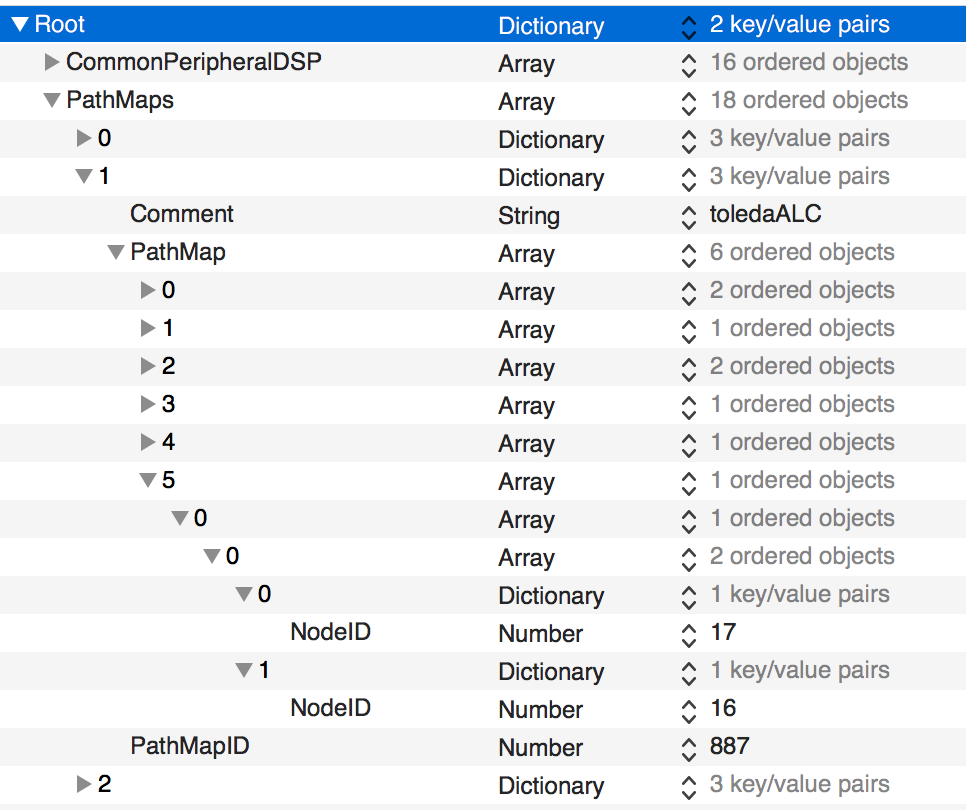

ovof Posted February 5, 2017 Share Posted February 5, 2017 Update: Rebuilt system and kexts caches on my startup disk with KCPM Utility Pro, restarted and now all is working, including the digital S/PDIF outputs! Hopefully it stays stable. Thanks Toleda! Note: I also tried to "Repair Permissions on Entire Disk" with this utility, but it never finished [3+ hours], so perhaps something changed in 10.11.1. Hello I try also to enable SPDIF output on added bracket to the mobo, so I need to edit platform.zml.zlib and realtekALC.kext/...Info.plist But unfortunalety it doesn't work, I dont know why, I did the same fix like Anachronaut did with the help of Toleda My mobo : GA Z77 DS3H > ALC 887, layout 3 - analog sound working well 1) I switch the 2 node id of last item in 886 path of platform.zlib 2) then I patched the info.plist of realetkALC.kext in clover/kext folder Here attached the 2 kexts, before then after the patch : - AppleHDA.kext - RealtekALC.kext Also the picture of the patch of Platform.zml Here are the ConfigData, codec 887 (283904135) layout 3 Before: 21471C10 21471D40 21471E11 21471F90 21571C20 21571D10 21571E01 21571F01 21671CF0 21671D00 21671E00 21671F40 21771CF0 21771D00 21771E00 21771F40 21871C40 21871D90 21871EA0 21871F90 21971C60 21971D90 21971E81 21971F02 21A71C50 21A71D30 21A71E81 21A71F01 21B71C70 21B71D40 21B71E21 21B71F02 21E71C90 21E71D61 21E71E4B 21E71F01 21F71CF0 21F71D00 21F71E00 21F71F40 21171CF0 21171D00 21171E00 21171F40 After: 21471C10 21471D40 21471E11 21471F90 21571C20 21571D10 21571E01 21571F01 21671CF0 21671D00 21671E00 21671F40 21771CF0 21771D00 21771E00 21771F40 21871C40 21871D90 21871EA0 21871F90 21971C60 21971D90 21971E81 21971F02 21A71C50 21A71D30 21A71E81 21A71F01 21B71C70 21B71D40 21B71E21 21B71F02 21E71CF0 21E71D00 21E71E00 21E71F40 21F71CF0 21F71D00 21F71E00 21F71F40 21171CA0 21171D01 21171E43 21171F99 But whatever I do, no sound anymore detected in pref panel after reboot. If I replace with the stock Info.Plist, sound back, but of course spdif patch doesn't work Coud you please help me ? Thanks !!! stock kext.zip patch kext.zip Info.plist.zip Link to comment https://www.insanelymac.com/forum/topic/308387-el-capitan-realtek-alc-applehda-audio/page/16/#findComment-2363441 Share on other sites More sharing options...
toleda Posted February 14, 2017 Author Share Posted February 14, 2017 GA Z77 DS3H > ALC 887, layout 3 - analog sound working well 1) I switch the 2 node id of last item in 886 path of platform.zlib Apologies for the delay in replying PathMapID = 387 for 887/Layout 3, not 887 (Layout 1) Restore Platforms and re-edit the correct PathMapID Link to comment https://www.insanelymac.com/forum/topic/308387-el-capitan-realtek-alc-applehda-audio/page/16/#findComment-2368296 Share on other sites More sharing options...
ovof Posted February 15, 2017 Share Posted February 15, 2017 Thanks again FIXED it was a conflict between clover injection and manuel injection in dsdt.aml Link to comment https://www.insanelymac.com/forum/topic/308387-el-capitan-realtek-alc-applehda-audio/page/16/#findComment-2368574 Share on other sites More sharing options...
