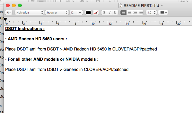

simply use the generic DSDT.aml to install OS X on a 755.
Depending on your graphic card, you could have to customize or download a specific DSDT from this thread. I use a GT610 with no modification, HD5450 needs patch, ...

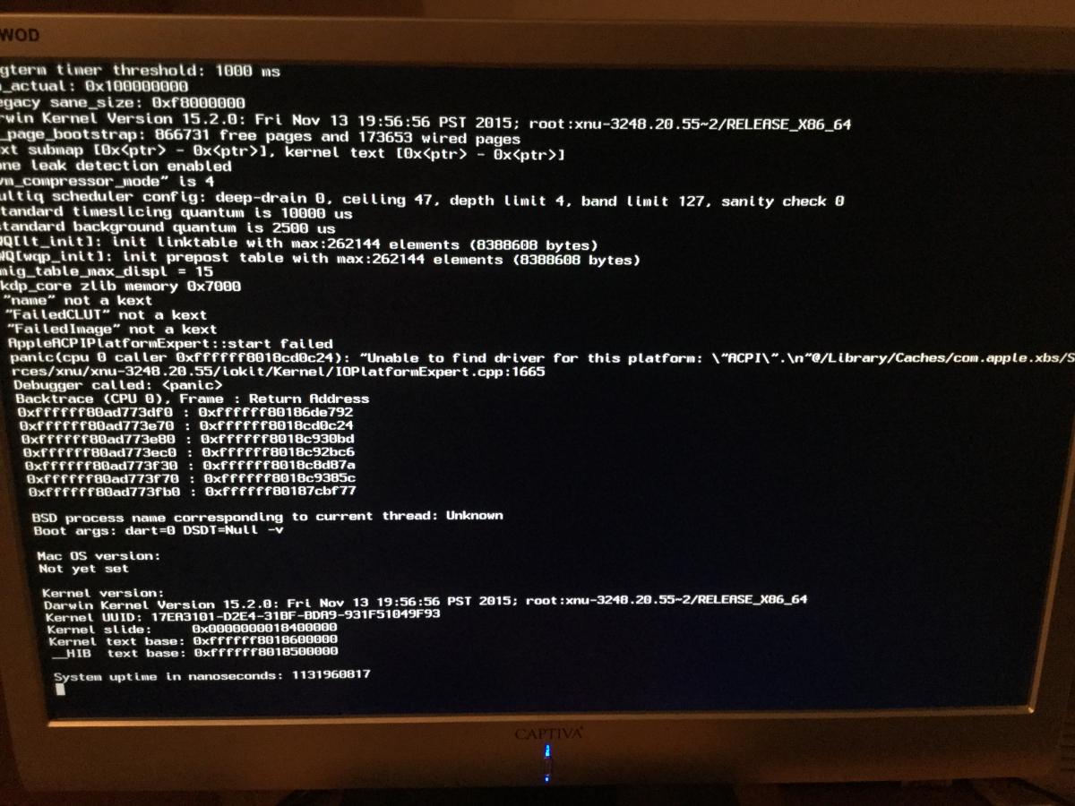

I built a Hackintosh on this machine years ago. So it should work somehow. My graphics card is the GeForce 9600GT. When I follow the tutorial on the first site completely or simply build it with [url="http://www.insanelymac.com/forum/topic/279450-why-insanelymac-does-not-support-tonymacx86/"]#####[/url] I get the following error which you can see in the attachment.
I'm in the installer now. Found someone, who said, that the DSDT file of him was broken. I copied the file for my nvidia card again and now I'm in the installer. Thanks again for your help. I really like this forum. Will definitely stay here :)

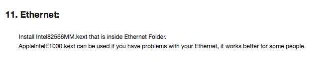

Be sure that your Ethernet is connected as en0, and try different (other) kext. AppleIntelE1000e doesn't work for me in 10.11, I'm using Intel82655MM now. You have them in Clover pack from the first post.

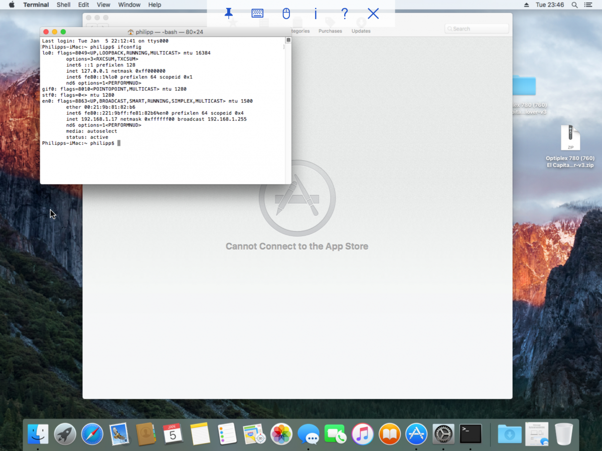

Thanks for the great guide. I used it for my optiplex 790 with geforce gt740.  I had to manually make my boot usb stick, since the app errored out on my Mountain Lion mac.
The rest of the install went great. I had to use the AppleIntelE1000e.kext, the other kext didn't work for me.

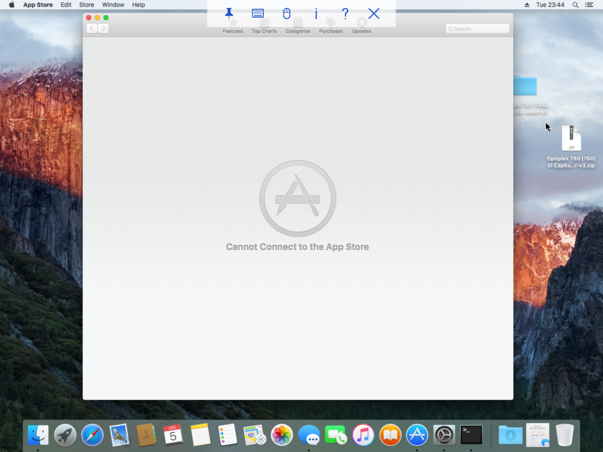

After that I had a problem connecting to appstore, etc basically anything icloud/apple id.
I've been searching for solutions and none of them worked or applied in my case, so I decided to use the install without for a while.
Then I noticed several sites timing out while browsing and network speed not being so great.
I found an newer version of AppleIntelE1000e.kext on sourgeforce, downloaded that and now my network speed
is much better , no more timeouts while browsing and also appstore and itunes and icloud work fine.
