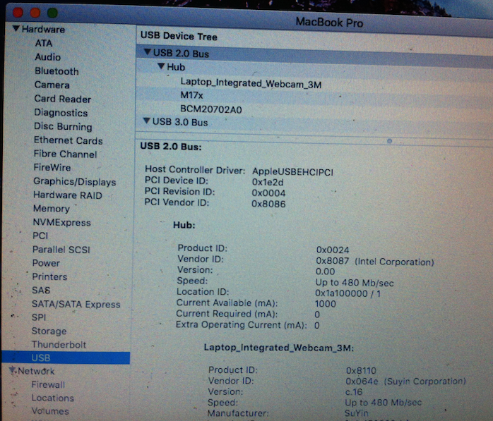

These are the internal devices linked to the EH01 EH02 bus.( Of course the dsdt EHC rename is done to avoid bulit-in injectors) And I use MacBookPro 9,1 for Smbios.
EH01---HUBN---PR01---PR17   // eSATA/USB2 2in1 combo slot.
EH02---HUBN---PR01---PR11   //BCM20702A Bluetooth
EH02---HUBN---PR01---PR12   //m17x Alienware FX control
EH02---HUBN---PR01---PR15   //Webcam

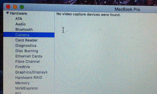

And there're 2 problems.
Problem 1: The eSATA/USB2 combo slot is invalid, even EH01 bus doesn't show up in "About this mac"---"System Report"---"USB".

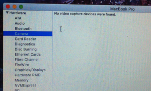

Problem 2: After system boot, although you can see the webcam in "About this mac"---"System Report"---"USB".
                But nothing is in  "About this mac"---"System Report"---"Camera". Of course no video feed in facatime, too.
But I found if I make the system sleep, it will wake up immediately.( since I didn't patch the dsdt for this ) And after the wake up from the failed sleep, the camera will be back. And video feed in facetime is OK.

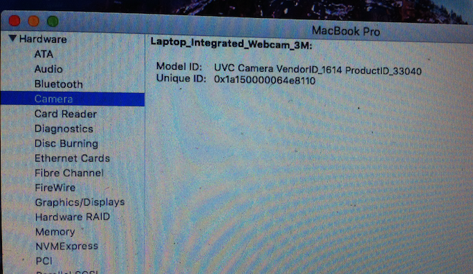

After thinking of that, I remembered something. So I tried this.
I edited Clover/config.plist, and changed the model in Smbios from MacbookPro 9,1 to MacPro 6,1.
Then after reboot, the webcam is working directly, no need to sleep and wake up.
I know my assumption might be right. So I found this :
/System/Library/Extensions/IOUSBHostFamily.kext/info.plist/IOKitPersonalities/MacBookPro 9,1/IOProviderMergeProperties
There're 4 items under it: kUSBSleepPortCurrentLimit ( 2100 ), kUSBSleepPowerSupply ( 2600 ), kUSBWakePortCurrentLimit ( 2100 ),kUSBWakePowerSupply ( 3200 )
And I checked these 4 items for MacPro 6,1. They turned out to be: kUSBSleepPortCurrentLimit ( 2100 ), kUSBSleepPowerSupply ( 4700 ), kUSBWakePortCurrentLimit ( 2100 ),kUSBWakePowerSupply ( 4700 )
So I changed the 4 item for MacBookPro 9,1 and made them exactly the same as MacPro 6,1 ( 2100, 4700, 2100, 4700 ), saved the change, installed the edited kext back to S/L/E with Easykext Utility. Then I changed the model in Clover/config.plist/Smbios back to MacBookPro 9,1 again.
And after the reboot. The webcam is working directly, no need to sleep and wake up.
Now I assume the 4 items are some kind of limit set by Apple to limit the power supply for USB bus. And each model ( identified from Smbios ) has its set. Sometimes this kind of limit could cause problems.
