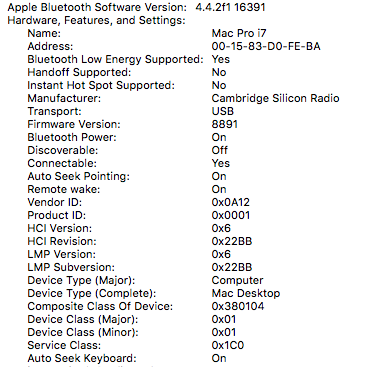

le0nardwashingt0n Posted November 3, 2015 Share Posted November 3, 2015 If the BT device needs firmware upload, make sure you have a valid firmware uploader for it installed. Rehabman, I did some research, found your post about bluetooth firmware upload, and it looks like my GMYLE USB Bluetooth is by CSR not Broadcom. It seems to work ok when it's in a USB 3.0 port, just acts a little funny on USB 2.0. Link to comment https://www.insanelymac.com/forum/topic/306777-guide-usb-fix-el-capitan-1011/page/23/#findComment-2184875 Share on other sites More sharing options...
RehabMan Posted November 3, 2015 Share Posted November 3, 2015 Rehabman, I did some research, found your post about bluetooth firmware upload, and it looks like my GMYLE USB Bluetooth is by CSR not Broadcom. It seems to work ok when it's in a USB 3.0 port, just acts a little funny on USB 2.0. I'm not familiar with that BT hardware (using Broadcom here), but not surprising given the USB drivers are all new... Link to comment https://www.insanelymac.com/forum/topic/306777-guide-usb-fix-el-capitan-1011/page/23/#findComment-2184882 Share on other sites More sharing options...
